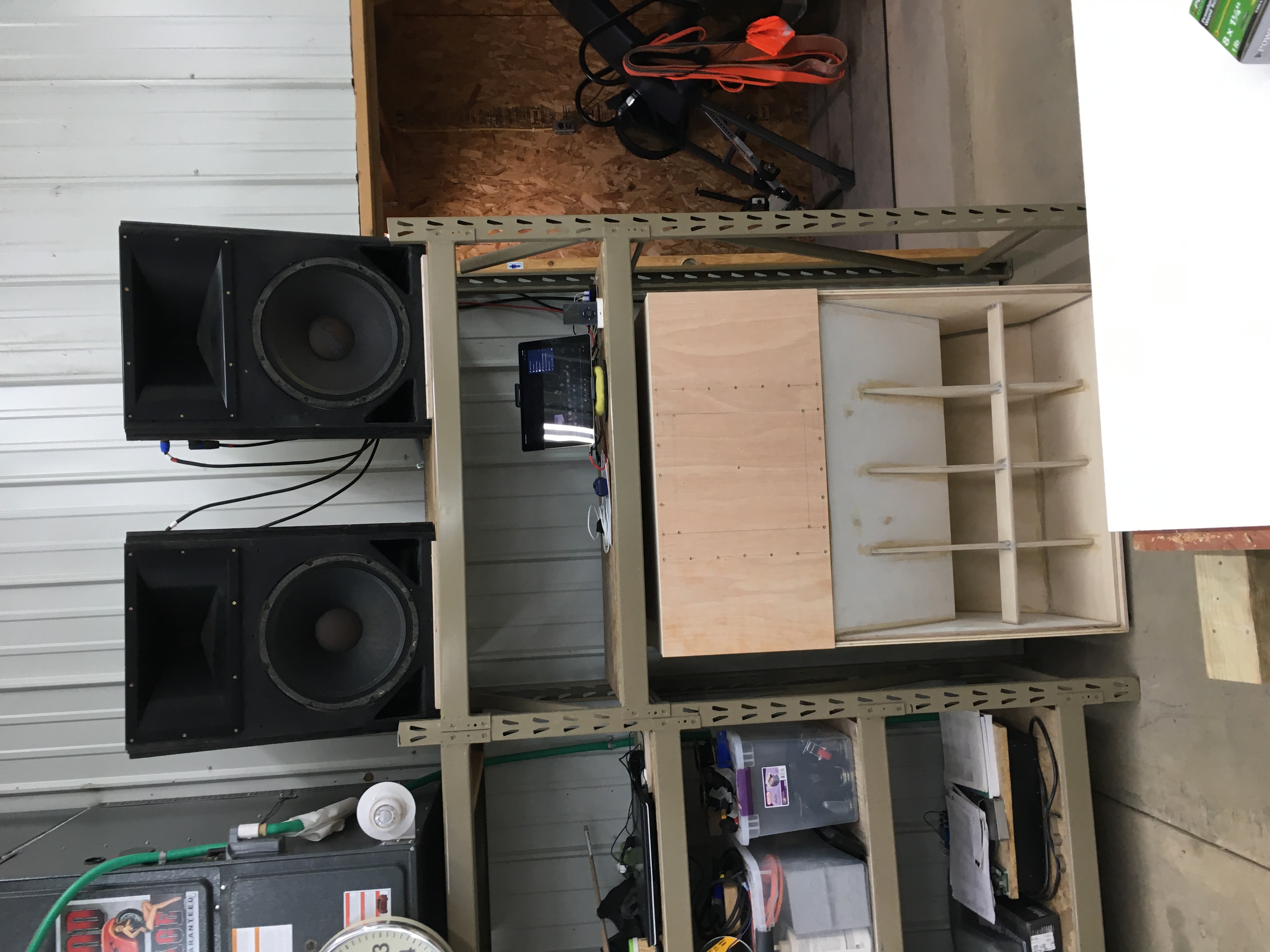

Question, anyone try the Nuetrix 90 degree kit on speakon ends? I did so the wire would hang without any pull on it, and they don’t lock like the straight fittings do and they breakup the connection with the speaker vibrating.
Or are there better ways to connect?

I haven't used those, but seeing the latch release I would think they must lock.

Because of the excellent strain relief and the fact that speaker cable is typically 12-14ga wire, there isn't enough strain on the connection from the weight of the cable to ever worry me at all.RYNO20 wrote: ↑Tue Feb 23, 2021 8:11 pm 05350ED4-6476-42F0-9C30-74E08FEC4625.pngQuestion, anyone try the Nuetrix 90 degree kit on speakon ends? I did so the wire would hang without any pull on it, and they don’t lock like the straight fittings do and they breakup the connection with the speaker vibrating.
Only speakon I've ever had fail was when someone who insisted on helping us tear down either yanked on the cable or stepped on the cable while it was attached to a monitor......can't blame the connector for stupid.....
Re: Ryno — new from Illinois on the Mississippi
These are definitely failing. They cam into place to make contact but won’t stay in contact, the locking tab is too loose. I’ve had all 5 apart and as a tool and die maker I understand how it works and was curious to hear if anyone else had this happen. I wonder if these were seconds or bad copies.Bruce Weldy wrote: ↑Wed Feb 24, 2021 8:20 amBecause of the excellent strain relief and the fact that speaker cable is typically 12-14ga wire, there isn't enough strain on the connection from the weight of the cable to ever worry me at all.RYNO20 wrote: ↑Tue Feb 23, 2021 8:11 pm 05350ED4-6476-42F0-9C30-74E08FEC4625.pngQuestion, anyone try the Nuetrix 90 degree kit on speakon ends? I did so the wire would hang without any pull on it, and they don’t lock like the straight fittings do and they breakup the connection with the speaker vibrating.
Only speakon I've ever had fail was when someone who insisted on helping us tear down either yanked on the cable or stepped on the cable while it was attached to a monitor......can't blame the connector for stupid.....![]()
I use 12ga twisted on all my cables in the cabs for the high power stuff but 14 ga works great too , we are only using less than 100 volts.
I should mention the wires are not loose just at the contact area of the connector, the male to female part.

The gray colored spring loaded Neutrik ones that are straight I’ve had no problem with. Yes clocking them is what I did to clear items and it shouldn’t mater where they hang but they won’t keep in contact if hung out of position.jemo1234567890 wrote: ↑Wed Feb 24, 2021 2:55 am Hello Ryno,

The straight plugs won't lock if out of position either, but being straight you don't have a frame of reference as to what out of position is. Try the angled plug with an unmounted socket to see how they're supposed to align.
I did , and gravity in the correct direction keeps them in contact, otherwise no it wiggles with the vibration of the cab.Bill Fitzmaurice wrote: ↑Wed Feb 24, 2021 10:38 am The straight plugs won't lock if out of position either, but being straight you don't have a frame of reference as to what out of position is. Try the angled plug with an unmounted socket to see how they're supposed to align.
I will continue using just straight ones because they don’t wiggle.
They lock but not tightly like the straight onesBill Fitzmaurice wrote: ↑Tue Feb 23, 2021 10:07 pm I haven't used those, but seeing the latch release I would think they must lock.
