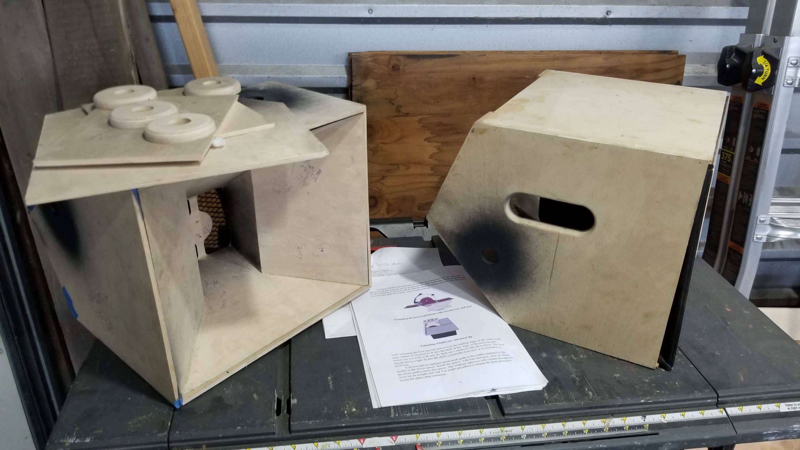

Pulled out my printed instructions and found where I am... trimming the horns to fit into the shell. I did trim one of them prior, so just have to do the other then on to the next step. I figured I may as well go ahead and do it, so I cleared off the table saw and was about to put the toothed blade back in it (it's got the abrasive blade that I use to cut piezo's in it at the moment). But, I was fighting mosquito's off like Braveheart. Decided I'd better do it during daylight hours. So, I created another tomorrow I'll have to capture and put where it belongs :mrgreen:
I did pull the cabs out to take a pic as proof it occurred, and because I said I would. Cab on the left has the horn trimmed and slides into the shell. Cab on the right needs the horn trimmed, if you look closely, you can see that it's too tall and doesn't fit in the shell.
