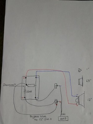

Sorry Grant no sound coming out of that woofer, I connected the cap Pos that I cut back to Pos wire out to woofer, bypassing the coil inductor completely to in Pos 3 way terminal.

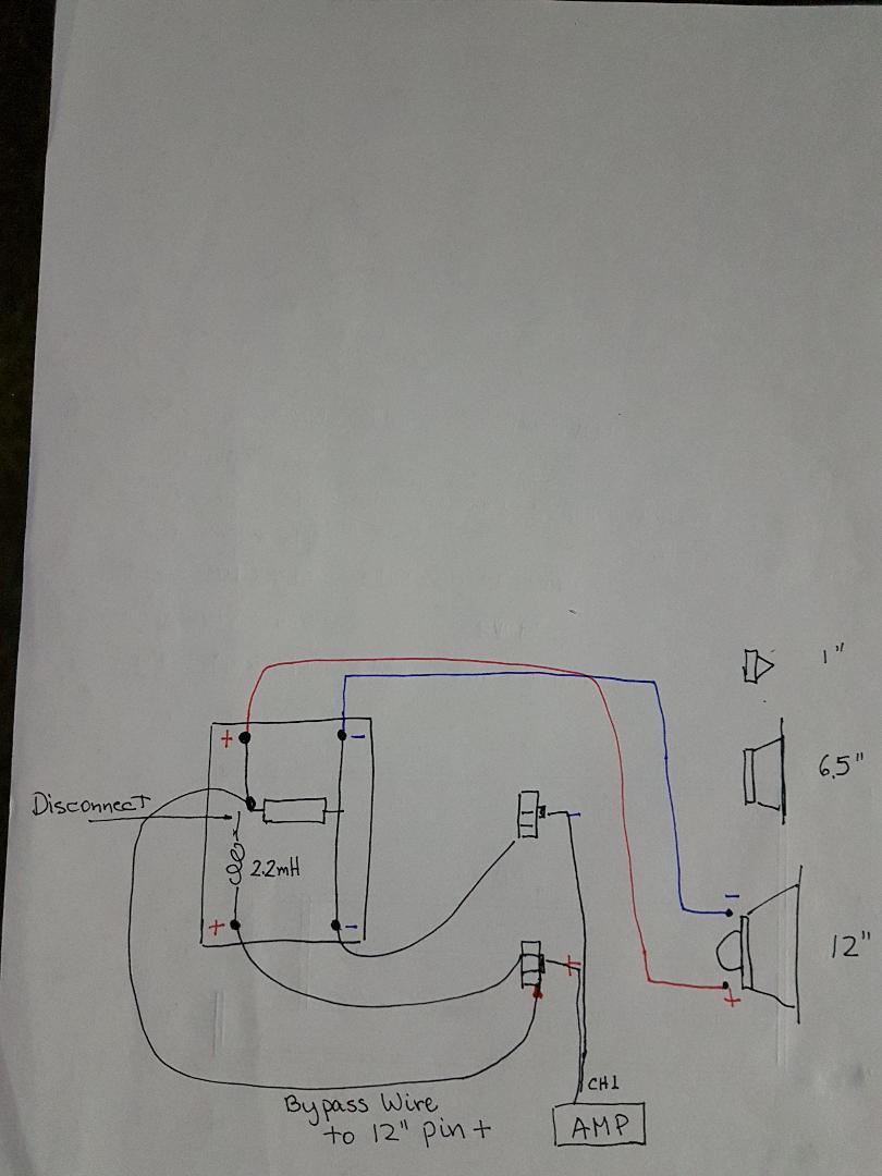

Yes Grant I did I cut the line from inductor to cap wire on positive side then I connect the cap wire back to positive temporarily. I then connect a 20" wire with cap out to positive line to positive pin 3 way terminal, thereby bypassing the whole inductor coil. Still no sound on 12". ThanksGrant Bunter wrote: ↑Tue Jun 02, 2020 1:58 pm Did you reconnect the cap before trying to bypass the inductor?

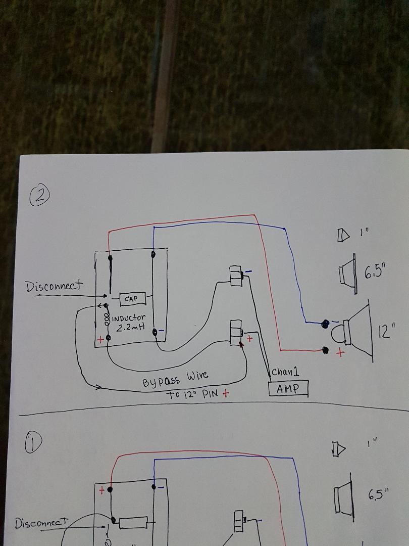

So you want me to leave the Neg input > Cap Side > Neg Out (Top) > woofer Neg as shown on the drawing above? Then with the spare 20" wire Pos tap out back to the 3 way 12" in pin Bass then power up the system and see if I get music out of the 12"? Wouldn't that short out the amp?

Don't do what you said above, other than leaving the negative side of the board as you've shown in "2".
Ok, lets try again.
Using the circuit marked number 2 in your drawing above.
Hook up the board from your 3 way connectors like it's working (but just for the woofer board for now).
Disconnect the cap as you have shown in diagram 2. Those gaps are good.
Get a new, short piece of wire, and bare both ends and take it directly from +in to + out on the woofer board.
Connect your amp.
Play something.
If the woofer works now,
Turn everything off for a moment, take the added wire away from + in, and now attach it to the end of the inductor in the middle of the board.
Still leave the cap out of the circuit. Power back on.
If the woofer still works when you've done that, you need a new capacitor...
Ok, lets try again.
Connect your amp.
Play something.
