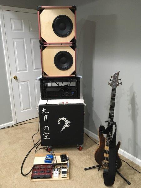

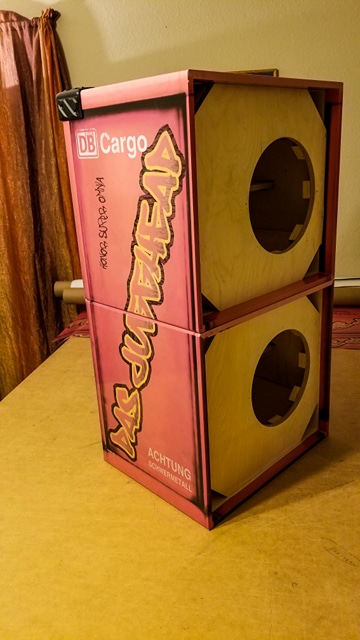

Well the cabinets are wrapped and I must say I think they look pretty good. Got hardware and speakers installed late last night and played for a bit before my very tolerant and destined for sainthood wife reminded me that sleep is a commodity. Initial impressions are that the sound is quite good but I fear one of the speakers may be damaged. Fortunately I have two other speakers that I can swap out with it to see it that helps. I will update after I do that. Other than that the sound is crystal clear and the Zoom B3n really springs to life.
Das Jugghead
Posts: 142
Location: Indianapolis
Re: Simplexx 110 Build
#101 Post by Das Jugghead »
Switched out the speaker with one of the others I had and problem solved. The speakers sat in my basement (finished basement) and were moved around periodically as we settled in to the new house. I guess I am not surprised it was damaged but I am grateful I had some back up speakers on hand. Monday is band rehearsal so we shall see how they keep up. presently I have them on top of an old road case to get them up to ear level.

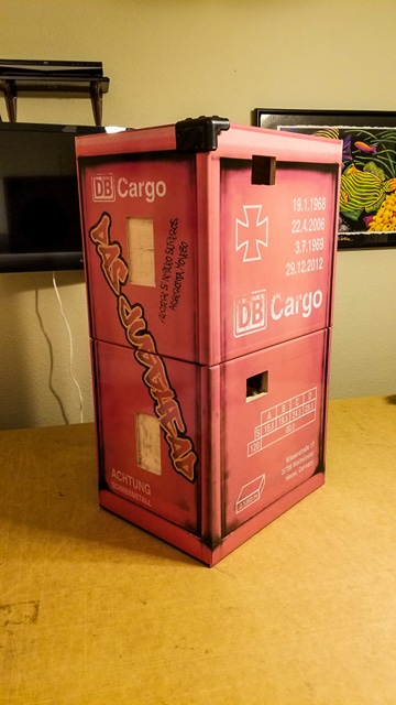

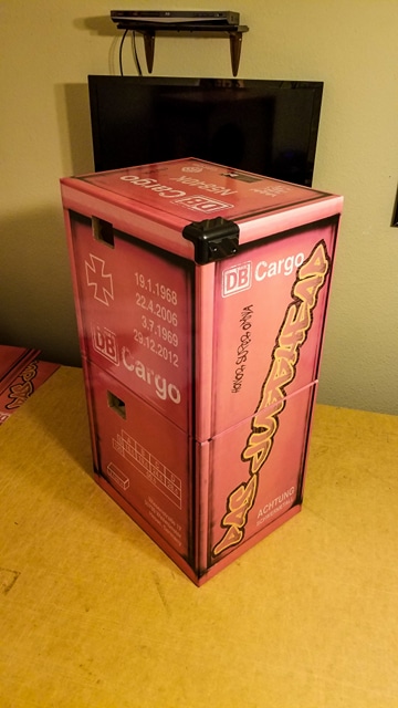

That's a pretty coo wrap! What is the significance behind the numbers?

Tom Smit wrote: Sat Feb 10, 2018 3:26 pm That's a pretty cool wrap! What is the significance behind the numbers?
Thank you very much. The overall background design is based on a German freight rail car so some of those numbers are just lifted from tare weights etc. . . The rest of the numbers are from my life, birthdays, deaths, anniversaries, and the like.
