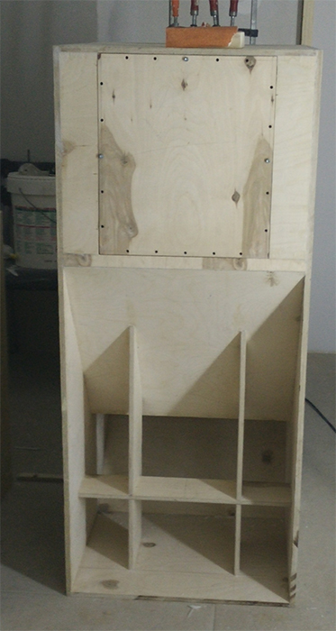

Hey everyone !
We've been working hard on our second titan and we will hopefully have it finished soon.
While we didn't take a lot of pics throughout the whole process, we went with pre-drilling everything and using screws instead of clamps this time and the results are 100x better.
We have no noticeable lip this time around, everything fit pretty much perfectly, and as many of you suggested we doubled the bracing both inside and on the front of the cab.
Having little to no woodworking skills I can't say how pleased I am with the result so far.
I took a few pics yesterday that I'd like to share with you.
We basically have everything but the second side panel glued.
Hopefully today or tomorrow I'll finish it
Cheers, and again thanks for all the help.
