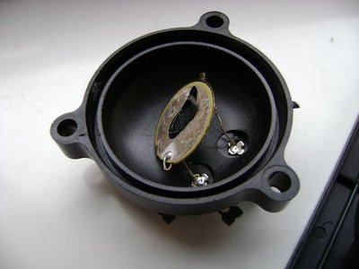

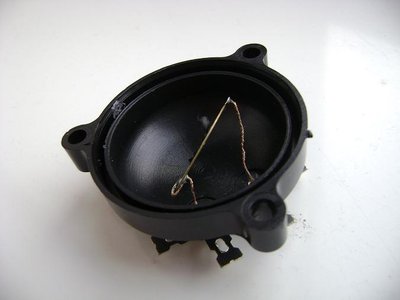

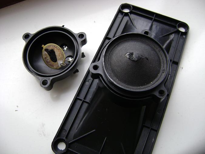

Ok, great info., thank you. I thought I had better check out the piezos I bought to find out what type of cutting and assembly patterning I will need to do. I checked 4 out of the 40 that I have bought. All 4 had backs/caps that felt like they were glued on a portion of their perimeter. The backs came off with a little effort. I pulled the first two caps off and nothing they were connected to, via the wires, would move. I pulled the 3rd and there was a paper like tearing sound, so I stopped. On the 4th one, one of the soldered wires onto the piezo disc was soldered short, in length, so in pulling the back off, it ripped the piezo disc off the paper cone. Hey ho. So, how to move forward...
Am thinking: frequency sweep them individually to check function, cut/make up 32 that are good into the arrays, without turning the elements as per Antons method, so that means cutting through screws on the table saw, but it also means a higher blade setting. I think I'd rather cut with the blade lower, alternate the piezos and zigzag the wires on the back when soldering up....? Also, get some more piezos which will hopefully not be glued, for fixing broken elements in future.
I found the construction of the piezo elements to be interesting. The piezo disc vibrates the paper cone by simply being glued to it, i.e. the disc is not 'grounded' to anything. I've included the piccies of the one I broke - haven't properly looked at the wiring in an unbroken one to see if this one with odd soldering (i.e. the short wire is soldered on both sides of the disc) would actually work. ....Also, not the phone camera this time, better pics done on macro.

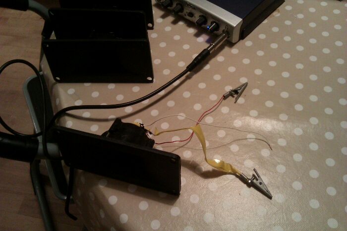

A bit of an odd one tonight. I tried phase testing my piezos with the arrangement in the picture, using white noise. Overall, after doing about 9, I think I found that having to swap the wires caused confusion in the comparative sound level. It was very hard to distinguish which way round was louder. I was also convinced it was blowing windy outside, and when I tried a 2kHz sine wave and moved my head around, well, it was like sonic psychedelia. I think I'm gonna call it a day for 'phase testing' (according to a spanner wielding monkey: read mechanical engineer). The only real way to do it is the proper A/B switch arrangement (electrical engineer, I'll have you know) test set up so the comparative noise level increase or decrease is easier to discern at the flick of a switch. I have a feeling i might run out of steam sweep testing aswell (my ears run out after 14k, and around 9k is ear splitting) or is that more critical than phase testing....?

For inspiration: here's my pizzer test jig.
http://billfitzmaurice.info/forum/viewt ... 51#p139151
Allowed me to alternate between in phase and out of phase by flipping the switch.
No need to go loud. I had it hooked up to the earphone output of an old transistor radio playing softly while tuned between FM stations. Worked for me. I didn't do sweeps. Mine were Monacor tweets.

Hi Anton, I remembered your tester from some time ago when I was looking at this whole thing, and was inspired. I am ok with the mechanical bits and soldering, but struggle with understanding switches/switching to swap the wiring round on the slave piezo. Can I use my 3-way miniature dpdt switches I got for the half-on/full-on/off switching of the piezo arrays and do you have a sketch of how it is wired in this tester, to the terminals of the required switches? Sorry for such a lame question.
2xT30
Posts: 2704
Re: 2 x Jack 112 Lite
#103 Post by AntonZ »
No worries Charles, it is a valid question indeed. You would need a DPDT for the phase switching. I have no time today or tomorrow, will see if I can draw something up later in the week. If someone else can do it and has time before then, please go ahead.
