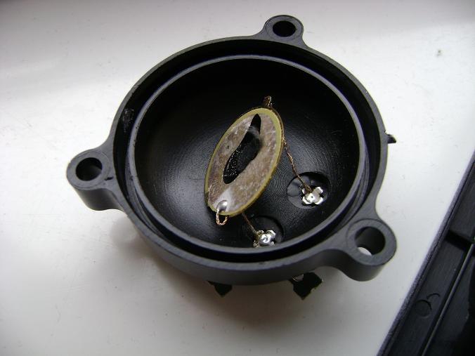

Ok, great info., thank you. I thought I had better check out the piezos I bought to find out what type of cutting and assembly patterning I will need to do. I checked 4 out of the 40 that I have bought. All 4 had backs/caps that felt like they were glued on a portion of their perimeter. The backs came off with a little effort. I pulled the first two caps off and nothing they were connected to, via the wires, would move. I pulled the 3rd and there was a paper like tearing sound, so I stopped. On the 4th one, one of the soldered wires onto the piezo disc was soldered short, in length, so in pulling the back off, it ripped the piezo disc off the paper cone. Hey ho. So, how to move forward...

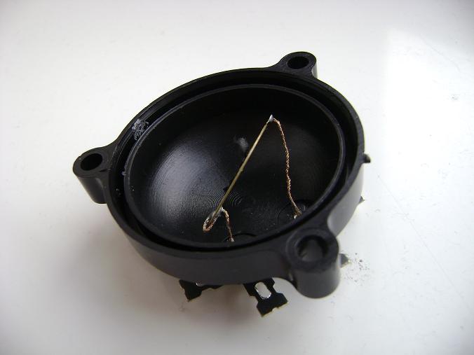

I found the construction of the piezo elements to be interesting. The piezo disc vibrates the paper cone by simply being glued to it, i.e. the disc is not 'grounded' to anything. I've included the piccies of the one I broke - haven't properly looked at the wiring in an unbroken one to see if this one with odd soldering (i.e. the short wire is soldered on both sides of the disc) would actually work. ....Also, not the phone camera this time, better pics done on macro.

P.S. I've just checked the other piezo's and they all have one wire, internally, that is soldered to both sides of the disc, on the '+ve' wire. The 'short wire' on the one i broke is because these same wires are fed through the +/- lugs and soldered on the outside of the lug, i.e. that wire was just pulled through more than any others I'd looked at.
