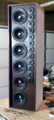

Well, I got to hear the David before and after finishing our new PA Sized SLA and with extra power and taking off some of the bass Steve had cranked in that tweeter is starting to hold its own but the SLA just adds some final finesse and detail the David just does not get. However THIS IS VERY MINOR and unless you have heard an SLA you might not understand whatwe are tlaking about. The David with corner loading is OUTFREAKING STANDING!!!! WOW O WOW!!!!
That thing CRUSHES!!! Heck the one sub kept up fairly well with the top of the David and the SLA 612 I finished today. This one!!!
The tweet array of these things are very delicate musically but will snap your head off in the blink of an eye!

With the David and the SLA 612 going at 150W they were hitting 112 dB at 3 Meters. Ouch!!
With the sound front being so big measured volume of the SLA was less than the David but seemed even while listening.

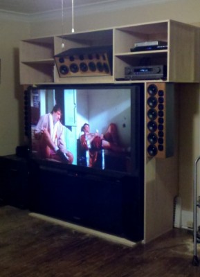

I have David #2 in build. However, they will be incorporated into my home theatre so....... I am in the process of remodeling my livingroom. My 64" projection DLP system went to Ewetho. We constructed a built-in center for him so he can use his SLA's with it. Then I purchased a really good plasma unit to go on the wall. Now I'll touching up the equipment rack to hold the electronics. Then I will finish David #2 and install.

Here is the offending David/PLA 612s/etc etc etc show stopper!!!
One built in for a 64" DLP rear projection TV and 3 SLAs and Stuff.
Finish work to Come. Only holdup is we went with a Tuba 24" for now on the sub as the T36 would not fit and due to the line level difference that the old Ashly want versus my Sherwood it also need a Power DI (no problem will have shortly).
