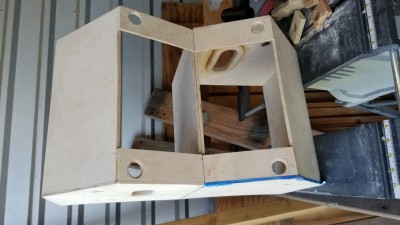

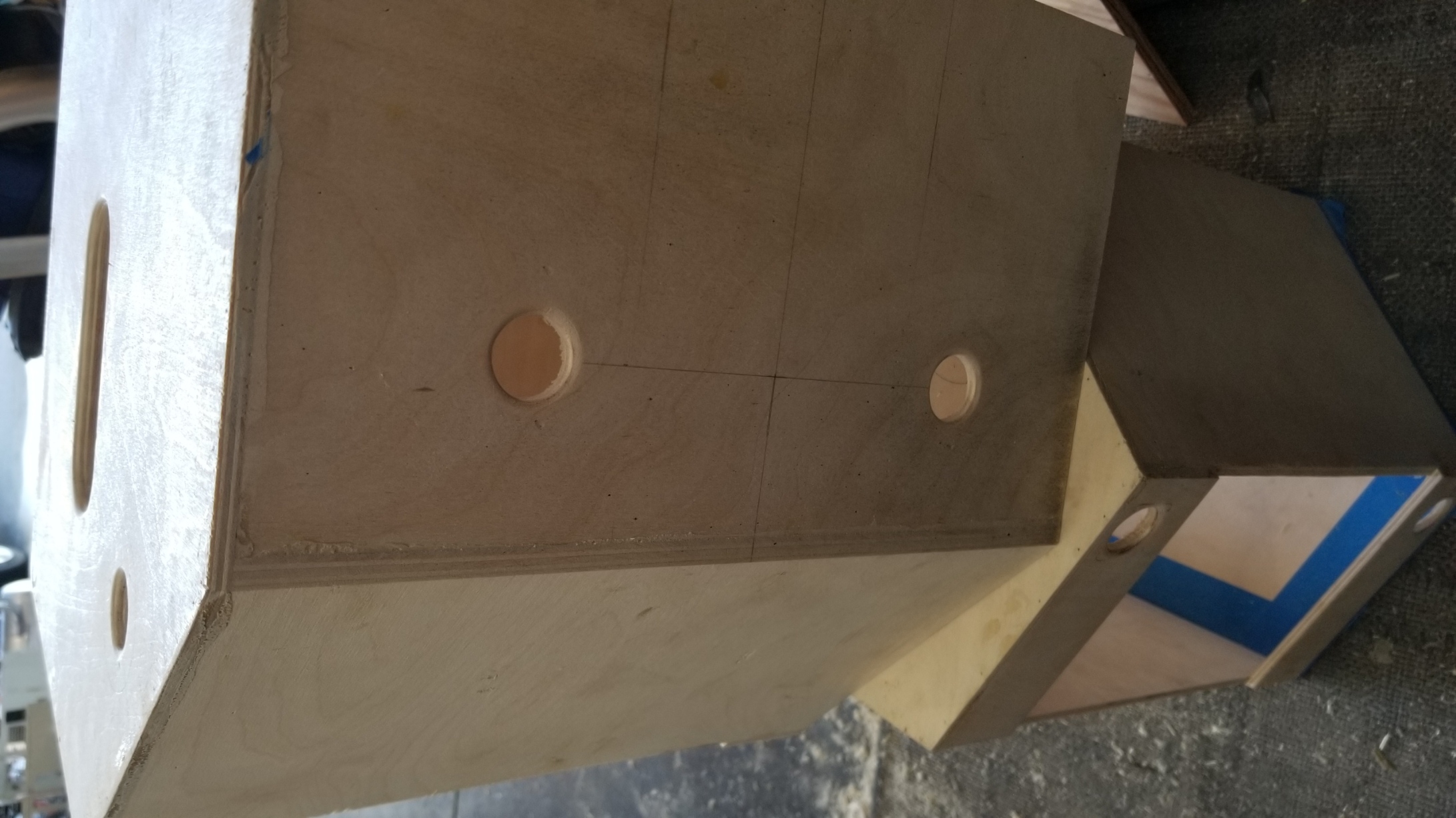

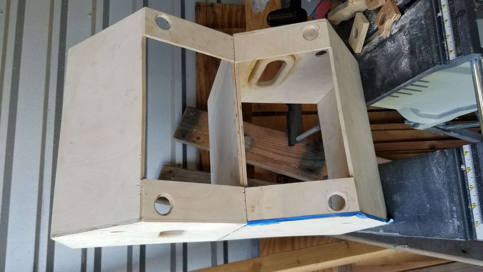

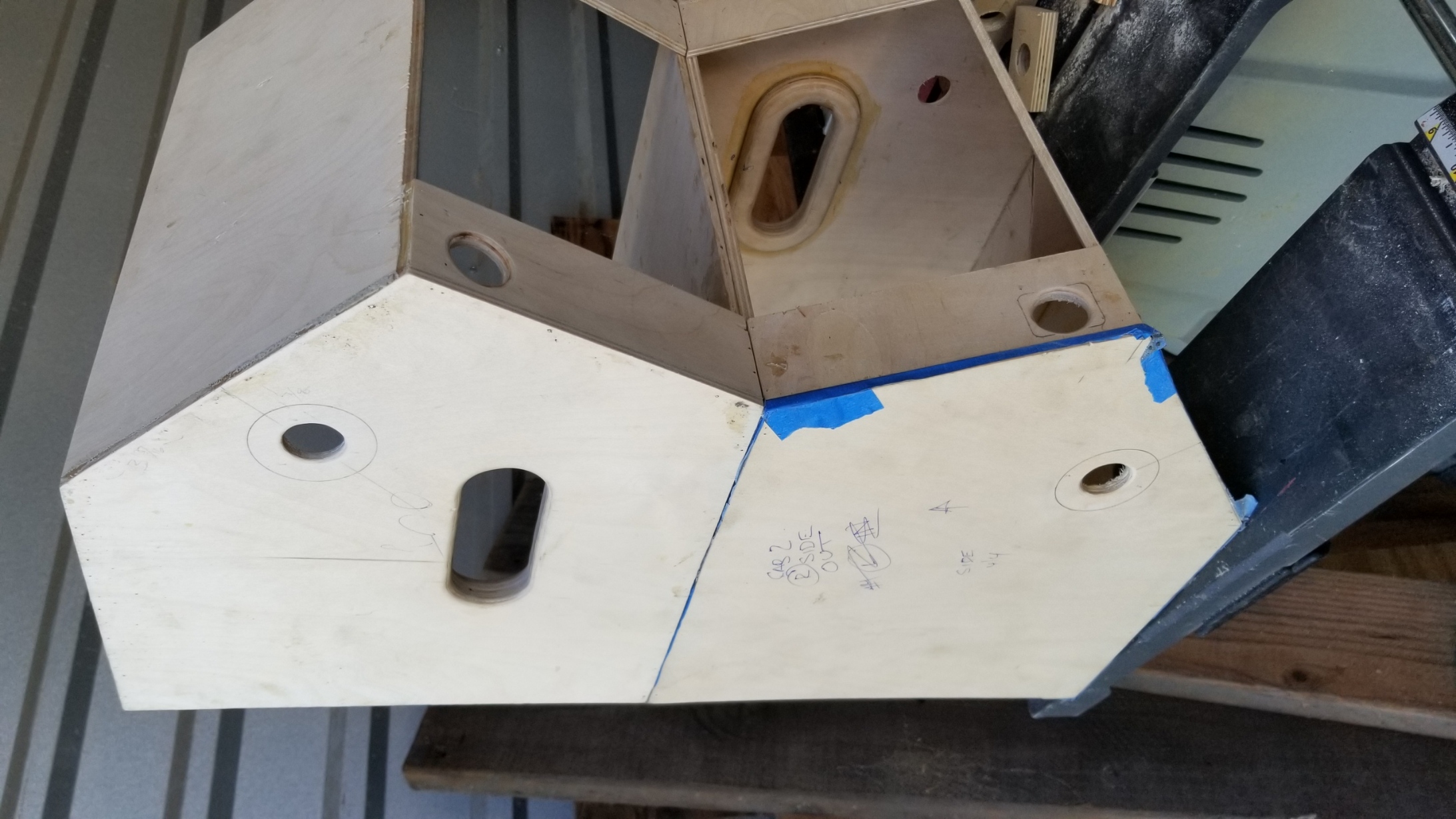

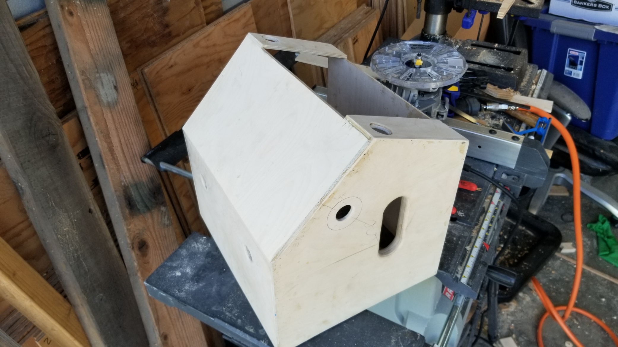

Earlier in the week, I went to the shop space determined to get all the SpeakOn backing plates made and recesses routed out of each location. I made a little jig for the drill press, cut a strip of ply the desired backer height, and set the table saw up to cut the desired width. It all went like clockwork, nice little production line. Drill one end of the strip, flip it around and drill the other end, cut one end off, cut the other end off... wash, rinse, repeat. Had a handful of nearly identical SpeakOn backing plates in a matter of a few minutes.
I sat down to take a load off and contemplate a nifty strategy for routing out all the rectangle holes in the outer shell. Just fiddling, thinking, and brainstorming... I stuck one of the jacks in the hole from behind to get an idea of the footprint from behind. Then took a look at it from the outside. It looks really clean with just a circle and the jack rear mounted... just like Bill says to do in the plans. So, that's the route I'm going to take.
So, I put a 1/8" roundover bit in the router, softened up all the exterior holes , and gave them a little sanding. I used the backing plates I made and tacked them in place behind each hole to thicken the ply and give the router bit bearing a surface to ride on. So they came in handy after all.
After a little deliberation, I think I'm going to also take the route Bill has already mentioned in the plans, and just glue them in place. If I have an issue with them getting knocked loose, I'll deal with it at that time. Otherwise, I'm just taking time, energy, and resources fixing a problem that doesn't exist.
Was going to go ahead and glue them all in, but decided it would be best to wait until they're finished and painted before permanently gluing them in.
So, here's where they're at. Next step, glue them in their outer shells. Note the location I chose for the jacks on the backs to allow clean and easy jumping from one cab to the other if/when stacked.

Wow, that's a lot of holes in those shells and it sounds like you are really thinking things through. It does however get me a bit confused. Just how many speakon connections are you installing in each cab? Looks like four or even six per cab, although perhaps some of the holes are for top hats. Also, the location of two connectors on the back plate means you will not be able to use these connectors when the wedge is resting on that side. It is my experience (owning a pair of WH8) that one speakon on each side (left and right) are optimal, both in allowing to connect regardless of positioning of the wedge, as well as the easiest and most efficient for daisy chaining.
Not questioning your approach mind you, just being curious and nosy here :noob:

AntonZ wrote: Fri Jan 15, 2021 8:32 am Wow, that's a lot of holes in those shells and it sounds like you are really thinking things through. It does however get me a bit confused. Just how many speakon connections are you installing in each cab? Looks like four or even six per cab, although perhaps some of the holes are for top hats. Also, the location of two connectors on the back plate means you will not be able to use these connectors when the wedge is resting on that side. It is my experience (owning a pair of WH8) that one speakon on each side (left and right) are optimal, both in allowing to connect regardless of positioning of the wedge, as well as the easiest and most efficient for daisy chaining.

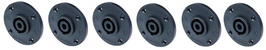

It IS a lot of SpeakOn connections. If I didn't go down the mental path of wanting these to do double duty as monitor and small PA, one on each side would have been all I'd do. I added 2 on the bottom for a clean in and out when on a pole and 2 in the back for clean and handy interconnections when stacked. I could have just added one on the back, but chose two just because... why not?
So, yeah... 6 jacks per cab.

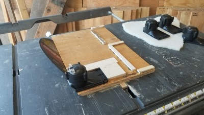

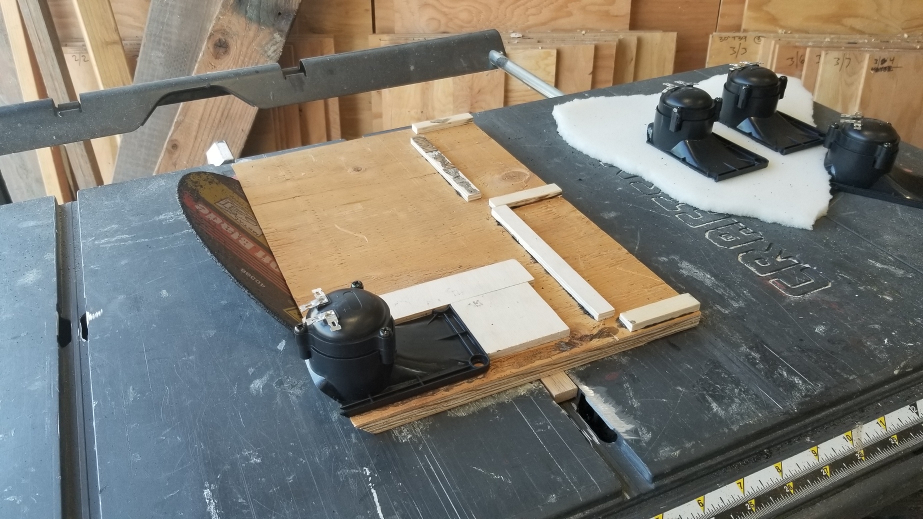

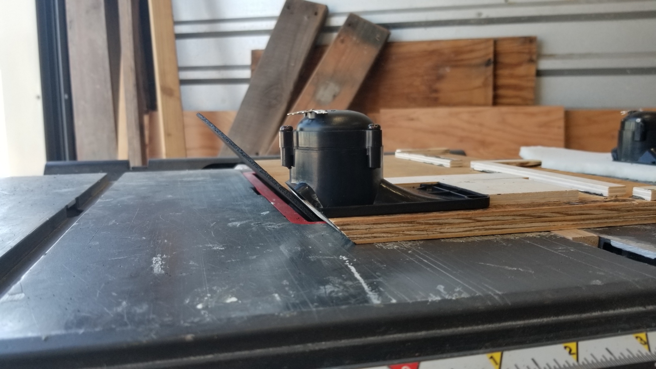

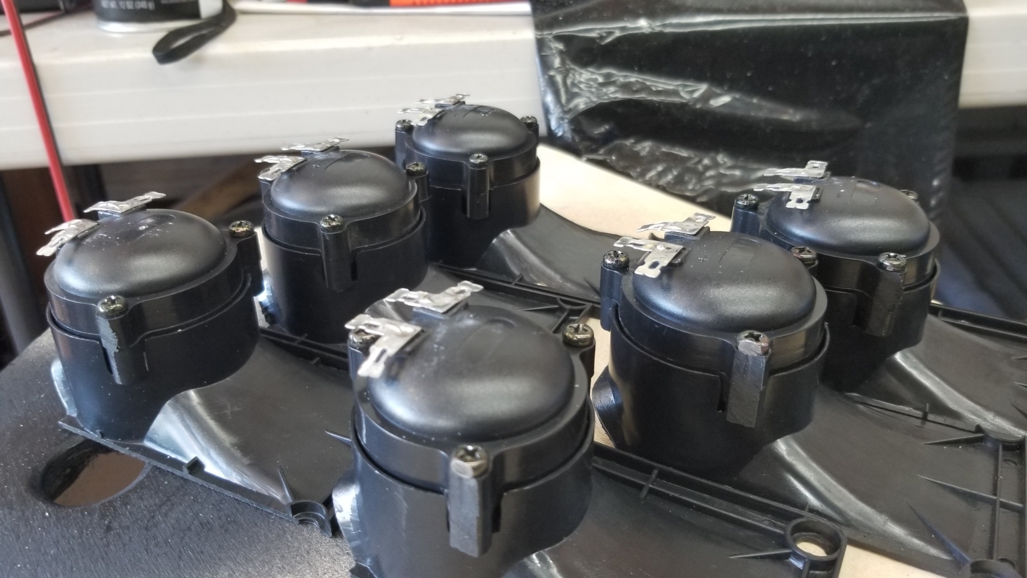

Alright alright, it's been too long. I finally put together a sled/jig for the melded tweeter array's. I just used CA glue to mount all the pieces. I've had to make a few adjustments along the way to get it cutting as intended. It was easy enough to pry the stops up with a screwdriver to break the CA bond and just glue it back down again.
One side is the straight cuts. Flip the sled around 180º and adjust the blade angle to do the 45º cuts. Seems fairly repeatable.

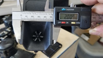

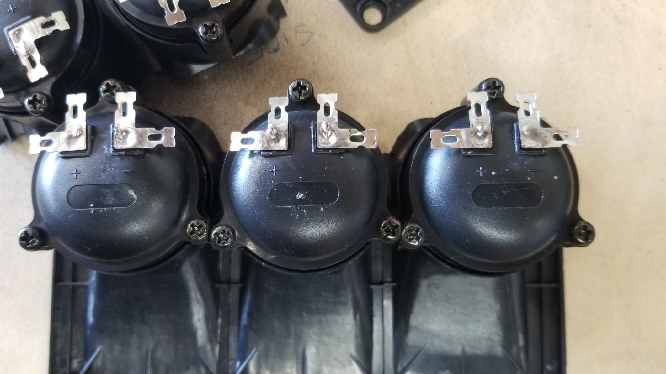

Something that I hadn't heard any of you other guys talk about is the clocking on the barrels not being aligned straight up. Maybe it's not a universal thing. I was giving my head a pretty good scratching, wondering why more material was removed from one side's screw boss than the other when the spacing of the cuts looked pretty good on the mouth side. On mine anyway, the center barrel is clocked slightly counter clockwise, which meant the screw on one side would get a trim, but not so much on the other side.
See the clocking?
Some screws got a trim, some didn't.
Side to side spacing isn't 100% perfect, but the tolerances of the horns aren't completely uniform either. I'm fairly happy with how well the jig is set up now. Double trimmed units are coming out fairly regularly at 0.010" over the specified size. Good enough for me.
Side note: I tried the first couple with the regular saw blade. But, every time the blade touched a screw, it grabbed and ejected it rather than cut it. Switching over to the abrasive blade solved that issue and maintained the jig stops cut dimensions that were made with the other blade.
Toying around a little bit with different glues to see which I like, or which combination and method I like the best before I start gluing these up.
