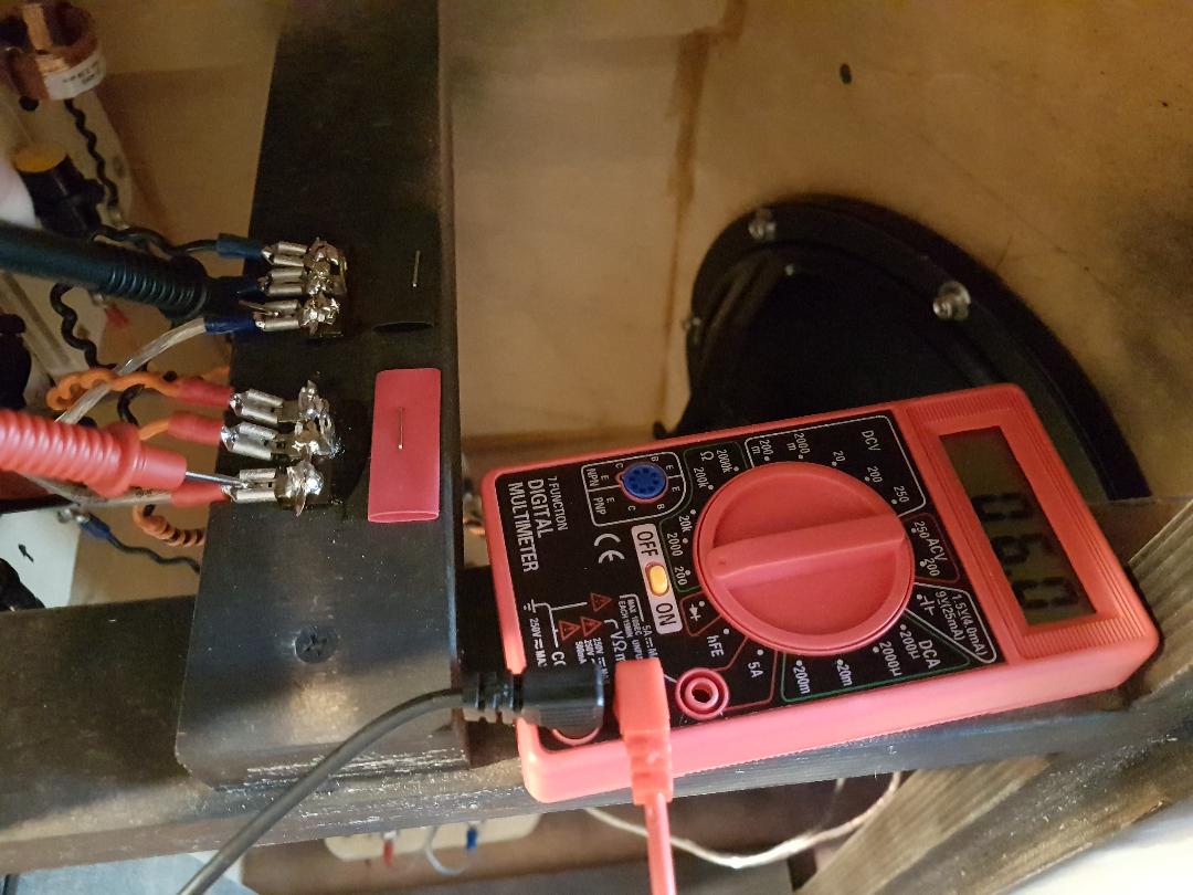

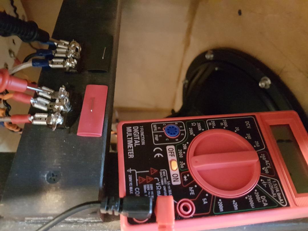

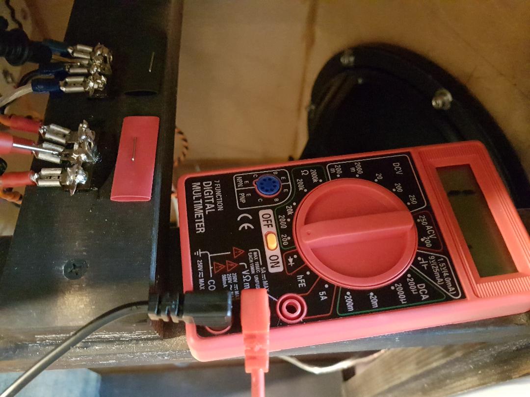

Ok I have not closed the cabinet or has gone far as connecting to my speakon, this is how it looks with the back cover off. So with the pictures below this is how I tested Bass, Mid, Highs. I pointed the probes to the appropriate 3 pins. Theres a reading on the Bass but no reading on the mid and highs. But when I connected the speaker wire +/- to each terminal block only mid and highs no Bass. But if I connect the speaker wire to +/- to the Bass pins theres sound coming out of the 12" only. Thanks

Yes Grant as shown on the 1st pic above bass pins which is first red and first blue terminal theres a reading, (+/-).
Also I just checked the 12" woofer positive and negative terminal, there is a reading.

I put the black probe on the Blue pin 1 which is 12" then red probe on the - woofer terminal Yes there is a reading.

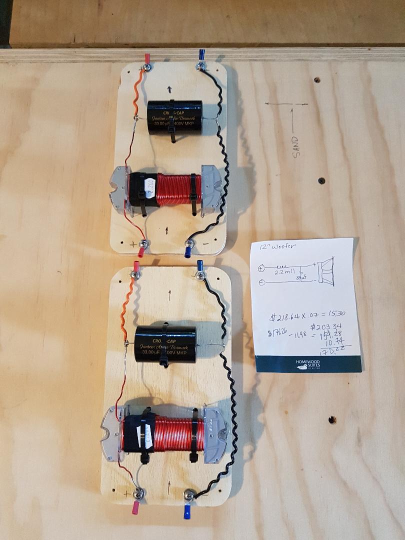

Which one of these two boards is it?

If the woofer doesn't work there are only two possible reasons why, other than a broken wire. The inductor isn't passing signal and/or the capacitor is blown and is shorting all the signal to ground. Process of elimination will reveal which is the case.

On top is the board in that problem speaker cab. Thanks Grant
I don't know what else to eliminate Bill, or have I not done a complete check? All wires seem to have a reading on the meter as shown as I set up the meter in that position to read as you see on the pics above.

I don't know if its the 3 way terminal DIY that I glued to accept the signal from Neutrik to each individual crossover board. The 12" does work with sound if I directly touch it with the bare wire from amp to first red and blue pin with is the red and black of the xover bass board. Im stumped

The top board in the picture is the problem board? If so, check from the red input -to the solder joint at the cap. Is it good? If not, the problem may be a bad connection from the inductor at the red input terminal.
If that is okay, then test from the cap solder joint, to the red output. There may be a bad connection at the red output.
Re: Before I soldered my DIY Cover for my Omni 12TB
+1Tom Smit wrote: ↑Sat May 30, 2020 1:03 pm The top board in the picture is the problem board? If so, check from the red input -to the solder joint at the cap. Is it good? If not, the problem may be a bad connection from the inductor at the red input terminal.
Did you strip the red lacquer off the inductor end underneath the red “in” side?
