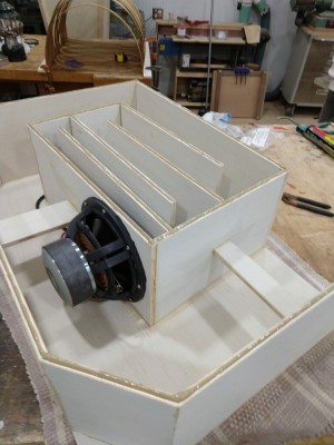

This is what I got so far. It’s just shy of 2’x3’ and with 9.5” internal height- just enough to accommodate the driver,
SB Acoustics SB23MFCL45-4. This is bigger than an 8. It’s a 4ohm rated for 150 watts RMS. Not sure where it will end up- kei van or living room. Note that this is the “tarted” version of the T-6. About to put the roof on. :noob:

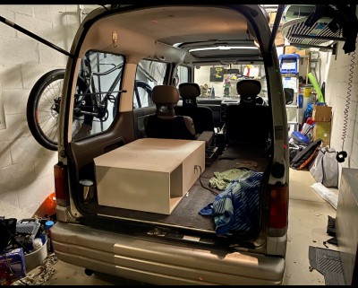

Success. Much more linear than expected. Louder too so amp gain needs to come down.This amp has 32hz cutoff. Model shows a bump at 30hz, before it drops off like brick wall.
But I was going to swap the with the ACM 1.300, which will reduce power to 150 RMS @ 4 ohms, lower the cutoff filter to 24hz and allow a bass knob.
Or not. Maybe just put the in living room and use TAT.
This thing is taller but about same footprint.

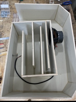

The second photo shows the peculiar geometry of the tapped horn. No rear chamber. The literature says
it is a variant of the quarter wave resonator family.
