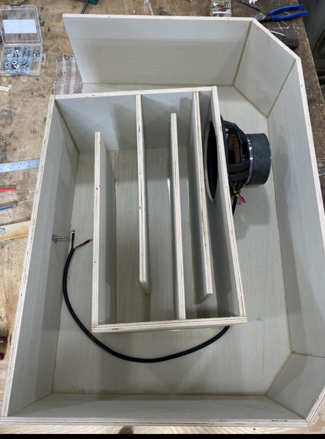

This is what I got so far. It’s just shy of 2’x3’ and with 9.5” internal height- just enough to accommodate the driver,Seth wrote: ↑Fri Dec 04, 2020 9:54 pmAnother awesome little tidbit. Thanks BillBill Fitzmaurice wrote: ↑Fri Dec 04, 2020 5:08 pmIt doesn't. A tapped horn has no rear chamber. They're considerably more difficult to design than other horns, because of the phase relationships between the front and rear waves. Most of those that I've seen aren't very good. Danley's are very good, but they're the exception. BTW, Danley didn't make the first tapped horn, although he did coin the name. I've seen prior art in patents going back to 1958.SethRocksYou wrote: ↑Fri Dec 04, 2020 12:27 pm I don't know if having the driver in the mouth magically makes it a tapped horn or not![]()
SB Acoustics SB23MFCL45-4. This is bigger than an 8. It’s a 4ohm rated for 150 watts RMS. Not sure where it will end up- kei van or living room. Note that this is the “tarted” version of the T-6. About to put the roof on.

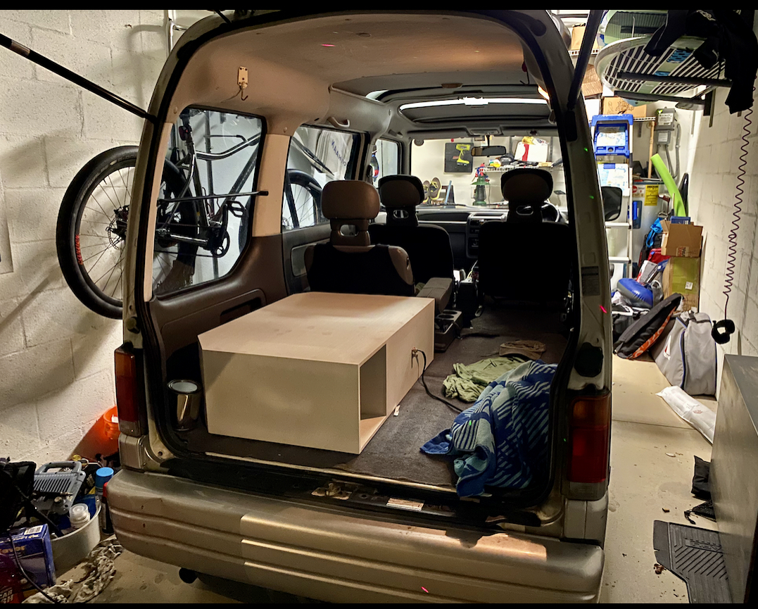

Success. Much more linear than expected. Louder too so amp gain needs to come down.This amp has 32hz cutoff. Model shows a bump at 30hz, before it drops off like brick wall.
But I was going to swap the with the ACM 1.300, which will reduce power to 150 RMS @ 4 ohms, lower the cutoff filter to 24hz and allow a bass knob.
Or not. Maybe just put the in living room and use TAT.
This thing is taller but about same footprint.
The second photo shows the peculiar geometry of the tapped horn. No rear chamber. The literature says
it is a variant of the quarter wave resonator family.
