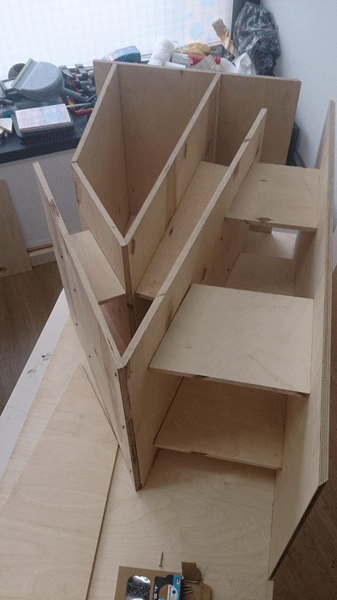

Back again for more cabinet building :)
After stopping for a few months we're finally back in the workshop.
We decided to use what we've learned on the first build to try and address all issues we had with the build.
We are of course doubling the bracing, and more important we're pre-drilling everything and dryfitting with screws beforehand. (Many thanks to sine 143 for all the help provided and patience to answer all the questions I've nagged you on facebook).
We basically marked side panel, and then marked screw holes spaced 10cm apart.
Afterwards clamped 2 side panels together and drilled them both.
Afterwards I've dry fitted every panel to make sure they all align correctly.
After that I've secured the braces as well on position.
I didn't take a lot of pictures throughout the whole process but here's one of where I left off.
Overall looking much cleaner this build.
