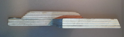

One solution: make the restrictor
plate into a restrictor
paddle,and end up with something that looks like this, in plan view:
side view:
front view:

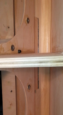

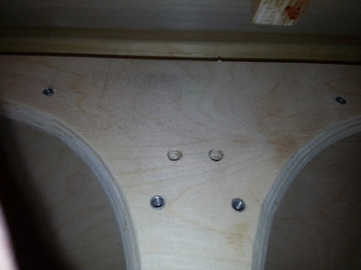

As we see, the restrictor paddle is designed to mount to the baffle board using bolts, with hurricane nuts glued into the paddle itself. This design makes for (relatively) easy removal and reinstallation during testing, and is more robust than plain wood screws would be. In this case the bolts and hurricane nuts are 10-32.
So we need a couple of holes in the baffle board:
And to prevent unwanted buzzing noise caused by vibration of the paddle against the baffle board and/or the back of the cabinet, we need some durable foam (Akasa computer sound-deadening foam here) to go between paddle and back, and some rubber tape to go under the paddle, between the paddle and the baffle board (not shown, but it's 3M real rubber electrical tape).

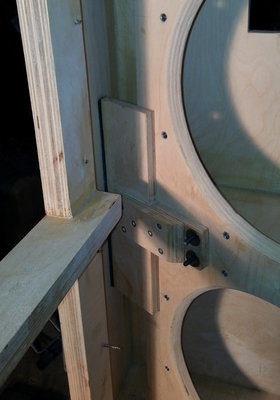

Here's the paddle ready to go into the cabinet:
