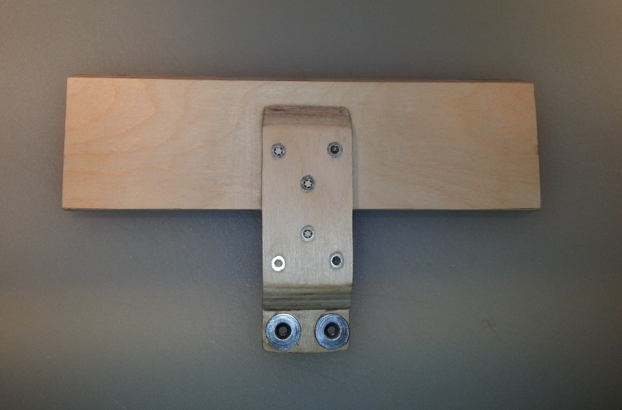

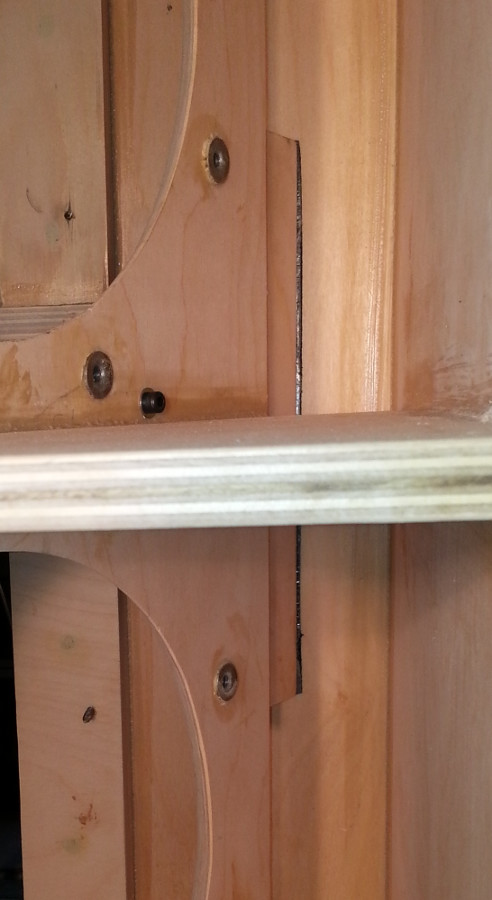

One of the optional features of the Omni 15 TallBoy design is a baffle restrictor plate that tunes the cabinet to give more emphasis to low frequencies, at the expense of overall sensitivity. Since these cabs will be used for PA and reproduction of recorded music, and I like strong bass, I want to at least try the cabs with this plate in place.
This plate blocks about a third of the port area. The port is the opening between the baffle board, that stops short of the rear of the cab, and the fixed portion of the back of the cabinet.
Problem: how can the speaker builder install this plate once the cabinet is mostly complete, without a right-angle drill and screwdriver? There isn't room to use the tools I have on hand. There isn't money to buy a right-angled driver-drill.

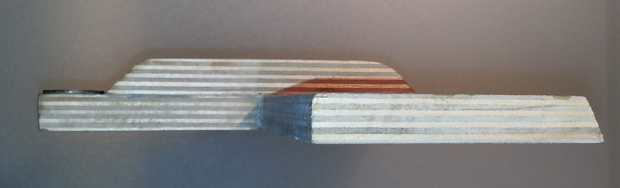

One solution: make the restrictor plate into a restrictor paddle,and end up with something that looks like this, in plan view:
side view:
front view:
As we see, the restrictor paddle is designed to mount to the baffle board using bolts, with hurricane nuts glued into the paddle itself. This design makes for (relatively) easy removal and reinstallation during testing, and is more robust than plain wood screws would be. In this case the bolts and hurricane nuts are 10-32.
So we need a couple of holes in the baffle board:

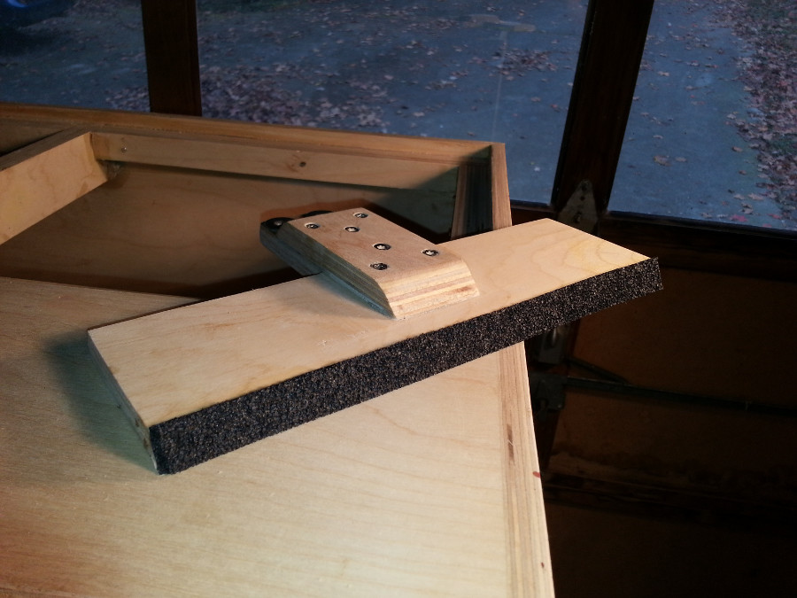

And to prevent unwanted buzzing noise caused by vibration of the paddle against the baffle board and/or the back of the cabinet, we need some durable foam (Akasa computer sound-deadening foam here) to go between paddle and back, and some rubber tape to go under the paddle, between the paddle and the baffle board (not shown, but it's 3M real rubber electrical tape).
Here's the paddle ready to go into the cabinet:
Conclusion in next post.

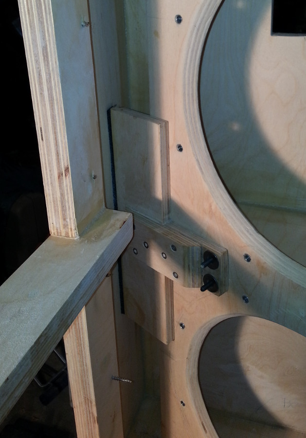

Conclusion to the restrictor paddle solution:
Here's what the installed restrictor paddle looks like from the front of the cabinet:
The big board in the foreground is the edge of the lower baffle board brace. You can see one of the paddle mounting bolts at left center, next to a speaker-mount hurricane nut. The other paddle mounting bolt is under the lower baffle board brace.
And here's what the installed restrictor paddle looks like through one of the handle holes in the side of the cab (this was a "dry fit" without the rubber tape between the paddle and the baffle board):
Trust me, I have trial-fit the drivers with all 8 bolts in both cases, and they fit! They fit! Easy in, easy out. I like it :D . I have cut that screw off, that shows in lower left center of the photograph. Those screws must have bitten me 20 times at least.

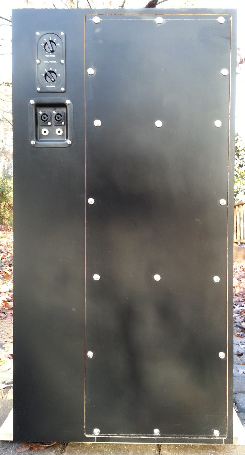

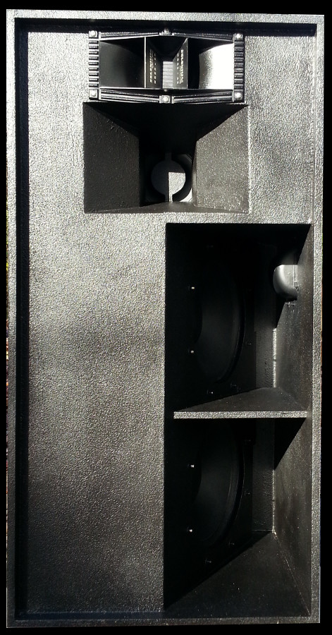

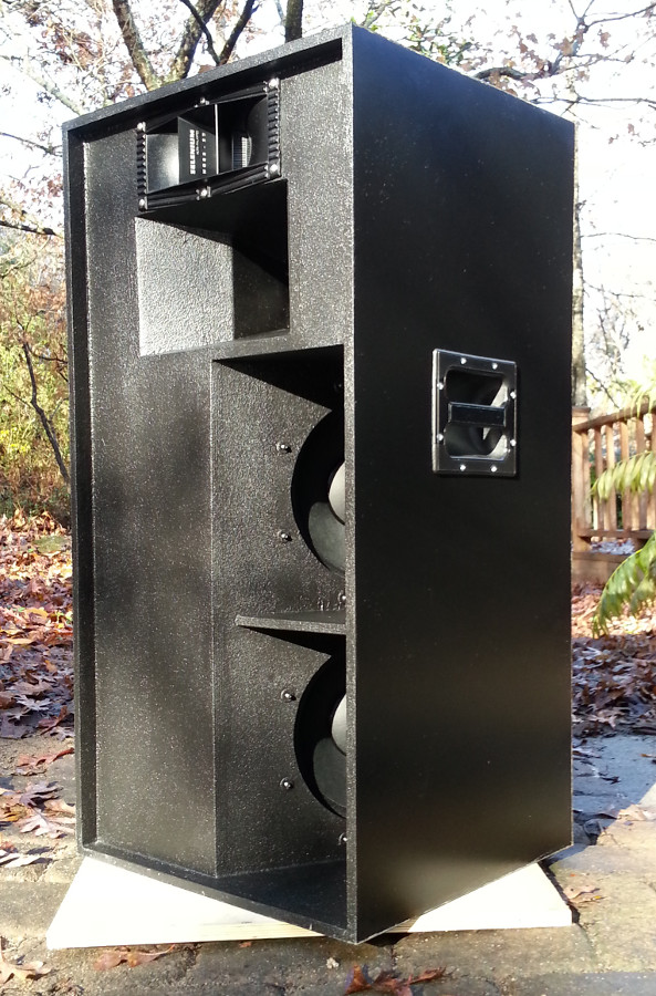

Finally, some progress to report. Family matters took me out of town for a while.
Got Box 1 of 2 fully stuffed and wired, functionally complete. All that remains is the edges, corners, and grille. May add 12" round steel grilles over the 3012LFs, all that would be required is some 1/4-20 nuts, already have the grilles and the speaker mounting bolts would do fine to hold the grilles.
95.2 pounds (43.3 kg) of extremely stout little full-range cabinet. Weighed using a digital strain-gauge scale, so the figure is pretty close to actual. With the corners, edges, and grille(s) probably 99 pounds all up. Hefty little thing. Below are some pictures. As you'll see there is some cleanup to be done. Also, all those edges and seams will be covered by aluminum extrusion. It was far cheaper to get a 96" by 36" sheet of Formica than a 96" by 48"; that's why there are seams at the top and bottom of the back access panel: it was the only way to cover the whole cab out of 1 sheet (that I could figure out anyway). Will be invisible shortly.
Front view of the almost completed Box 1 of 2 (cropped and filled with black around the edges):
3/4 view:
Back view:
All those fasteners on the back panel are 10-24 stainless steel oval-head Phillips machine screws, that screw into T-nuts in the back flanges. The back panel is sealed with neoprene gasket tape.
Will have some interior shots soon, was driven to seal it up and crank it up, could not stand waiting any longer. Have been working on these things SINCE AUGUST :wall: but at last have something to show, and hear as well.
Next: initial impressions of my first BFM build.

Wow, that's a great-looking cab! Will look pretty badass done up in "roadcase trim." Sorta like the MesaBoogie RoadReady bass cabs that are essentially, a cab mounted in a roadcase.
Cant' wait for more pics and your report!
