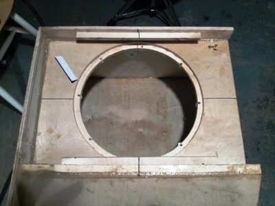

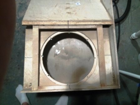

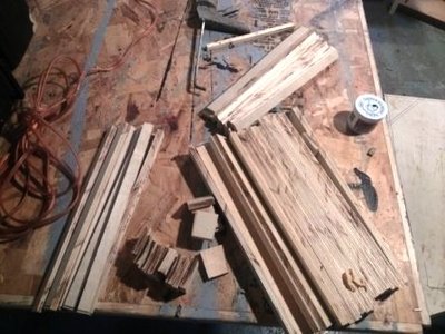

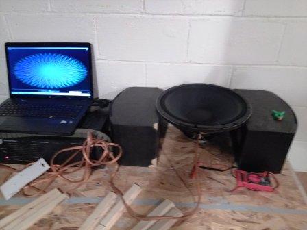

Well havent got much done in the last couple weeks, life gets in the way speaker building once again. Luckily back on task this week and here are some pics. I missed up and my extension panel was 2" instead of 1" so I had to trim it down. Otherwise were trucking right along, breaking in subs and saw dust flying. :chainsaw: :chainsaw:
Finally found a good use for my Bose bookshelf speakers! lol
