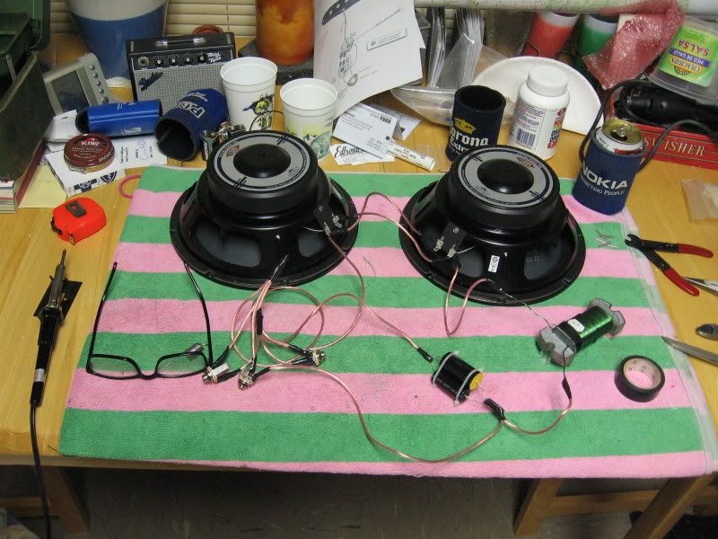

I'm about halfway through my wiring/soldering and I need a break. I think I'll have a beer and then dive back in. Hope I'm doing it right.

Wiring is done! Took a bit longer than I anticipated but like the rest of the build, I took my time to make sure everything was correct. Should be able to finish it up tomorrow. Can't wait to try it out!
Re: Omni 12 2-10?...yup.
Whoa! Not sure. Which is the input jack, and which are the jacks for the tops? It's hard to tell from the pic.Rug wrote:Wiring is done! Took a bit longer than I anticipated but like the rest of the build, I took my time to make sure everything was correct. Should be able to finish it up tomorrow. Can't wait to try it out!![]()
Also, I'm not sure you need the batting. In the original version the bass drivers cover up to 500Hz, as I recall. The batting will stop cancellation in the upper frequencies. In this case your shutting them off at 150Hz. On the other hand, it probably won't hurt.
Bill, can you comment on this?

The motion of the driver cones creates harmonics, which must be damped out, so lining is necessary. Only with folded horn subs is lining not required, as the folds of the horn filter out the harmonics.Tim A wrote: Also, I'm not sure you need the batting. In the original version the bass drivers cover up to 500Hz, as I recall. The batting will stop cancellation in the upper frequencies. In this case your shutting them off at 150Hz. On the other hand, it probably won't hurt.

I know the picture looks kind of confusing. I wasn't really laying it out to have it double checked. I was just showing my progress. I'll plug it all in and try it out today and I'll let everyone know my outcome.

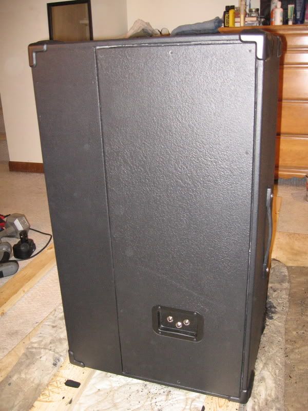

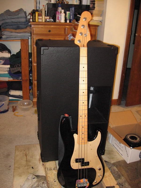

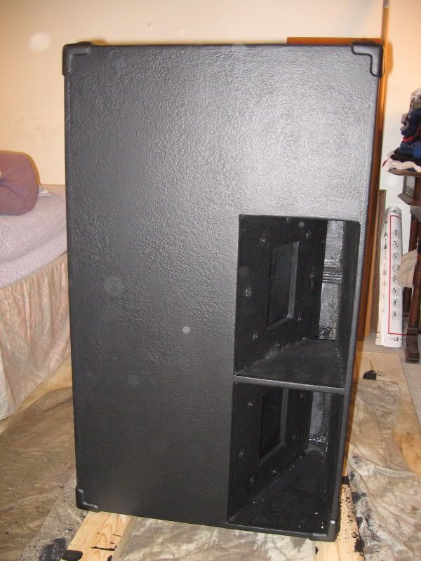

Finished it up today. Kind of a bittersweet ending. I'm happy it's finished and I'm really looking forward to trying it out with the band (Friday eve) but I had such a great time building it and I'm kind of sad it's over. Can't wait to get started on my next project (wedgehorns) but it might not be until after the holidays.
Tried out the sub with my bass and it sounded pretty good. Really solid on the lower notes. Can't wait to hear it hooked up to the PA. My bandmates are pretty excited, too, especially my drummer. I'm hoping to get a pretty solid thump from his bass drum out of it.
First two pix are of the finished sub. Last pic was taken last night, before I was finished, next to my P bass to show size.
Looks good, glad it went well. Putting together a kit for a cab I hadn't built was a challenge. You were the guinea pig.
Is it optics, or is the third jack in that plate that much off center? If it is, I'll make a new one and send it to you. I couldn't find a 3 hole plate I liked, so I'm making them.
Thanks for the offer, Leland. It just looks skewed because of the angle I took the picture. It's fine as it is.LelandCrooks wrote:Is it optics, or is the third jack in that plate that much off center? If it is, I'll make a new one and send it to you. I couldn't find a 3 hole plate I liked, so I'm making them.
