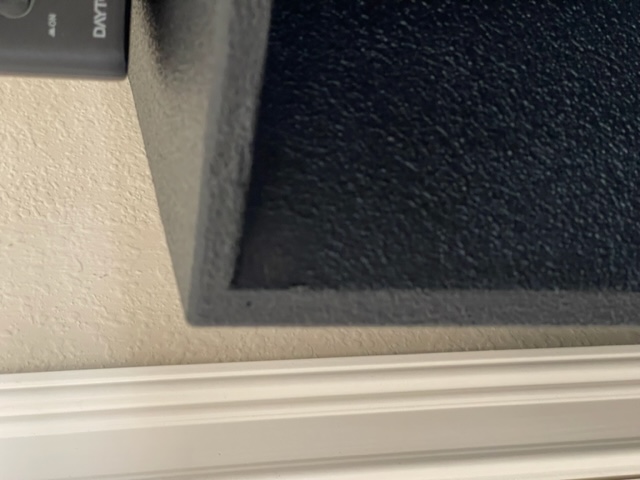

On a completely different topic....I'd like to put some kind of fabric grill over the speakers and sub, just to keep bugs and some of the dust out of them. The edge is 1/2" wide...is there an easy way to do it? And am I looking for anything special as far as fabric? Thanks :)

Fastskiguy wrote: Mon May 01, 2023 7:02 pm On a completely different topic....I'd like to put some kind of fabric grill over the speakers and sub, just to keep bugs and some of the dust out of them. The edge is 1/2" wide...is there an easy way to do it? And am I looking for anything special as far as fabric? Thanks :)
Sure.
Make a frame that fits just inside the cab edges with a gap big enough for the cloth, cover that with "speaker grille cloth" (fold over the back of the frame and staple on to secure).
To attach, add some small blocks to the inner side of the cab (enough so the grille won't flex) that determines depth of the grille.
Add some magnets to the blocks and the grill and it should snap in place. Or same thing with fancy do dad speaker grille mounting parts (one half will be male, the other female).
Or go nuts; check out my DR250 build thread on page 2.
About 3/4 of the way through that, you'll see what I did for grille, which now has 1/4" speaker grille foam behind it...
Grills - yes....fabric- no. If they are going to be outside, it's easier to wipe down the inside than to try and get the dust off of fabric. My T24 has been sitting in my garage since I built it. I just hit it with the air hose every now and then. And the SLA has a grill with foam behind it....with all the sawdust I create in there - it just doesn't hold any dust.

Grille options are shown in the plans and the sketchup model.

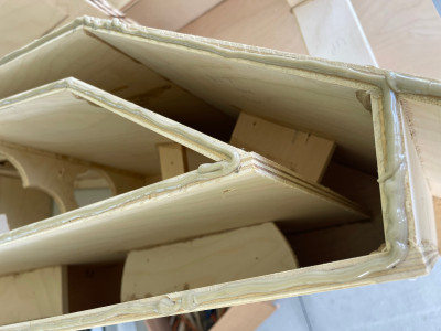

Today was a big day for the T45....say it with me...."Generous Bead"!!!
She's all sealed up, never to be opened again. Historic!
Ok, who among us write fun little thoughts inside just before closure? I know I always do!

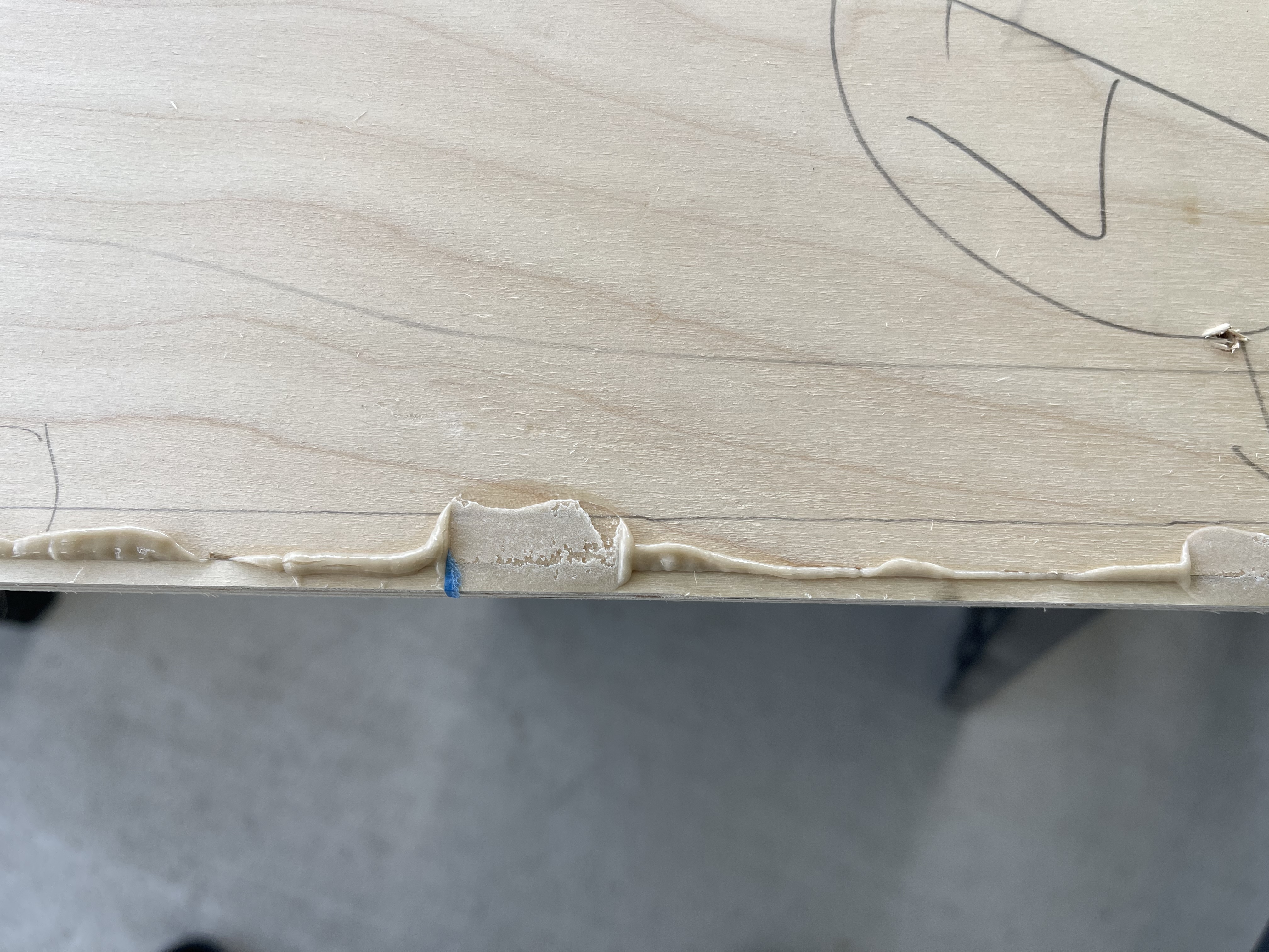

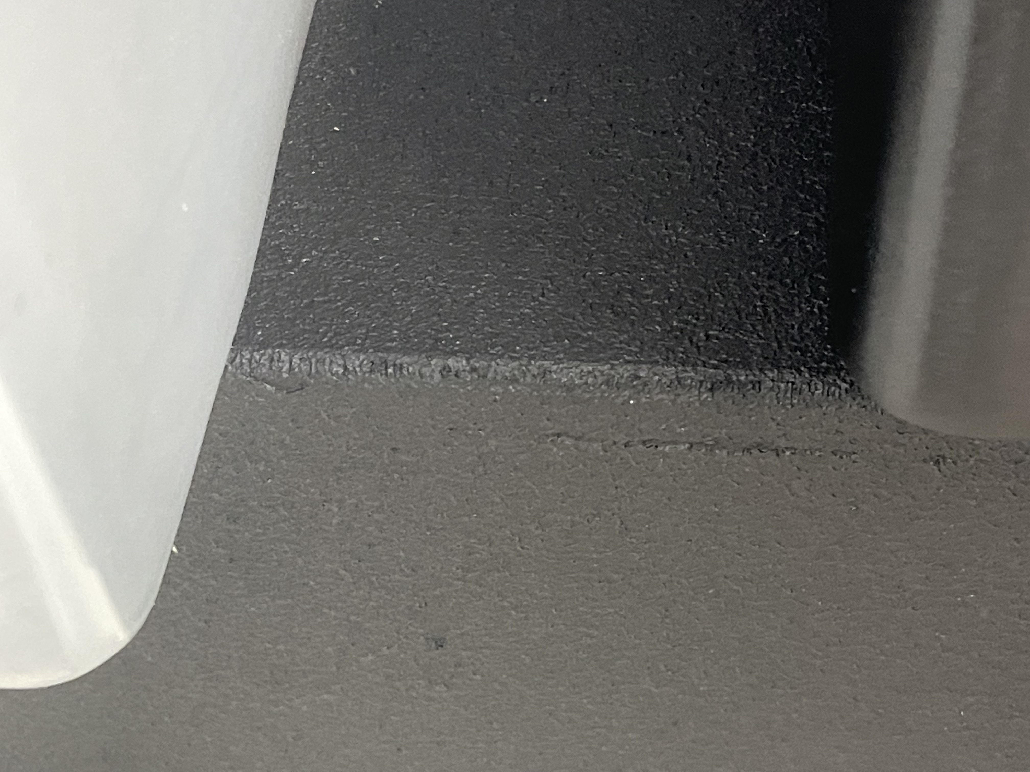

I came up a bit short on the bottom edge and glued on a thin strip of plywood. Hit it with the router and Duratex and it turned out ok. Just wanted to throw in a little something….it is a build thread after all.
