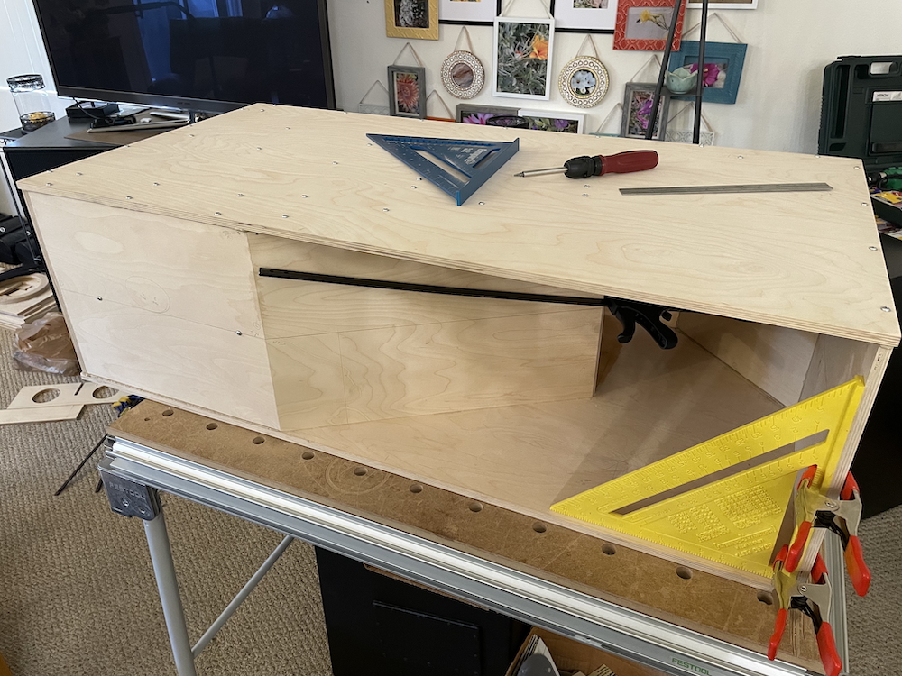

Side glued and screwed down. Technique applied here of holding off installing Panel 11 (mouth reflector) until the day of glueing down the final side panel. This affords some latitude to not only square up the mouth perfectly with clamps, but also allows that panel to "float" a little in its place while it cures, eliminating internal stress.
If there's ANY twist or bend in the mouth area paneling prior to setting down the final side, curing Panel 11 ahead of this schedule has the potential to permanently set that misalignment, no matter how miniscule, and can make squaring up Panel 10 to the side panel difficult at best.

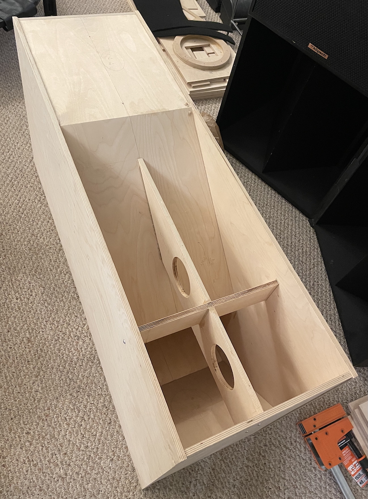

Mouth brace installed and curing up.

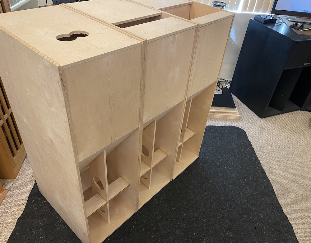

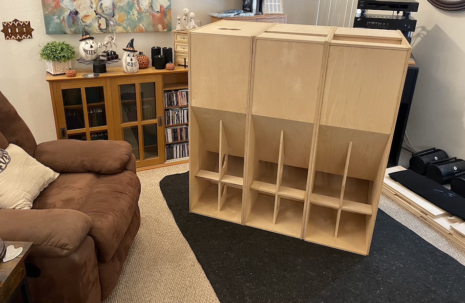

It has to be re-stated. The Titans indeed hold up to their namesake. These suckers are large, by any standard, and am solemnly reminded so every time we haul them out for pictures. I'm average height and a T48 stands right up to my chest. They simply dwarf the Klipsch La Scala.
Re: Radian's T48 slim build
Looking good! What is your use case for these Subs? What drivers are you using?Radian wrote: ↑Sun Oct 26, 2025 6:28 pm It has to be re-stated. The Titans indeed hold up to their namesake. These suckers are large, by any standard, and am solemnly reminded so every time we haul them out for pictures. I'm average height and a T48 stands right up to my chest. They simply dwarf the Klipsch La Scala. :twisted:Three.jpg
QSC 1804 Amp
QSC 1804 Amp
Corporate / Boutique audio presentation, using the HL-10C
