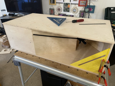

Side glued and screwed down. Technique applied here of holding off installing Panel 11 (mouth reflector) until the day of glueing down the final side panel. This affords some latitude to not only square up the mouth perfectly with clamps, but also allows that panel to "float" a little in its place while it cures, eliminating internal stress.
If there's ANY twist or bend in the mouth area paneling prior to setting down the final side, curing Panel 11 ahead of this schedule has the potential to permanently set that misalignment, no matter how miniscule, and can make squaring up Panel 10 to the side panel difficult at best.

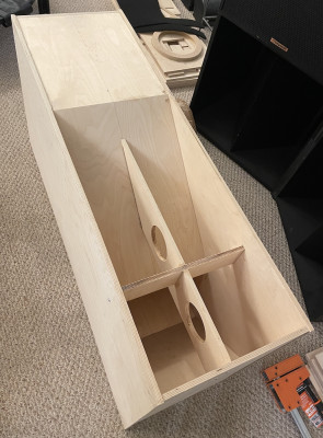

Mouth brace installed and curing up.

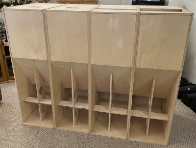

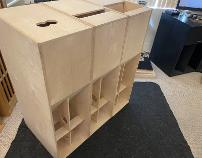

Number 3 cabinetry assembly complete. Onwards to Number 4! :hyper:
Posts: 2069
Re: Radian's T48 slim build
#64 Post by Radian »

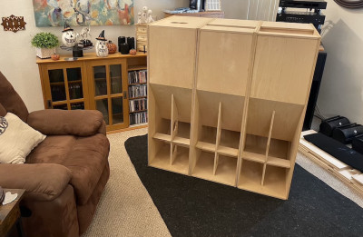

It has to be re-stated. The Titans indeed hold up to their namesake. These suckers are large, by any standard, and am solemnly reminded so every time we haul them out for pictures. I'm average height and a T48 stands right up to my chest. They simply dwarf the Klipsch La Scala. :twisted:

Well...that only took four years, but the cabinet assembly for this 4-pack is done. :noob: Onwards to finishing millwork, handles, hatches/wiring, first voice, filling/finish sanding, paint, and final assembly.
