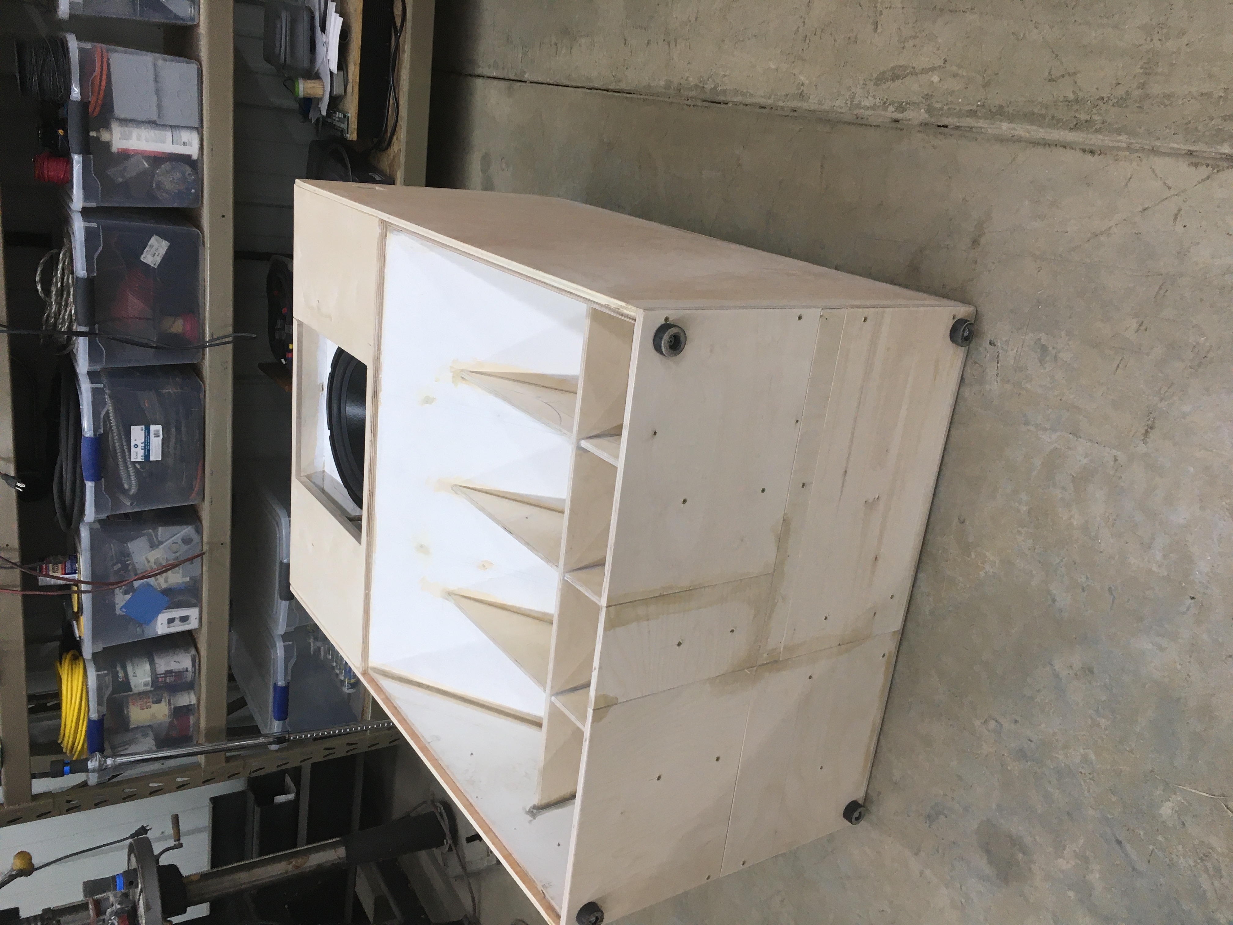

RYNO20 wrote: Fri Feb 05, 2021 7:13 pm Up and running, covering not done.
Looks like you doubled up the outer panels with some pine. Is that access panel 3 layers, 1½" thick? Built like a brick!

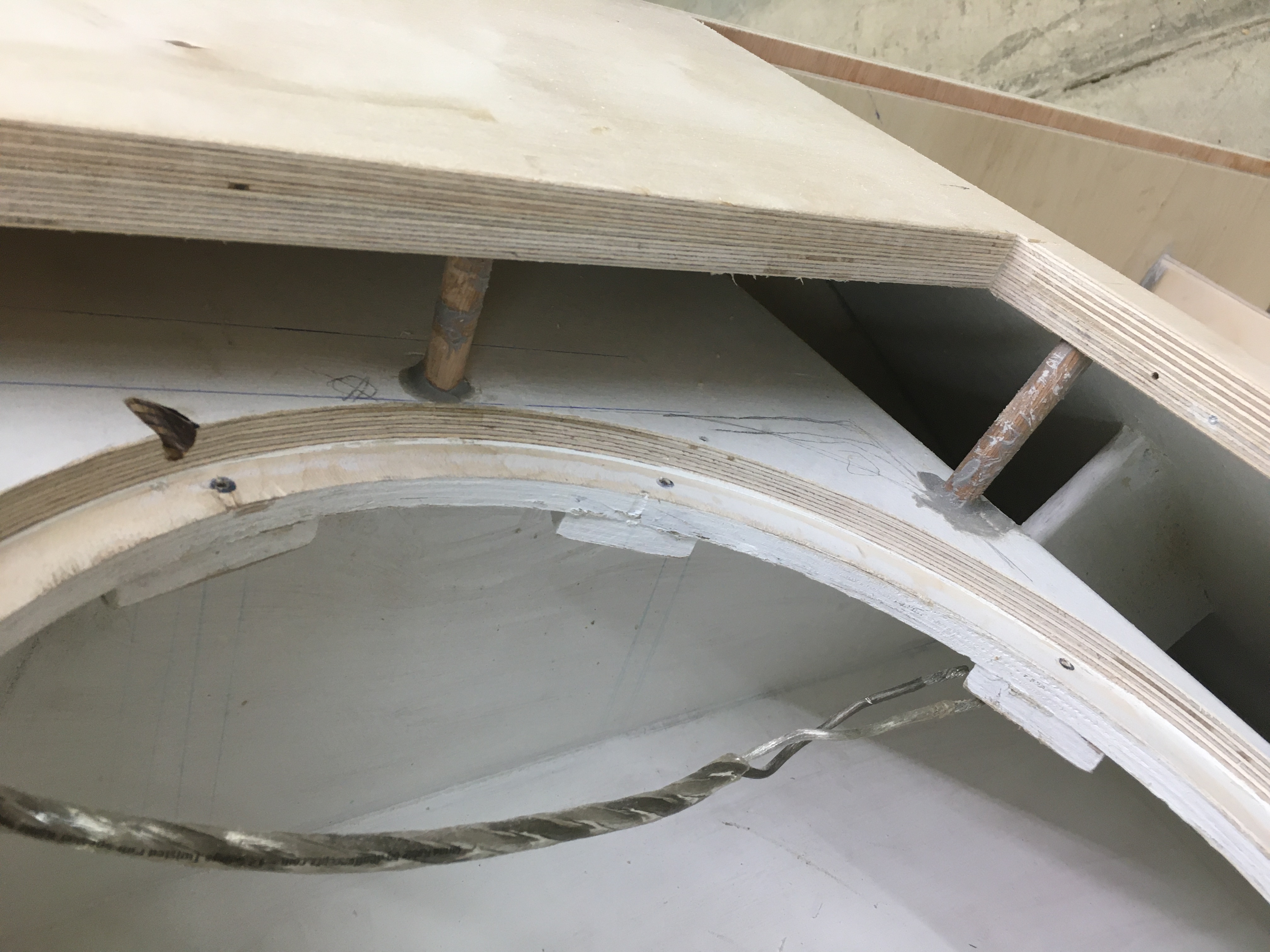

I figured you could spot it
It’s a permanent setup so yes because of how I will finish it didn’t want screw holes in sides or top or anywhere
Used all BB 9 ply 4 sheets,double top ,back,front and leftovers on bottom- the sides are 3 ply 1/2 , oh and the chamber reducers have 2 supports in each side and are spray foam filled along with the 45 degree corners.
Speaker cover is just temporary
Took you advice and it’s running on the PV-900 bridged , wow at very low power I can now here the instrument that makes the low note.

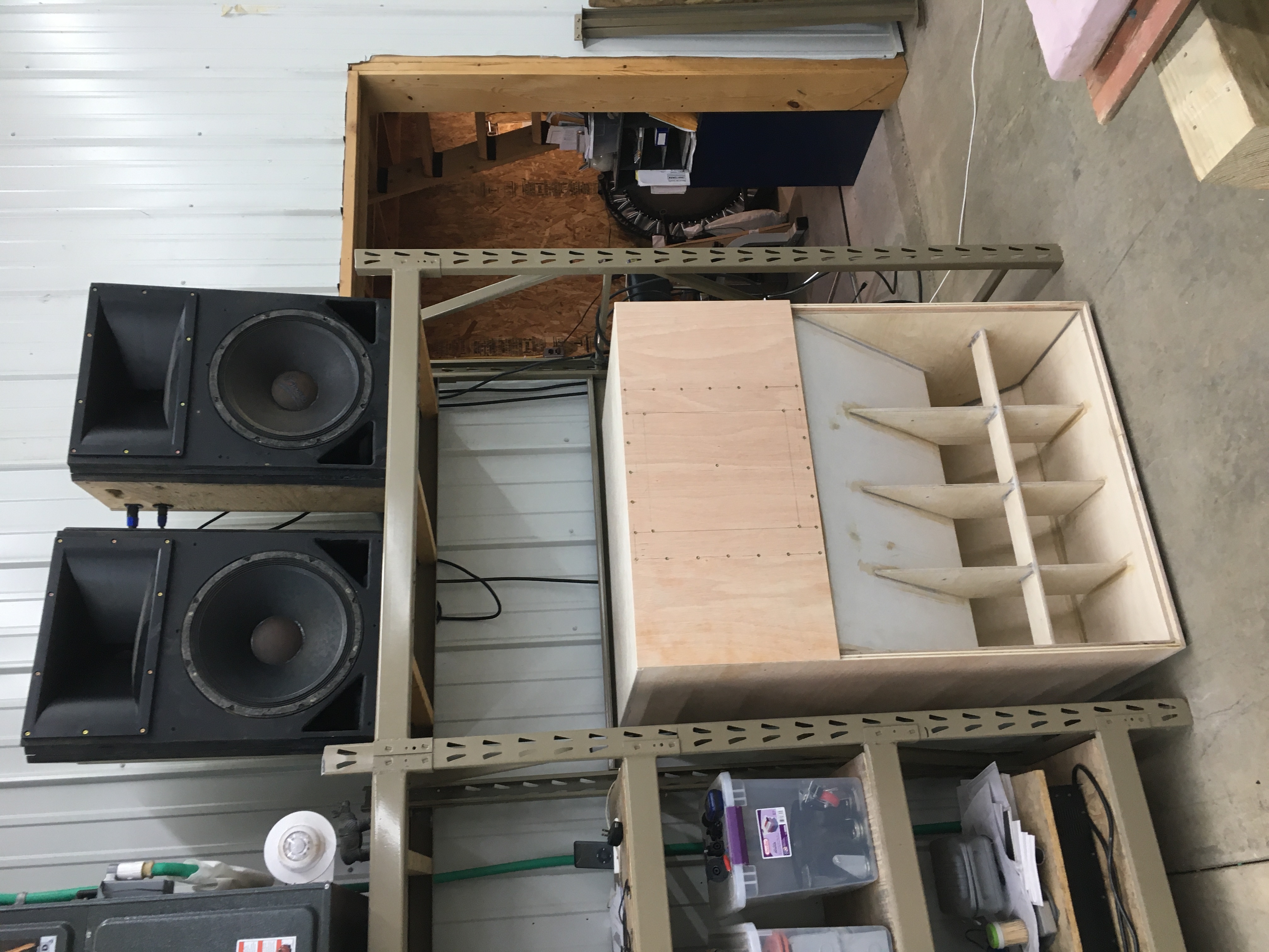

As you can see by the pics that mine is a permanent install in a 40x48 steel walled building 13 feet ceiling.
That is right and left channel above T-48 , BMD-750 (p.audio) and 1508 bmx he peaveys
I can separate them if it would be better but the shelf was there lol , they weigh 100 lbs each or close (yeah very thick sides etc just experiments.
Putting a stand to the 6x6 wall posts to hold speakers up and at down angles , swivels I can do.
You run a pair per side , yeah my shop could get away with one per side
