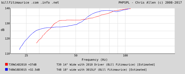

Something is funky with the charts Seth.
In order for the top chart to be apples to apples, both the T39 and T48 traces need to have the same 18 inch width, then +6dB can be added to both traces for 2 cabs.
I get that you took the 4 x 14" S2010 trace from the Labsub comparison in the T39 SPL charts section, and there's not really any ready done SPL charts to allow that, but for the purpose of demonstrating the difference, using a 20" wide S2010 loaded T39 chart would be close enough.
Then, with the second chart, the S2010 in the T39 has a limit of 27V, or +20dB at max (The +20dB S2010 figure is derived from the T39 charts page).
The T48 with a 3015LF is going to be perhaps a tad more than +26dB max with it's 60V limit (since a 56V limited 3012lf in a T39 is +26dB at max).
Or a single 20" wide S2010 chart and an 18" wide T48 chart together, then add +26dB and +32dB respectively to compare each x 2 cabs.
I haven't and don't use the SPL charts tool, but with a chart done with the above in mind, it wouldn't surprise me at all if the T48's won the day...

Grant Bunter wrote: ↑Wed Jun 02, 2021 5:25 pm
Either I'm not understanding your point, I wasn't clear enough about the numbers in the previous post, or you misunderstood his question... He specifically asked about 4 slim T39's KL3010LF loaded compared to 2 18" T48's, 3015LF loaded (similar pack space). Why would we want to model a 20" T39 if he's interested slims?
Since the only T39 slim(ish) chart is with the S2010, that's the closest reference to use. +12dB on the T39 to account for 4 cabs @ 2.83v. +6dB on the T48 to account for 2 cabs @ 2.83v.
In the second charts we're pretending the 10" drivers are KL3010LF's, which have a voltage limit of 50v. I did actually make a mistake and ran the numbers based on a 45v limit though.
Here they are again, 50v KL3010LF T39's x4 and 60v 3015LF T48's x2, along with the breakdown. By the way, the charts are just in the charts tool and +dB are manually added.
Here's the thread on how to use the charts tool. For easy access/reference I have the page linked in my signature. See that last little "1" in the MCM part number? There it is. Sneaky little secret quick reference link.
So for the slim T39's it's base plus 6 to account for doubling to 2 cabs and another 6dB for doubling again to 4 cabs, totaling +12 for the 4 cab count.
50 volts @ 8ohm is 312w which equates to +24.9dB (25dB) power gain.
25+12= +37dB
For the Pair of T48's, +6 for 2 cabs
60 volts @ 8ohm is 450w... 26.5dB power gain
26.5+6= +32.5dB total gain above the charts native 2.83v trace.
Side note: the 14" T39's in these charts are actually 1" wider than the slimmest T39 in the current plans. So, there's another slight inconsistency in the traces in the chart above; it's not actually KL3010LF loaded and it's an inch wider than a slim. Ultimately just a rough idea what to expect.

Seth wrote: ↑Wed Jun 02, 2021 8:36 pm

While it's an intriguing question within itself, the charts are raw charts. They don't account for the limitations stated in the plans.
HP for 2 x t48's is 40Hz, 4 x T39's 45Hz.
So, if content is part of the equation, then, at 40Hz, the 4 x T39's, with a 24dB/octave slope at 45Hz, will be at least -6dB compared to the value at 45Hz, which should mean, based on a chart visual only, that the advantage goes to the T48 at 40Hz (by roughly 2dB).
