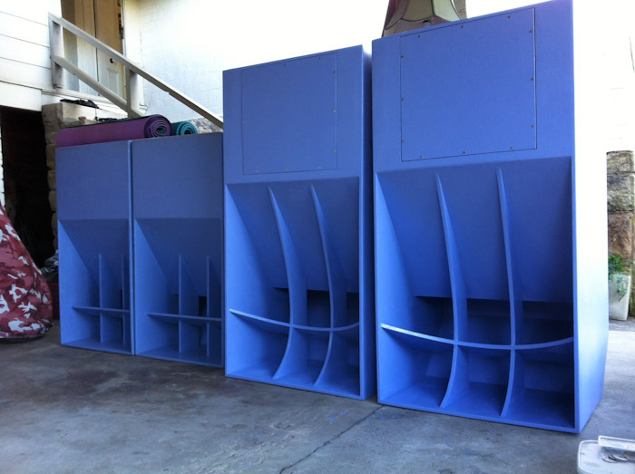

I'm searching for a pic I saw a few days ago that came up in a google photo search. It was a T48 next to a T39. It didn't say what the widths were, but they looked to be about as wide as they were deep. So, roughly 20" for the T39 and 24" for the T48.
The T48 absolutely dwarfed the T39. I'll post it if I can find it again. Can't remember what I was searching when it came up :wall:

Ok guys finally found that T39/48 picture. I know these are much wider that i plan on, but ... woah that is a difference.
viewtopic.php?f=13&t=17112
I had put some serious thought into the SLAs. I’m sure they would be loud enough and the size, form factor sure is appealing, but I’m really comfortable with the wood working and now were talking cost vs performance, with the extra drivers. Besides, the OT8s are small enough to fit in the wife’s Buick Enclave ;)
Posts: 3056
Re: Scaling way back! Lots of questions
#75 Post by Seth »
Yes! Exactly the one I was looking for! Spent fruitless hours looking for that last night. Glad you found it so I can rest my mind.
