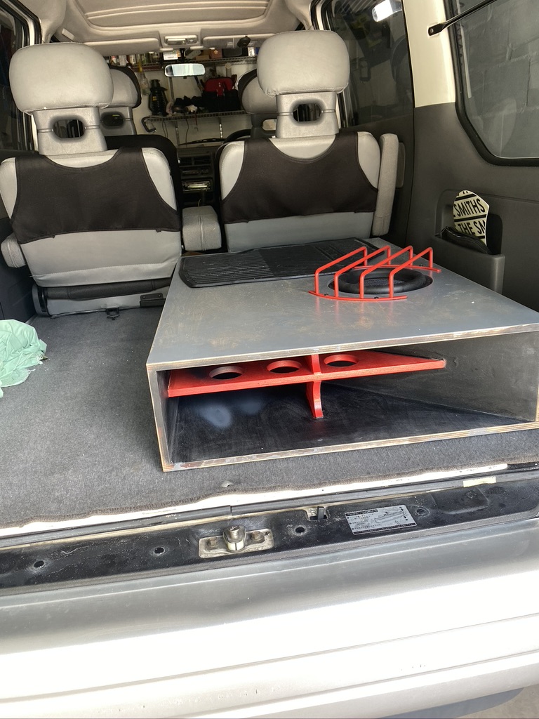

Sorry I have not been back in awhile. I got the system done and forgot all about you guys!

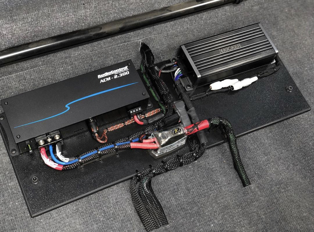

I ended up using the Kicker Key amp- which comes with DSP and onboard calibration mic and costs about $200 on PE. Did I mention this $200 amp includes DSP?
It's a 4 channel and I was using it to run a full active setup- no passive x-overs. I ended getting the pricy but useful ultra thin Morel mid bass and had pods fabbed from ABS and sound dampened on floorboard but facing forward.

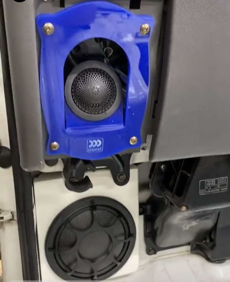

The factory tweeter 4x4 locations were used for a set of Morel soft dome tweets. But I had brackets printed so the tweeters would fire more forward and upward vs the naturally downward orientation. Then I let the DSP on the kicker amp do the rest. It's pretty amazing how much performance you can get from such an inexpensive amp!

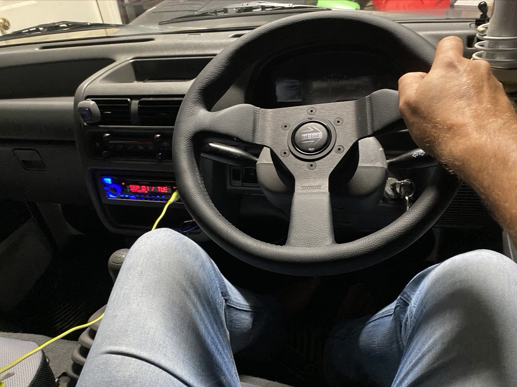

I used a single DIN Kenwood Excelon- which only plays HD and multimedia and no CD transport. It sounds really good and even the HD tuner is listenable for once.
For the truck tuba I used the Dayton UM-8 and another micro amp from Audio Control AGM 2.150.
I had some help from a local boutique shop that caters to DIY crowd. They "helped" me with the stuff that I was in over my head. My idea was to make pods for the door panels. But having forward facing speakers with the DSP magic really surprised me on what was possible as far as a credible sound stage in a car.
This kei van only has a 50 amp alternator and I want to keep current draw at a minimum. I do have an AGM battery as well. So far so good. I think one of the micro amps has a 20 amp fuse and the other a 30 amp fuse.
I honestly was thinking the whole thing might be too bass heavy. But it's actually more of a studio sound with modest bass. The bass is good but doesn't make the hair stand up or anything. The driver barely seems to be moving but I really don't test it with bass tracks, as I am a big fan of listening to music
. Mine is built to 7" depth. There are no leaks and no weird echo noises that I can hear. I tried it with a one off Eminence 8 that looks like it was made for horns- its all surround and dust cap and no visible cone and 4 ohms. It way less beefy than the UM-8 but it sounds pretty damn good in that enclosure for some reason. I really wanted to have a single 8 as my part of my theme. Overall, very happy with the musicality but would like a little more slam.

Re: 8" vs 10" truck Tuba
I was wondering about your project just the other day. Good to hear from you. What a great updateiSurfSouthChinaSea wrote: ↑Tue Dec 01, 2020 1:18 am ...Overall, very happy with the musicality but would like a little more slam.
Just a little warning/insight; a lot of times what people are referring to with terms like "slam" or "punch" is actually distortion that's more related to direct radiator subs and not-so-much a sound that horns produce. Not good or bad just what the case is. Sometimes I miss it a little too. But, I'd never trade the sound of smooth effortless bass to get a little dirty slamming sound.
Although, you can polish the sound of the TruckTuba quite a bit with careful EQ and Crossover selection. I found crossing it much lower than is typical helped tame the rising response and give the overall sound a desirable bottom end "tilt", then increasing the sub amp gain (and/or reduce the mid/high amp gain) so that the response produced a smooth transition at frequencies around the mid drivers highpass frequency. Don't quote me on this, but I wanna say I low passed the sub at 40Hz on an 18 or 24 dB/octave slope, or something like that. It really woke up the bottom end and gave a very pleasant curve and listening experience with pretty much any listening material.
What frequency is yours low passed at now, and what dB slope? Do you have any EQ adjustability on the sub amp?

subsonic filter at 32 hz. The HPF is selectable at either 80 Hz or 120 Hz at a 12 dB Linkwitz-Riley slope. The mid bass drivers are in sealed enclosures but there just isn't any real airspace for them to play that low. So I must use the 120 Hz setting. The AGM 2.300 amp does not have any DSP or further bass controls. It does not even have a bass knob which is driving me nuts. Maybe I should have got the Kicker Key version for bass- which will has DSP. The AGM 1.300 allows use of a remote bass knob and "Accubass." Its my understanding that the Accubass is to correct EQ errors when the user is running it off the speaker level inputs.
The Kenwood head unit has some EQ and bass functions but they don't sound that good so I leave those flat. I seem to have a dip at 60 hz and I would prefer a peak, or at least a flat curve there. The increments for EQ skip over 60 hz. I think it goes from 50 hz to 70 hz.
The spacial enhance circuit does sound good for 80% of the material and I do have that engaged.

Thanks. I thought about the Dayton DSP but if the kicker key amp includes DSP and a mic, it's a no brainer. I'm sure it's a fine unit. Ideally, I would prefer a single chassis solution- 5 channels and onboard DSP.

A compact 5 channel amp with user configurable DSP would be awesome. I like the idea of an all-in-one solution too.iSurfSouthChinaSea wrote: ↑Fri Dec 04, 2020 10:50 am Thanks. I thought about the Dayton DSP but if the kicker key amp includes DSP and a mic, it's a no brainer. I'm sure it's a fine unit. Ideally, I would prefer a single chassis solution- 5 channels and onboard DSP.

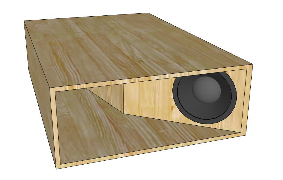

That's interesting that you bring up tapped horns as an option. I was looking at my TruckTuba the other day and realized that if the cab was made about 9½" wide or wider, the driver(s) could be put in the mouth panel. I don't know if having the driver in the mouth magically makes it a tapped horn or not (I suspect not, guessing there's more to it) but thought it was an interesting option that I'd try if I ever build a TruckTuba again. In any case, it's a nice protected spot for the driver(s). It would be a tight squeeze, but I think 2 drivers may just barely fit on that panel and have the magnets clear behind too... MAYBE.
Even if I was in your shoes, with DSP already taking control over the mids and highs... well, I kinda am in your shoes. I have a stock stereo system in my car and want to add the sub in. Anyway, I want full DSP control over the sub channel. I got a Parts Express catalog in the mail the other day. I don't usually look at junk mail, but CarterCraft was talking about his Parts Express Blast Box about the time it came. So, I flipped through the catalog for a bit and an interesting product caught my eye that I thought might be worth fiddling with. It's a DIY type of solution vs. a commercially polished end user type of product, but it may have some merit for my intended purpose (DSP control over the sub in my car). Maybe it will tickle your interest too? Dayton Audio DSPB-K DSP Kernel Board and DSPB-KE Kernel DSP Expansion 2-In 3-Out

The tapped horns seem to be VERY particular about the geometry, which determines its pass band. I don't think I have any music with 20hz content, even the electronic stuff. I would be happy with non-imaginary response in mid-thirties. The speaker magnet always faces out because the first chamber is always very small.
I know folding THs is not easy. This T-6 open source design does not allow easy access to the driver. I won't expect big SPL improvement but who knows? Every car is different. But I like that effortless, resonate sound you can experience at any volume with THs. Serious math and very picky on drivers. That Tom Danley guy must be a genius. I would love to hear his TH-28 in my kei van. The TH would be built to 9.5" depth to accommodate an 8" driver (or the SB Acoustics 9" driver).

It doesn't. A tapped horn has no rear chamber. They're considerably more difficult to design than other horns, because of the phase relationships between the front and rear waves. Most of those that I've seen aren't very good. Danley's are very good, but they're the exception. BTW, Danley didn't make the first tapped horn, although he did coin the name. I've seen prior art in patents going back to 1958.SethRocksYou wrote: ↑Fri Dec 04, 2020 12:27 pm I don't know if having the driver in the mouth magically makes it a tapped horn or not
