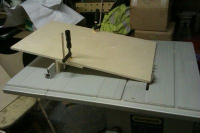

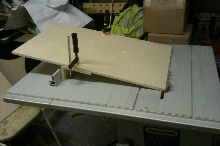

Largest panel mitre cut - wouldn't fit on table saw, so angled it up over the fence on one of my right-angled jigs, used a bit of trig to modify blade angle settings and got a good result, as below. I also cut the 7/4 braces.
Next time in the garage, I am doing the other remaining (12) handle pockets and the 8 gusset panel pieces (3 horn path and 1 chamber reducer, per cab), ...I think!
Beautifully done!

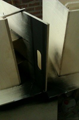

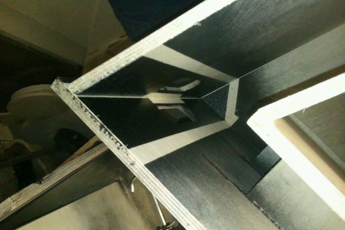

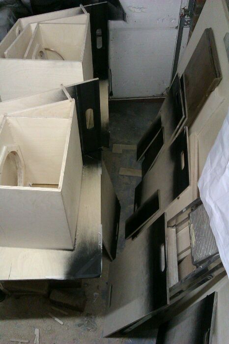

Some good progress today. Routed and rounded over the remaining 9 or so handle pockets holes. After breaking my 6mm dia router bit that was required due to how I'd conjured my elaborate oversize template, I figured i would do what everyone else does, and use a follower bit. The only issue is mine (follower bit) is arse about face - the roller is on the end, so the size for size template goes underneath the one you're cutting! Not a big deal except one needs to pop a hole through to drop the router bit through, to get going.
Now, i know the pictures look like various angles of the black hole of calcutta, but there's a purpose - I've primed the insides of where all the handles are, but masked off the joint lines and where the beading goes on the handles for comfort - It's easy to see quite large areas through the handle pockets. I'll be duratexing these regions before assembling the remaining panels together.
Also put braces 7/4 in before getting handy with black spray can. Did I say i love the brad nailer - my, my, it makes joint assembly the absolute quickest events in the cab building process.

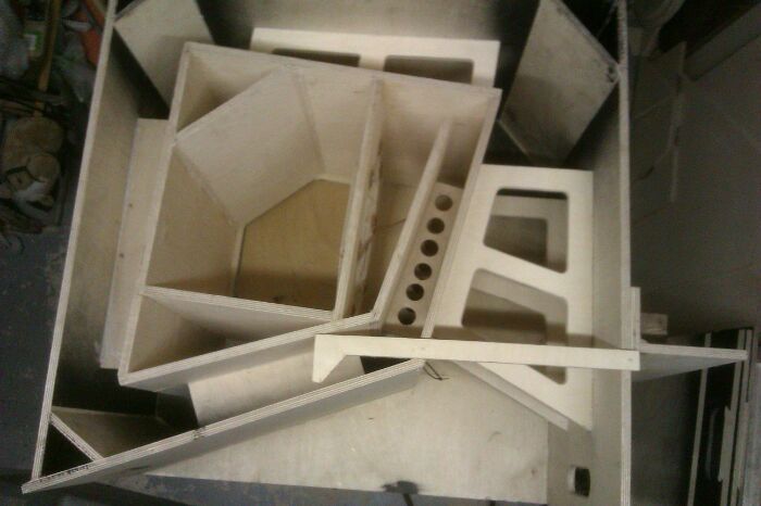

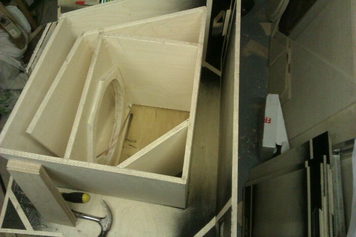

It's not much, but I'm claiming it: cut Mitred reflector panels and chamber reducer panel, installed chamber reducer panel, ripped up 1 1/4" strip for framing out access hatch, and readied panel 8 for installation. Inside handle locations pre painted.

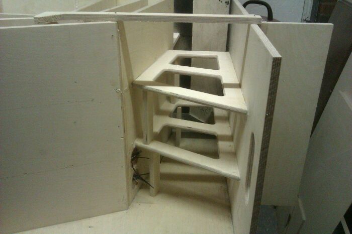

Anyway, installed are: panel 8, 8/2 6mm thick braces, panel 9 (reflector), panel 10, panel 11 (reflector), plus quarter-round mouldings in the 2 handle pockets created so far. The other cab is also to do, for the above, but with all pieces cut/mitred at this stage I will probably bring this one up to being ready for the side fixing on, as there are no set-up-time reduction gains to be had by running things in parallel till then.

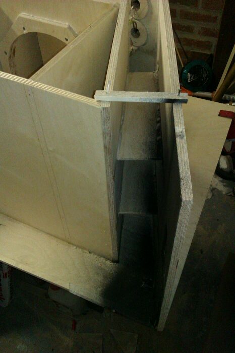

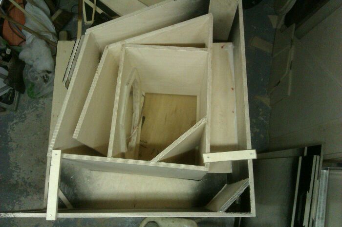

The progress rate is officially embarrassing now. Here is the remaining stand up panels and braces in the first of 2 subs. I've rounded over the cut outs and front and back edge on the main mouth braces.
