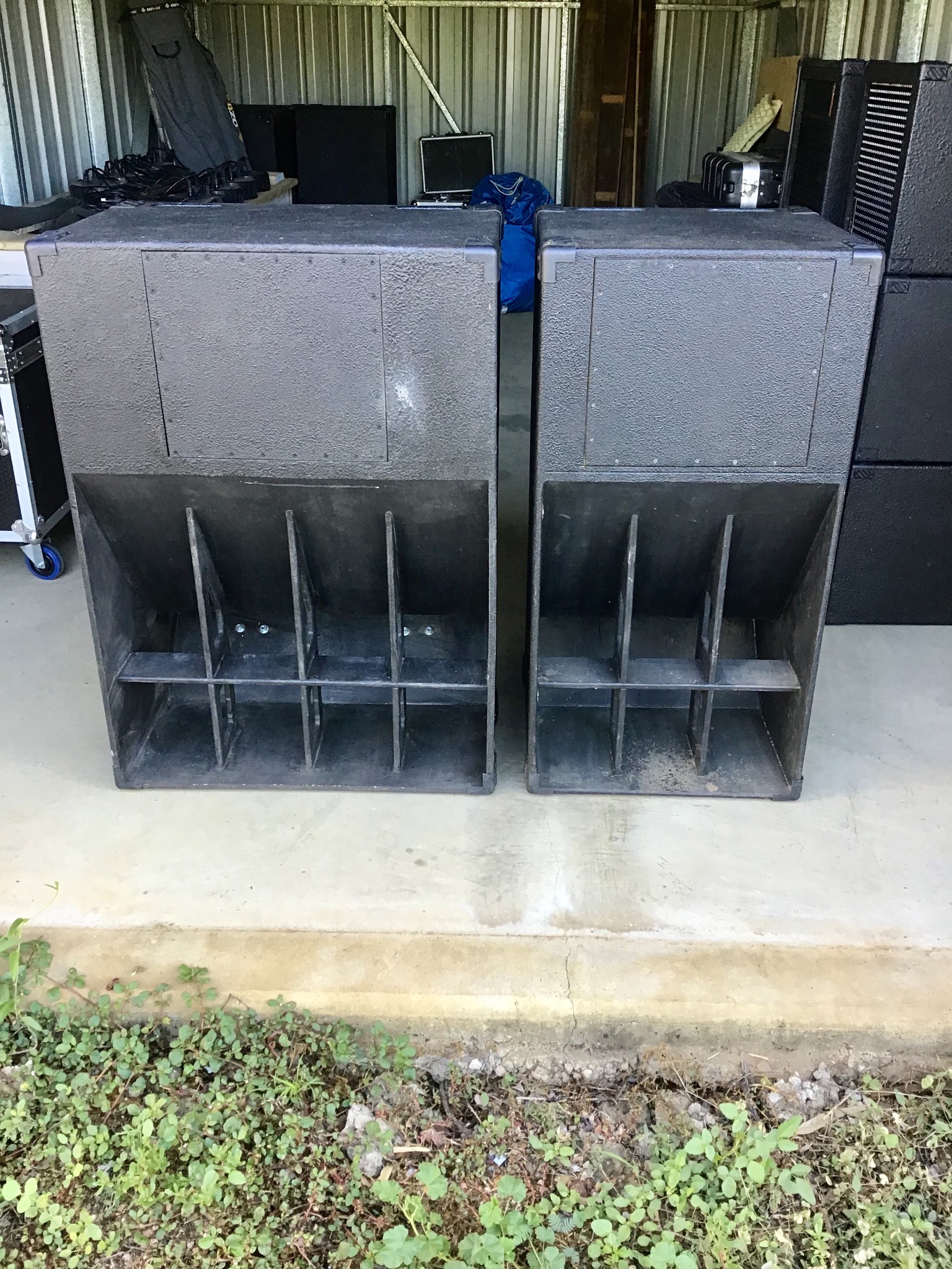

At last, got time for a pic!
28” on the left vs 20” right:

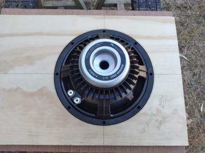

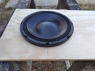

Sorry, they're not in order, but top to bottom pics wise:
4 x KL301LF's to me.
After the mod.

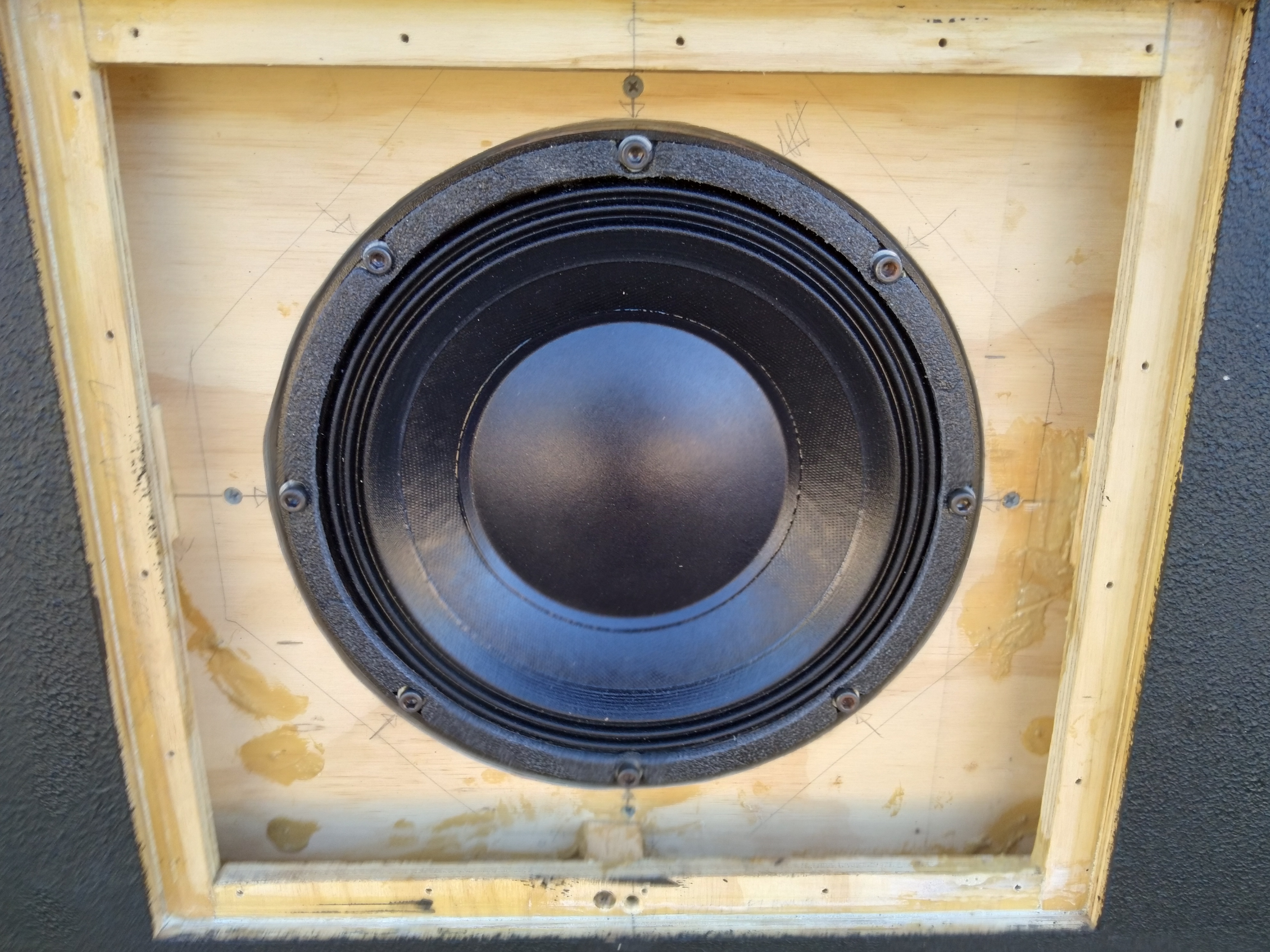

Corner pieces of 1/4" ply as supports.

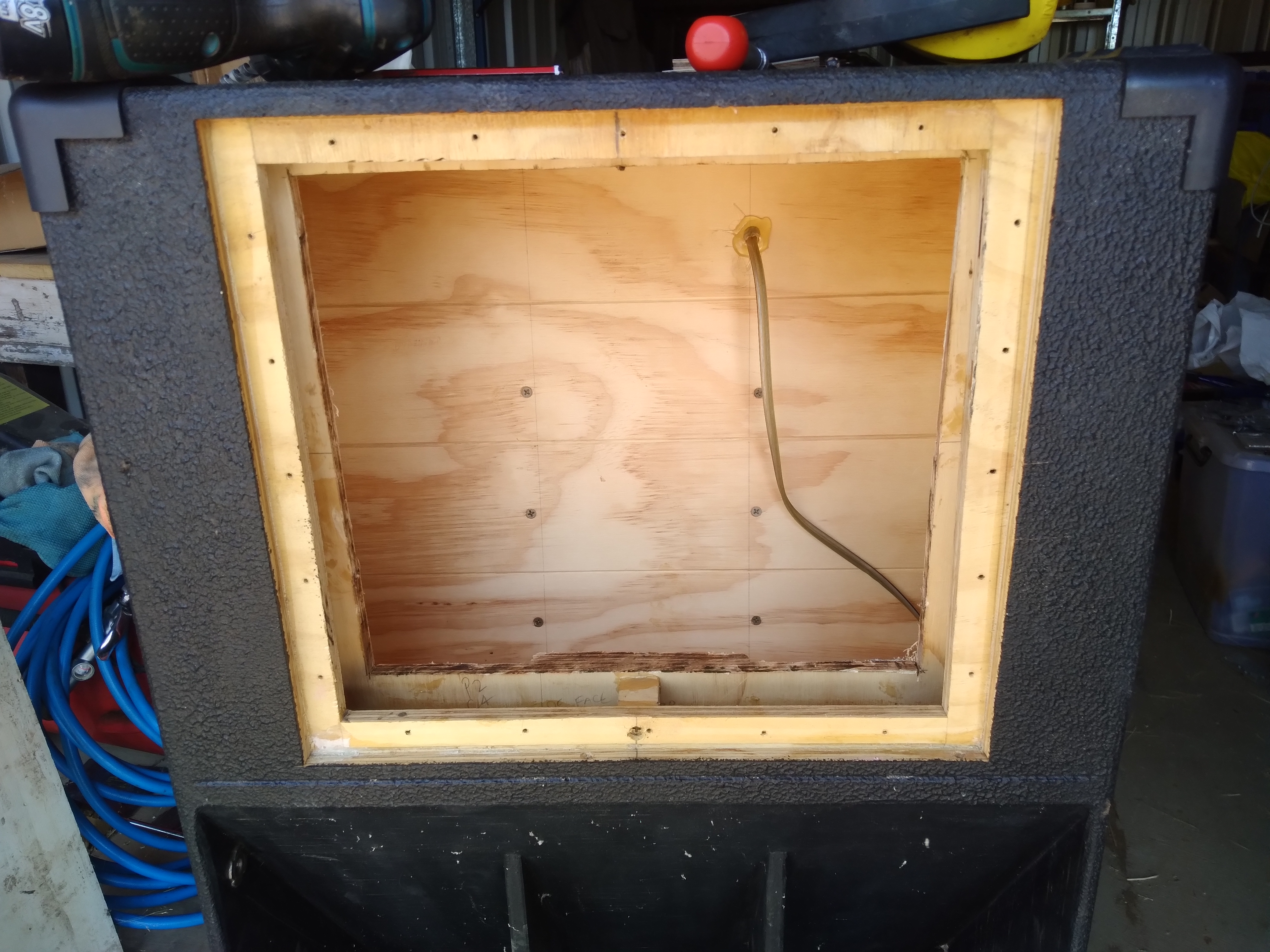

Baffle enlargement completed and blocks applied.

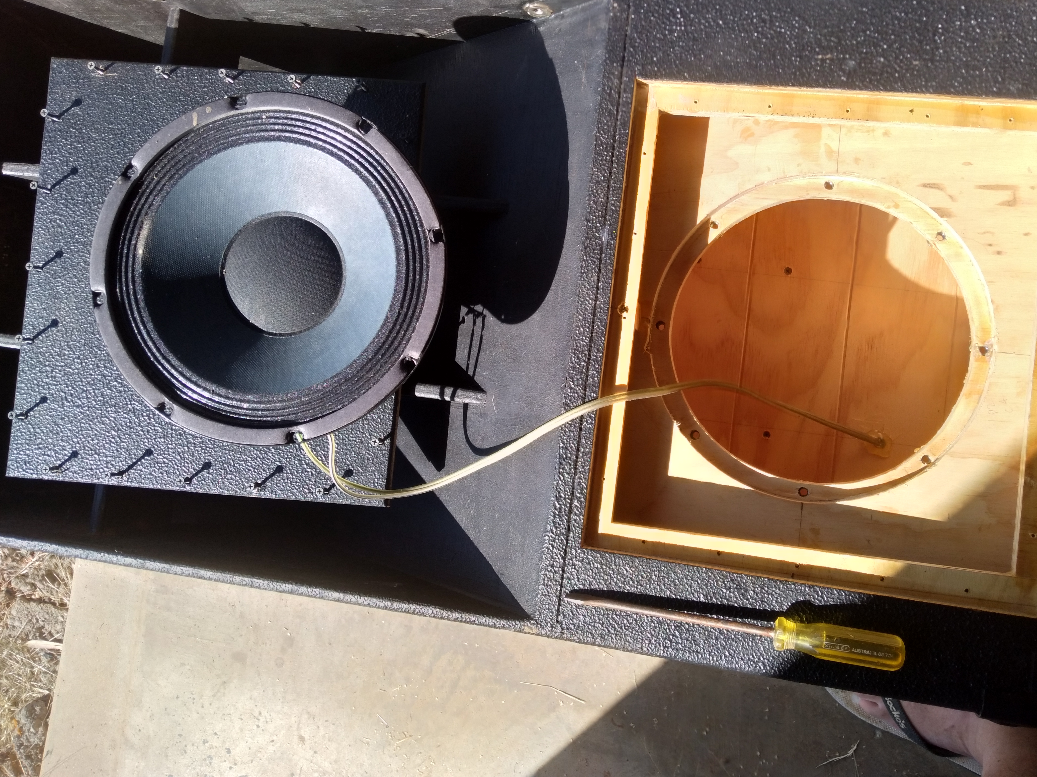

Radical Surgery.

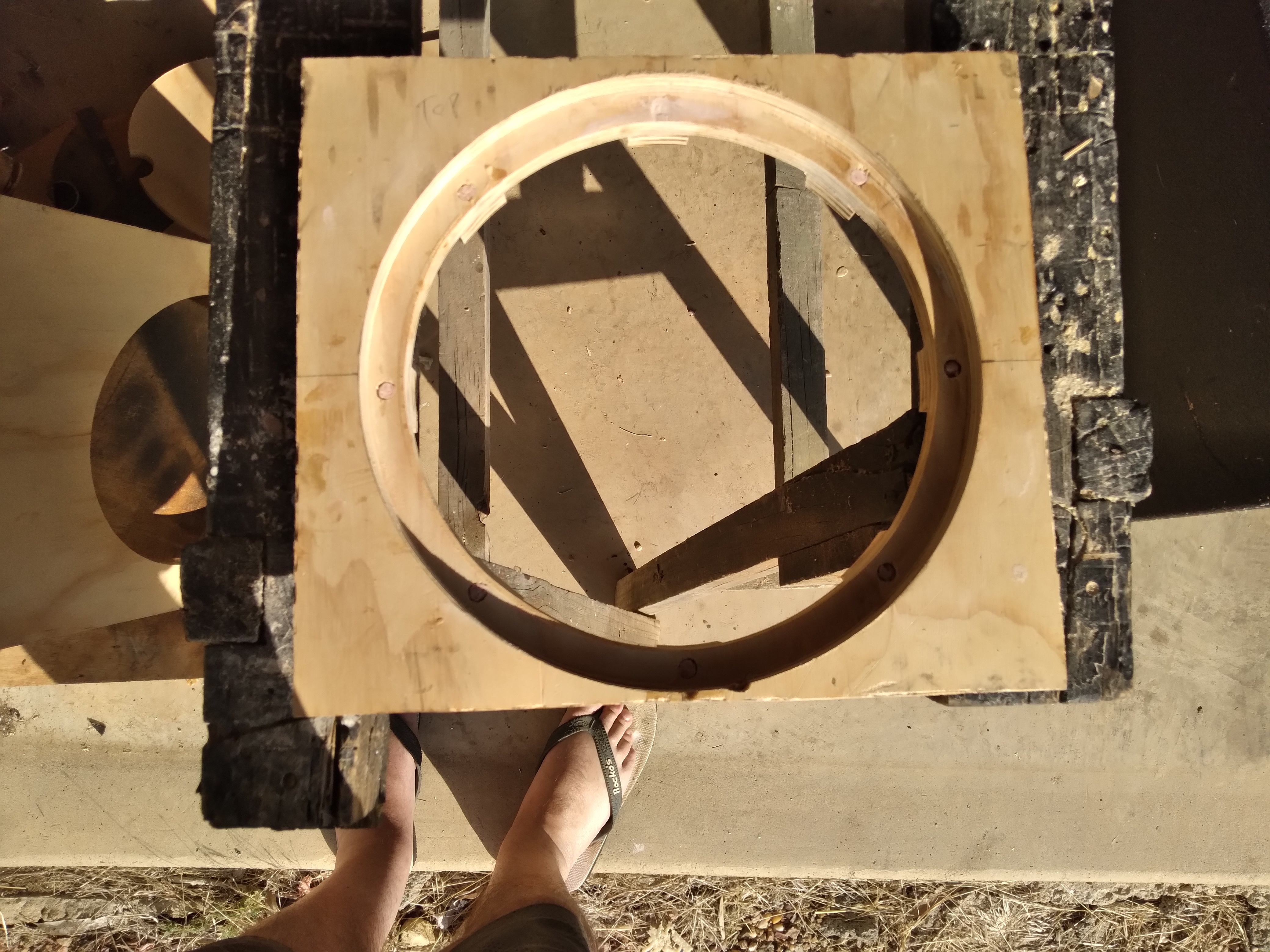

Baffle mod jigs with driver in place. Inner basket top, outer basket bottom.
Pulled driver for the first time in errr ?13years.
My initial plan was to mount the mod jigs with ply spacers that maintained baffle angle and allowed routing.
Measuring and planning, the 3010 basket is about 1/4" larger than the BP102 basket.

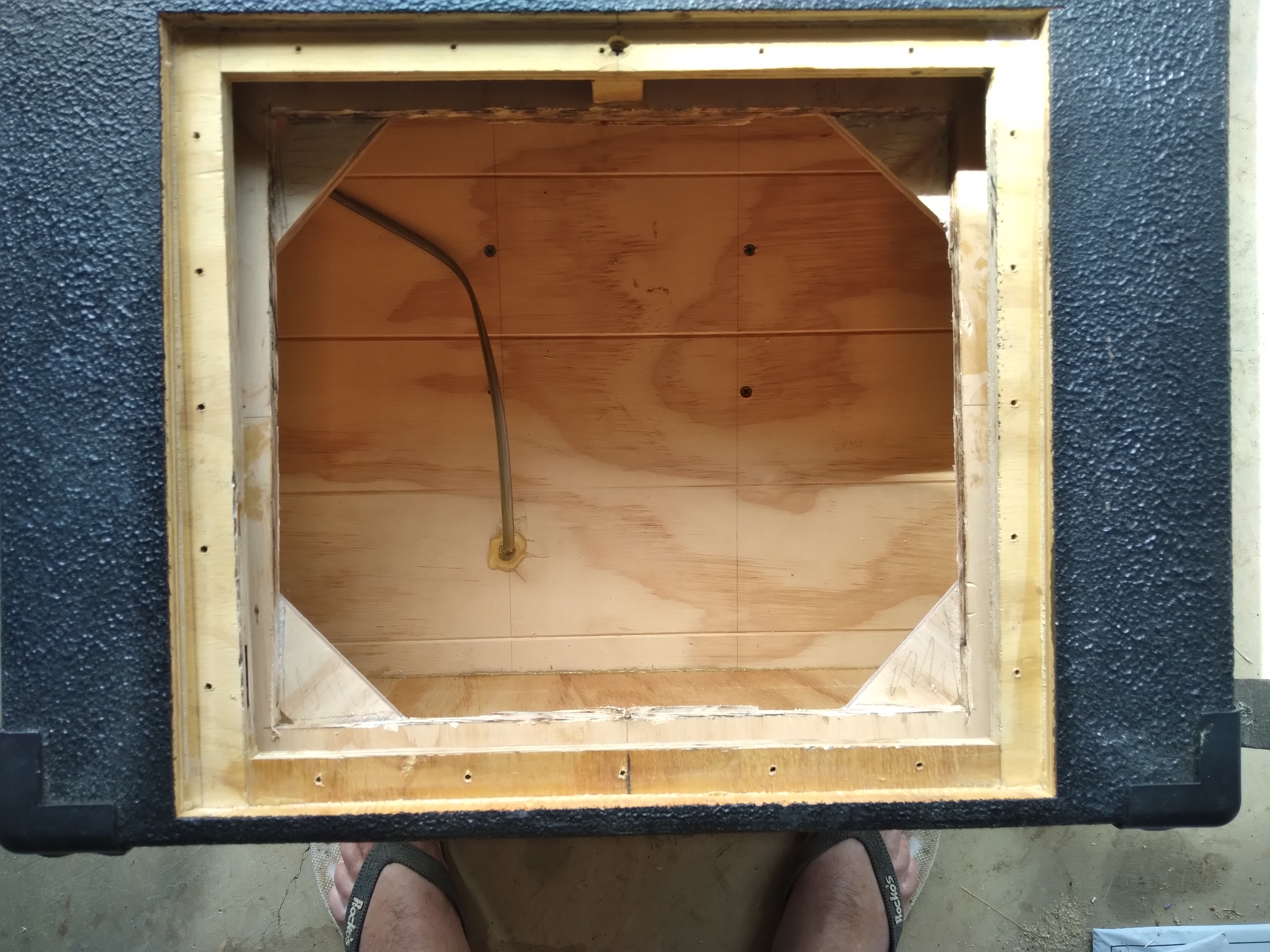

So I knocked out the T nuts (these were built just around the time when recommended driver attachment was soon to become screws)
Don't let anyone tell you that epoxy won't last.
Then made the jigs.

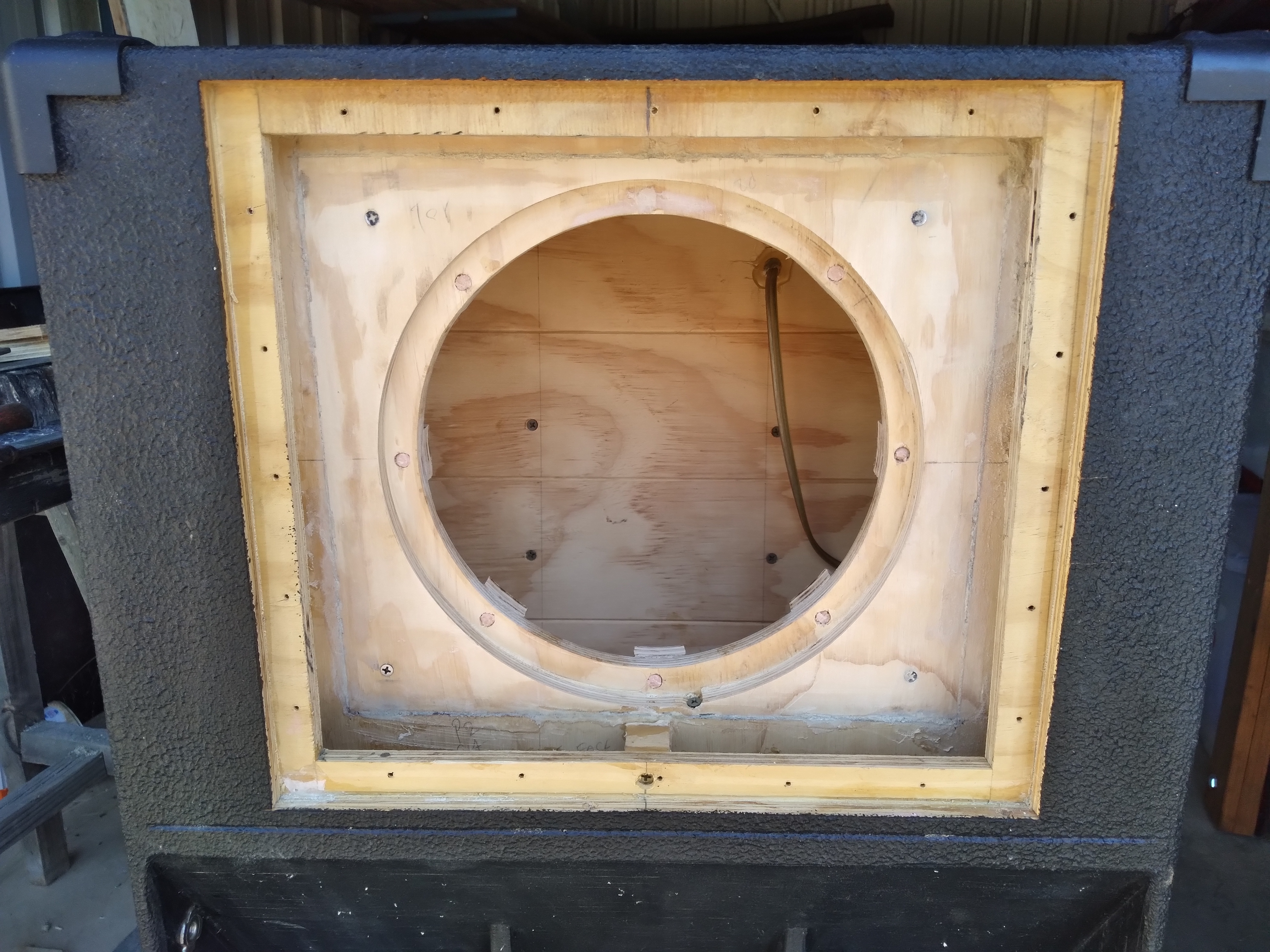

Then I found I couldn't easily locally find a long enough router bit to do the mod.
So plan B became radical surgery.
Cut out the baffle maintaining enough to put it back in.
Added blocks for the first one as I'd knocked out the T nuts.
Added supports, modded baffle glued back in and tidied up some.
Cab 1 of 4 is done provided it passes all leak tests etc.

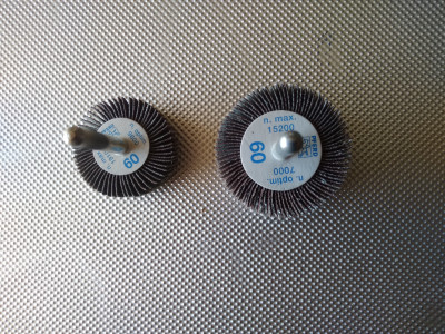

I didn't have to cut the baffle out for the last 2 cabs.
I found these circular 60 grit flap disks, which let me enlarge the driver spacing without removing the baffle.
For this revision, I nominate them MVT:
Last driver in after leak test:
The dust cap on the KL3010LF sits proud by 9/16" compared to the BP102, so I trimmed 3/8" off the access cover brace for clearance.
Done!
