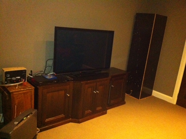

OK, chamber now caulked...plus a small bead of silicone around edge. Also, increased courseness and size of screws.
Sub now placed in corner firing up. My ceilings are tall, so I'll increase the hieight of sub, and/or turn it around firing down.

Will you paint it now it's not going with the hifi? Could be interesting painting the coating.

Gregory East wrote:Will you paint it now it's not going with the hifi? Could be interesting painting the coating.
Two options.
1. I will adhere the cabinet with 4mm MDF, in order to have it painted....in matching darker green as per wall colour.
2. build a frame around the sub and gyprock it in, then paint new gyprock wall and fit new skirting/cornice.
Greg, what's been your best understanding of placement of sub...eg firing up or down...also distance to floor/ceiling. At the moment, the distance from outh to ceiling is too high, eg 4 foot...although the sub really rocks.

It will be in the plans. If it doesn't sound any different layed down aimed at corner you could leave it. 4ft shoul be a big cancellation somewhere in the upper range.
