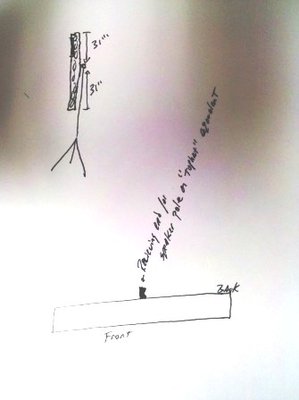

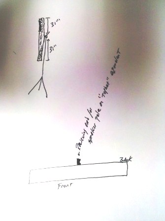

I should have them ready to test today...should. Ive gotta run some nuetriks and mount the baffles...dont and done. Ill worry about the covers next wk. Also, im gonna fashion a tophat mounting system on the back and hang them from standard speaker poles..I att a really crappy drawing just to give you an idea of where im going with it :feedback:

Why not just put a tophat in the bottom and lower the stand?

chenry,
I don't know about your cabinets, but mine are relatively heavy and top heavy. Since they're tall and slender the cg is high.
Mounting the tophat in the bottom of the box would likely not provide enough upper cg support to keep it from tipping. Locating it at the midpoint (like you're planning) would help this somewhat.
If you could get the support point even higher, the gravity would help to keep things solid and less likely to tip (think...suspended vs. projected). I don't know if your poles will extend up 6 to 7 feet like you'd need. But if they will then that might be the best approach.

Yeah these boxes aren't heavy but they are too tall and heavey to mounjt hats on the bottom, they wouldn't be secure. Plus I wanna get thee up un the air a little. Chris, reagrding the piezo responce, that filter in the plans works great. It really cleaned the piezos up.they aren't overwhelming and are crisp..I can't tell they are piezos!

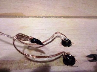

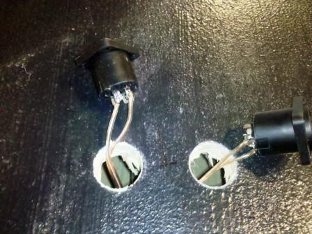

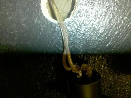

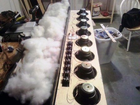

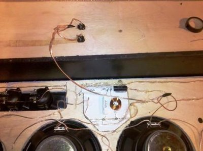

well here are sum pics of todays work. Should be stuffed and sealed tomorrow.

chenry78 wrote:well here are sum pics of todays work. Should be stuffed and sealed tomorrow.
If the coil in your second pic (24.jpg) is for the woofer low pass, it looks a bit smallish to me for a TLAH PRO (although I should add that I have never build one). If it's rather the piezo HP, you can completely ignore this.
Its the highpass filter for the piezos..build to spec.

finishing up, sealed the boxes up today, gonna slap some corners on in the morning and fire them up. My good audio recording device is with the rest of my equipment so I wont have access to it until next week. Otherwise Im gonna try and run some pink noise through them this weekend and rta them...as mentioned earlier in the thread, i will be rta'in them with my droid but I would like to get a more official (accurate) reading. I have an rta mic that came with my drivrackPA and I have a personus audiobox deal so that I can run that into my laptop..but from there I get lost on what to do. Are there any decent free programs or otherwise that I can use to get a respectable reading?
