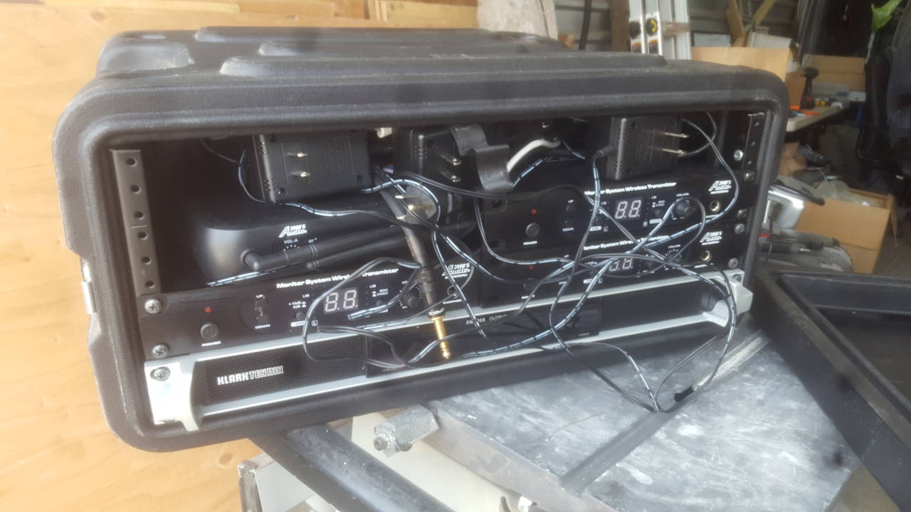

Mr. Owl, I don't have any closets to share with you. However, perhaps a little more gear porn will suffice.

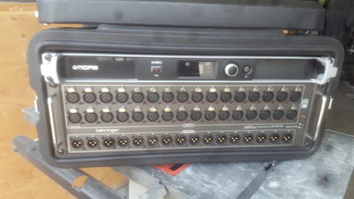

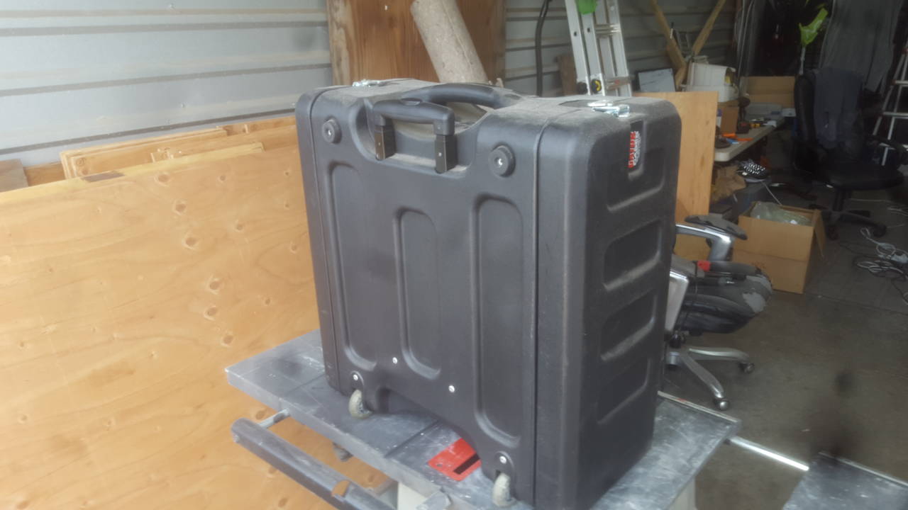

Here's what I have stuffed in one 4RU roller; 32 channel mixer, 32 input/16 output stage box, wireless mic receiver which I use for my talk-back mic (I can talk to the whole band or individual musicians in full duplex audio(like a telephone), pretty much any time when they're on IEM's), 3 IEM transmitters with room for one more (I use one for myself, the others are for the band, they are all mixed in stereo to help produce a spacial sound, less in the head), the 2RU Klark Teknik module under the IEM transmitters is a digital output box which get's a CAT5 input from the mixer and outputs 8 channels of balanced audio which I have wired to the IEM's. I've found a power converter that will allow me to just have one "wall wart" to power all the smaller transmitter/receiver units. That will be nice to eliminate the weight, bulk, and untidy birds nest of power wires. There's still room for 2 more IEM transmitters, waiting for the need or good enough deal.
At some point, I'd like to have a separate IEM rack, probably a soft sided rack bag. That way I can put the stageI/O box where it will be the handiest and put the IEM transmitters where they will work best (as far as transimssion/reception quality) and just run a CAT5 to it's location from the stage box. And, if no one is on IEM's I don't have to tote it to the gig.
Anyway... Enjoy

Hiya Seth
That's very economical packing I must say. Very efficient packaging. :clap:

I forgot to mention that I'll be putting a mini PC in there too, with the main purpose being multi track recording of performances. I used to have an expansion card in my mixer that recorded all tracks on an SD card, but I replaced that expansion card with the Dante Audio Networking Card. It should be easy enough to just run the Dante Network to the PC and record it into a DAW (I use Reaper, but any would do fine... ProTools or whatever). I run all my gigs from laptop or tablet (even used my phone once for a solo act) and can just use the remote desktop app to operate the mini PC without it having to have it's own dedicated monitor, keyboard, and mouse. Pretty cool if you ask me.
All of the connectivity that case needs is mics/instruments in the front, power, and 1-3 CAT5e's out of the rear. That's it. Super simple set-up.

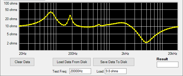

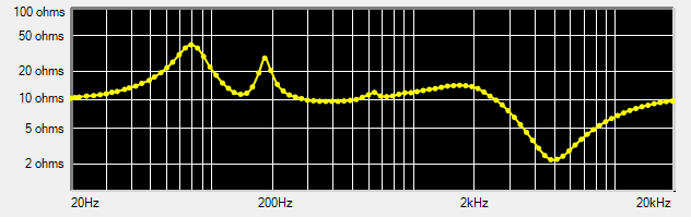

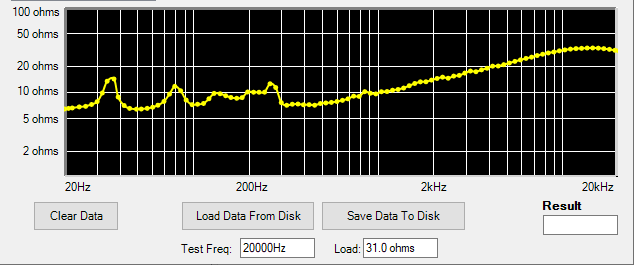

Just ran some impedance sweeps on the Titan and pair of SLAP's paralleled. Does everything look as it should? Is the 2 ohm dip at 5K on the SLAP's all good? Just as a side note; I used a 4.3Ohm resistor in place of the 4 ohm called for in the plans.
Two 2x6 SLA Pro's wired parallel (internally wired in series per the plans)
16" Titan 39 loaded with a Basslite S2012 20-20,000 sweep

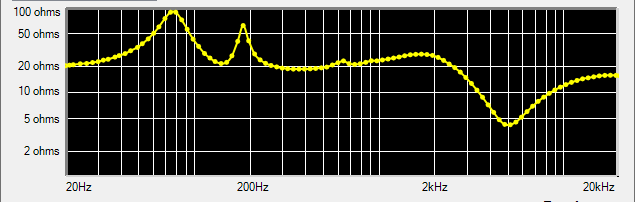

The SLA's separately tested show slight variances, but are essentially nearly identical to each other.
Top
Bottom
Both together

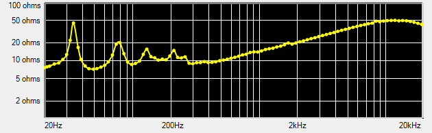

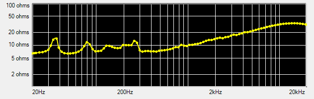

I just put the 3012LF back in. Here's the impedance sweep compared to the S2012. Interesting results, but I have little idea what to make of it.
16" wide T39 3012LF
16" wide T39 S2012

SethRocksYou wrote: Sat Apr 11, 2020 4:03 pm Interesting results, but I have little idea what to make of it.
I don't really understand what use an impedance chart would be to the end user. I'd be more interested in the frequency response.
Maybe one of the more savvy folks could explain the importance of the impedance chart to the user as opposed to a designer?
I agree. The function is built into the amplifier and is supposed to (I guess) indicate blown speakers or something. Otherwise, I think the peaks are indicators of the resonant frequencies and can be compared against intended design performance goals. I am a little curious about the 2ohm 5k dip and if it's within expectations though.
