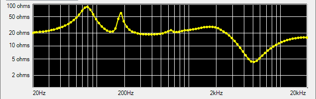

Just ran some impedance sweeps on the Titan and pair of SLAP's paralleled. Does everything look as it should? Is the 2 ohm dip at 5K on the SLAP's all good? Just as a side note; I used a 4.3Ohm resistor in place of the 4 ohm called for in the plans.
Two 2x6 SLA Pro's wired parallel (internally wired in series per the plans) 16" Titan 39 loaded with a Basslite S2012 20-20,000 sweep

I don't really understand what use an impedance chart would be to the end user. I'd be more interested in the frequency response.SethRocksYou wrote: ↑Sat Apr 11, 2020 4:03 pm Interesting results, but I have little idea what to make of it.
Maybe one of the more savvy folks could explain the importance of the impedance chart to the user as opposed to a designer?

I agree. The function is built into the amplifier and is supposed to (I guess) indicate blown speakers or something. Otherwise, I think the peaks are indicators of the resonant frequencies and can be compared against intended design performance goals. I am a little curious about the 2ohm 5k dip and if it's within expectations though.Bruce Weldy wrote: ↑Sat Apr 11, 2020 5:16 pmI don't really understand what use an impedance chart would be to the end user. I'd be more interested in the frequency response.SethRocksYou wrote: ↑Sat Apr 11, 2020 4:03 pm Interesting results, but I have little idea what to make of it.
