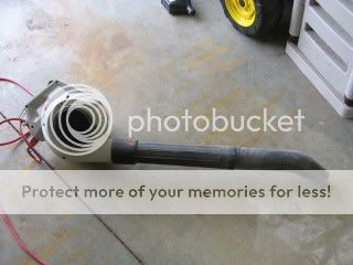

pwfirst wrote: My shop is a little dusty and I need to do a little light dusting.
Auurrraah! The old Binford 2000 Shop Duster. I assume you did the 20 amp motor upgrade?
Dennis

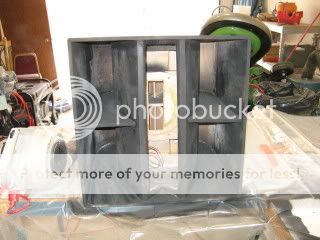

pwfirst wrote:Hi everyone, I am in the final steps. I have primed the joints of the cabs and with some final sanding the duratex is next.
What did you prime with?
Best shop broom ever. That's how I do mine, when it gets about ankle deep. :clap:
Also works for blowing sawdust out of cabs after completion.

LelandCrooks wrote:Also works for blowing sawdust out of cabs after completion.
+1. The first time I blew mine through the throat of an unloaded DR250, I got quite the shock when everything that was inside the horn blew right back in my face! :lol:

Ya I should have vaccumed it out first, Im still spitting saw dust,
I primed it with a flat black primer from rustolium. I'll let it dry over night in a heated room. and then the duratex.
By the was the duster is two speed.

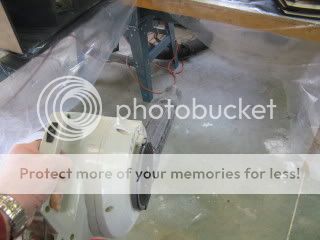

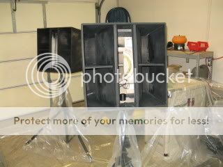

Well, I have just done what now man has done,except for you guys, coat#1 of duratex is on.
After:
It was much easier than I expected. I read all of the links and suggestions. Thanks to everyone who helped.
35 on the compressor, smallest nozzel and light first coat. It goes on quick so watch it. I used a spare piece of wood to get the stetting. Trigger opening is a little less than half way on the gun, Short trigger plulls and keep the gun moving! I'll put the finish coat on when it is dry,, Just passing time watching paint dry. Phil
DR 250's #2
T39's 14 in with 102 #2
pwfirst
Posts: 147
Joined: Tue Jan 27, 2009 8:11 pm
Re: Newbe starting my DR 250
#60 Post by pwfirst »

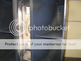

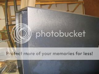

The breaks is over, the final coat is drying. I am sooooo pleased with the outcome. This coverage is great the tecture is consistant and it looks :loler: professional. I'll give it a day to dry and start the assembly, I want to hear these boys.
It dried for about an hour before putting on the 2nd coat. I put on a thicker coat making sure every inch was covered. Painting these on a speaker stand was handy I stood in one spot and just spun the cab around. Good light and the same perspective made it easy to get each surface all the same. There are no cracks or separation any where. I think they are keepers. See you guys in a couple days with assembly pictures Phil
