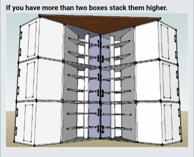

More asking if when running 6 cabs, whether there would be a noticeable difference in output between stacked with the V-plate like this
Or set up next to each other in a line when l dont have help setting up. l was guessing with two cabs yes, but not a large difference with six.

Stacked gives more efficient coupling of the individual cabs into one larger source.

Bill, I forget at what point the v-plate offers no benefit... was it 8 cabs?
Posts: 29149
Re: OTop8 dispersion angle and Bi-amping
#55 Post by Bill Fitzmaurice »
I wouldn't bother with more than six.

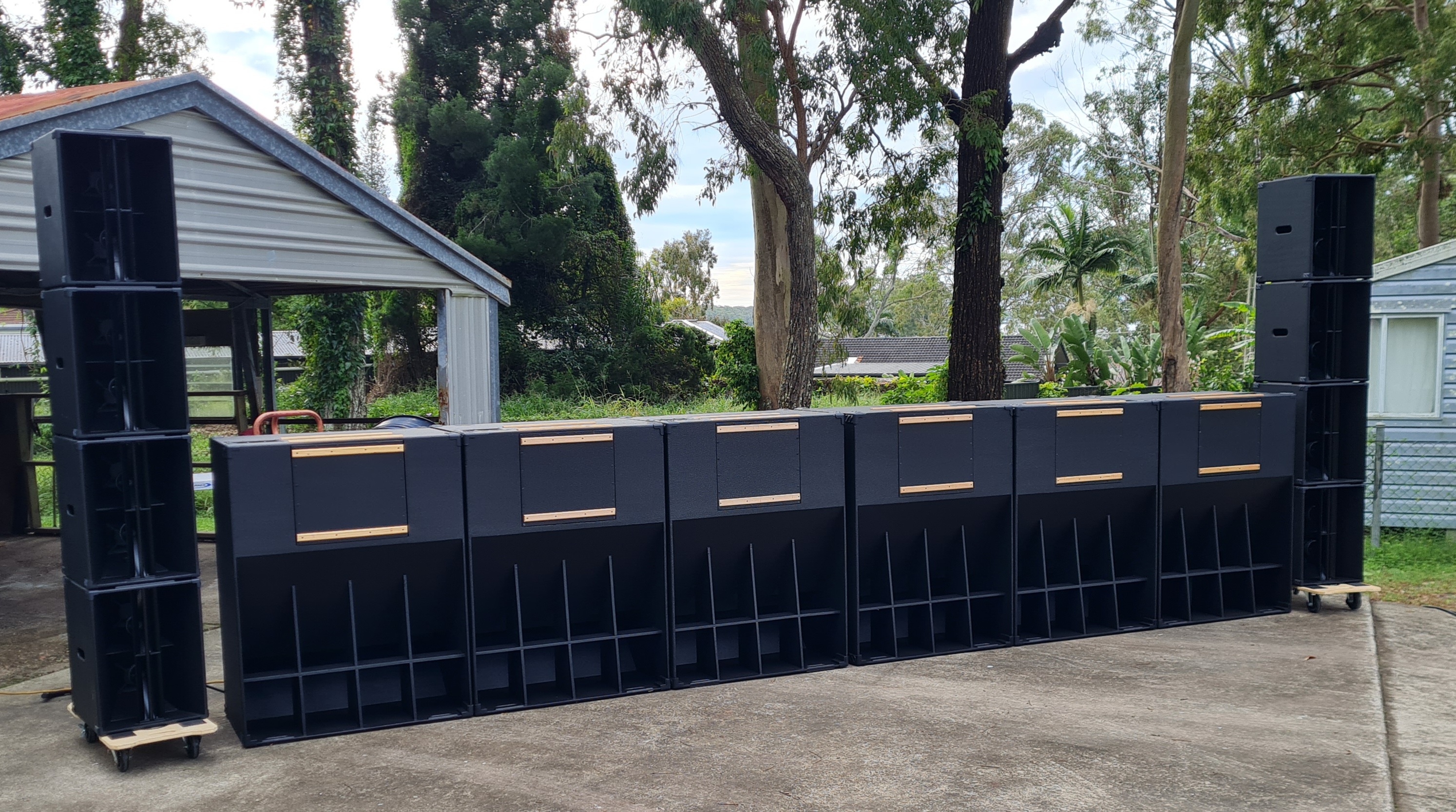

Today there was a reprieve from the rain, so this happened finally.. :D
Just myself for setup, as it's a Monday, next time there'll be help to stack & V-plate. It's not like I'll be looking for more bottom end though. My mate visited for a listen & we ran it up to just barely brushing the limiter with a Psy Trance track & we were both astounded with the strength of Bass.. & we were standing 90ft away :shock:
The system was faced the opposite direction from my sons bus stop, which is 0.6 of a mile away, & they could hear Van Halen clearly when they stepped off the bus, with the fader at 60%. The OT8s are silky smooth all the way into ridiculous volume levels,
We ran four Psy tracks loud & the 10 amp breaker didn't trip... very happy indeed!

:hyper: :hyper: :hyper: That looks amazing! Wish I could hear your rig.

Now that is impressive!!!

Awesome! :clap:

Keryn, that looks so darn good. Everything square, symmetrical, evenly spaced, and identical from cab to cab. Ultra professional. I'm super impressed. It's been a long project, congratulations on completion and a successful test run!
Which amp/s did you run it all on?
