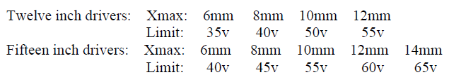

I'm not sure what year your plans are, but my set from last year has this as the voltage limit recommendation:
There's no official voltage recommendation for different high pass frequencies, other than the one stated above.
The recommended high pass frequency is (as stated in the plans) "Groups of less than four cabs should be high-passed at 40 Hz. With four cabs or
more 35 Hz is acceptable"... same voltage limit.
I'm thinking somewhere around 50v would be sufficient.

I have 2013 plans, which talk about the LAB/LF drivers at 60v, though that table you referenced must be in later plans.
I'm glad to learn how impedance doesn't enter into limiting, l missed that in the forum discussion.
50v it is! Thank you.
