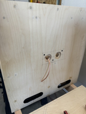

Ok wondering if I made a mistake.
I put a pair of NL4 jacks in the top as well as the back so when the subs are up against a wall, so I've got an easy place to connect them. I put them in the driver chamber thinking easier to wire them up. It was.
The 1st sub is now closed up and I tested it. In my 1500 sq ft shop at 50v this thing was killing me. Dang it's loud! I can't wait to hear what the whole herd sounds like together!
But those two jacks in the driver chamber have a lot of air leakage around them no matter how tight they're screwed down. Lot of air pressure in that driver chamber. Would it have been better to locate them behind the driver chamber in-between it and panel 9? I think there's room there. Haven't cut the holes or closed up the other 3 subs yet so I could do that with them.
FWIW I plan to judiciously caulk the jacks in the final installation (cabinet is not yet painted) or maybe I'll try some gasket material behind the jacks. Curious what others do. Maybe this is normal and the caulk will take care of it. Thought I'd ask before going further with the other cabinets.

Putting jacks in the driver chamber isn't a good idea, the pressure there is very high. Placing them in the horn path is better as pressure there is much lower.

Ok thanks for confirming Bill. I feared that was the answer. I'll do that in the other three cabs and chalk this up to another learning experience on the first cab. On this one I may PL the jacks in and take the risk that I'll never be able to remove them. They're accessible from behind the driver if I ever needed to fix a connection.

Re: 4x T48 and 4x OT12 build
Would you consider removing them, filling in the holes (cut out a patch and place in behind for a good seal), and relocating the jacks in panel 6? The repair will be covered with Duratex?dlv wrote: ↑Mon Aug 26, 2024 6:50 am Ok thanks for confirming Bill. I feared that was the answer. I'll do that in the other three cabs and chalk this up to another learning experience on the first cab. On this one I may PL the jacks in and take the risk that I'll never be able to remove them. They're accessible from behind the driver if I ever needed to fix a connection.

I usualy put gasket tape on the back of speakon Jacks, although I haven't tried putting them in the drive chamber.
If your jacks are far enough from the driver, there may be room to build a small dog house behind the jacks to seal them from the main chamber.
Oh I like that idea! I'm still gonna follow Bill's advice and put them in the horn on the other 3 cabs but that might work to fix this cab. I believe there is room for it. At least I'd be able to remove the jacks if I ever needed to replace one. Thanks Kevin!Strange Kevin wrote: ↑Tue Aug 27, 2024 2:57 am If your jacks are far enough from the driver, there may be room to build a small dog house behind the jacks to seal them from the main chamber.
