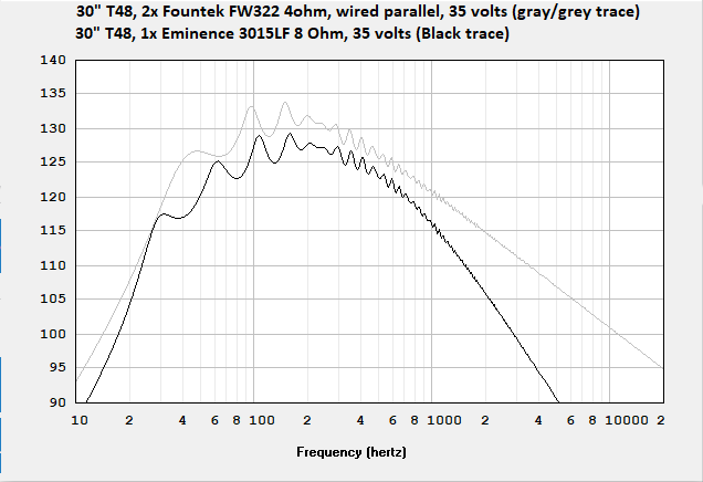

As a side note, part of the goal, if he chooses the dual 12" route, is to find two 12" drivers that cost about the same as one 3015LF.
I'm not sure how tax and shipping works over there but I've found the Fountek FW322 4ohm driver on UK sites between 119€ and 146€
I ran a pair of Fountek FW322 4ohm drivers in parallel in my not-exactly-right 30" T48 hornresp model against a single 3015LF, both on 35 volts and this was the result...
Thoughts?

Bill Fitzmaurice wrote: Tue Jun 06, 2023 12:44 pm I wouldn't go down the 2 ohm road.
The 12v automotive amplifier he has is rated for a 1 ohm load. And if he ever wanted to run it from a standard mains powered amplifier, he could simply rewire them in series for an 8Ω load.
Additionally, in my Hornresp model of the T48 (admittedly, probably not exactly right) that driver is at it's 10mm Xmax right at 35Hz and 35 volts, so it's a good match to the amp's capabilities and a 40Hz highpass engaged.
Seems to make a lot of sense. No?

Mishkin wrote: Wed Jun 07, 2023 2:38 pm Seth, I could get two off these founteks , either the 4or 8ohm Version, for a nice chunk less than a 3015LF costs here, including delivery and tax.. :)
Like I said before, if there's a chance this cab could become part of a larger multi cab system in the future, my vote is the 3015LF. Four 30" 3015LF loaded T48's will play to quite a crowd and be reliable if properly limitted and high-passed.
And if the Van/bicycle system is likely to be the end game for this cab, I personally think the 4Ω Founteks will suit you really well and not require you to also upgrade the amp to get the most out of them. Save money on the drivers, save money on the amp, invest it in the Dayton Audio DSP-408, and you'll truly have a kick ass system with amazing sound quality once it's all tuned.
