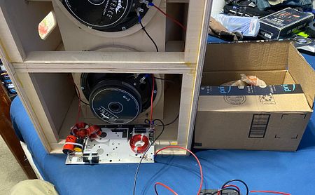

Okay I am almost done with the wiring part of the first Otop 8. I am following the diagram that Seth drew up
for me above. I believe I have those connected properly. I am at a mini-stop as I believe I know what I need to
do but I need to confirm with you guys first. I see in Seth's diagram where one set of the wires to the amp get
connected. Am I correct in thinking that the remaining pair of wires get connected as so: The remaining positive
wire gets connected near the upper-mid right of the diagram near the two zip-tied capacitors and the left over
positive is connected near the bottom using the spare positive terminal to the left of the inked line. Thanks for
any help you guys are able to provide.
Here is the stage I am at on the first one:
Please point out any issues you might recognize and as always any advice is appreciated.
Also remember you can right-click and open in new tab for full-res image. Thanks

You only need one pair off the back of the terminal cup which go to the crossover. Cut one pair off.
Re: Otop 8 future build
Posted: Tue Jan 11, 2022 7:37 pm
by Seth
Also, it looks like you have the drivers wired in series for a 16ohm cab. Are the component values in your crossover also for 16ohm wiring?
I initially thought they were 4 ohm crossovers due to the paralleled capacitors on the Highpass portion of the crossover circuit. But, it was only an assumption. Can you tell me the value on the capacitor circled below?

Seth it's a 33uF 100v

Yeah, that's the 4ohm crossover. You want to wire the woofers parallel as shown on page 25 of your plans.

Okay I am looking over page 25 and 26 of the plans again to get a better understanding. As far as my connections and when I remove the extra set
of cables to the speakon cup will I stll be able to pass-through a sub. I decided to leave the 1/4" connections un-attached at this time as I decided
to keep it simple, but if you say I can run the extra pair to the 1/4" connections I might just go ahead and connect them. Am I running the +/- wire
to just one side of the 1/4" connectors and leaving one unused?

I can't say 100% without being able to read the markings on the SpeakOn jack, but if you're wiring them per the plans, the leads you have coming off are connected to terminals 2 positive and 2 negative on the back of the SpeakOn. The two that just jump across without any leads coming off are the pass through siganal and should be connected to 1 positive and 1 negative.
Yes, the sub signal will still pass through.
The reason you have two extra leads is, in the plans the two crossovers (one for the tweeters, one for the woofers) are made on separate boards and the two sets of leads would go one to each crossover. But, the crossover you got from Leland has both crossovers on one board, so it only needs one input from one set of leads. You did a great job wiring your terminal cup exactly as the plans show, you just only need the one pair in this situation though. Which may ultimately work out well for you...
Run the positive to the "tip" terminal on one of the 1/4" jacks and jumper over to the tip terminal of the other 1/4" jack. Then run the negative to the "sleeve" terminal of one and jumper to the sleeve terminal of the other. If it's unclear which terminal is which, the one closer to the metal mounting cup is the "sleeve" terminal and the one furthest from it is the "tip" terminal.

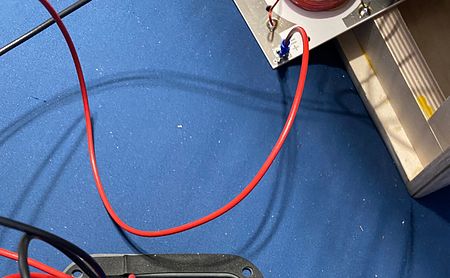

Okay here is the speakers re-wired in parallel. I believe I did it correctly this time.
I did both the compression drivers and woofers this way.

And here is an image of the cleaned up wiring. On the plate as your looking at it it is in the
same orientation as in the plans with the 1+ terminals at the top.

Seth is this correct for the 1/4" jacks connection.
Posted: Tue Jan 11, 2022 10:46 pm
by Seth
kenkenni wrote: ↑Tue Jan 11, 2022 10:37 pm
Sure is. Well done.
