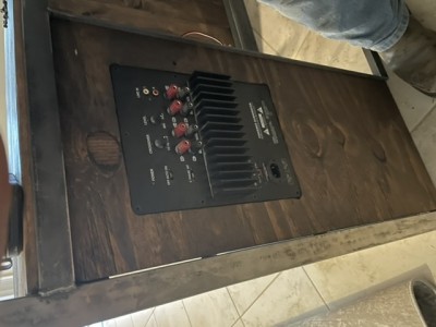

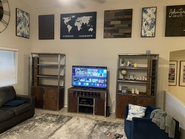

I have completed my home theater and entertainment center system. The table tuba has been completed. By design the subwoofer mouth sits exactly 12” off the wall and the driver opening is 3” off the wall.
I have more low frequency output than I will likely ever use. It’s nice. In hind sight I should have only deployed 8 tweeters per Tlah cabinet.
I could hardly ask for more for what it cost me to build this and the joy I have building the rig worth every second!

Damn, that's nice! Very ingenuitive way to deploy a sub!

ACUA, that came out great! Good job man! Very impressive
I'd be curious to hear a little about how well the rest of the TT build went. Was it a PITA? Go together as planned? If you did another, are there any changes to the process you'd make?

Your system looks great! I'm sure you will enjoy it very much.

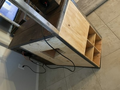

As far as my Table tuba goes, this came out the most square horn I have built yet, partly because this is the 10th one and partly from the dados. I had to widen the dados to the last panel effectively the side by just about an 1/8in with some minor router adjustment here and there to get it to fit nice. I actually glued the final side panel on before glueing the external panel walls one so something like panel 9-11. Because I was dropping those final external panels between the dadoed grooves of the sides it was easy to do this way. While initially gluing the two sides I clamped the external panels to assist with trueing and figment. Then once the glue had cured I was able to remove the external panels and one by one install and glued them and add the proper bracing. I did use a lot of glue for the extra wide dado of the final side panel but it was easy to test fit everything into the dado groove before actually applying glue so when it came time to glue it was a quick and not to dirty process. Most of the 1/8in oversized dados were split between the panels and the remaining 1/16 gaps easily were filled with PL glue. The process is not fool proof and I had to do some elbow work and router trickery but for me it was worth it. The dados make panel alignment so much easier, I did some dadoing where the internal panels are are 90degree angles and that really helped. I may not dado the final side in future builds to save time but I doubt I will ever not dado the first side as it really really helped me along.
I own an electric hand planer and I did have to shave around 1/32in off some corners to get the sub to fit my shelf structure. This because the absolute square-ness of the two parts was not complimentary. I recommend Ryobi, for the planer it’s only $80.00 us where the competition is like $120-150. Just be sure to true the blade!!! This tool helped me get the wood to fit the steel structure easier as all my tools are hand held

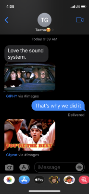

If this picture comes through, this is what my wife texted me today about the system!!!

That's great that your wife loves the system! Kudos! It's good, too, to have a friend like Radian.

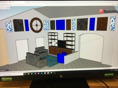

My wife and I started to lay the ground work for our home theater system back in October of 2020. Attached is a SketchUp modeling of our living room as we wanted it. We were trying to figure out how to decor the high walls and deal with the highly reverberative nature of the space. We settled on what you see. I built the panels with acoustic padding but cloth covering. The panels can semi easily be removed and different cloth could be affixed for a different styling should we choose. In the end throw pillows were made using the same material as the panels as a cool decor correlation. The clock is a piece I am proud of. It is 5ft in diameter and has to weigh every bit of 90lb. The wood is reclaimed pallets and many large screws into the wall studs.

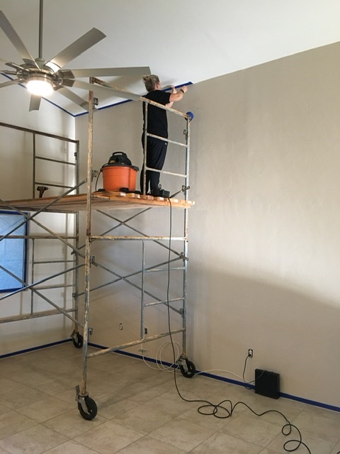

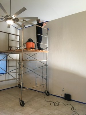

Shown is also a picture of us with scaffolding painting and laying to ground work for the wall panels. Today just over two years later we seem to have realized our vision, even the couches were purchased to match our initial sketched vision.

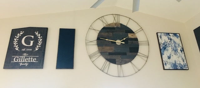

Well done on your project!
Nice job on the clock, too.
How did you get your wife to work on the scaffolding? No way would my wife do that...way too high.

The scaffolding was cumbersome but way safer than trying to use ladders. Luckily I had access to it as it made the work so much easier. My wife has her flaws, but fear of heights is not one of them. She gets aggressively involved when she knows my lack of detail or patience is going to get in her way, she insisted in doing the masking job before painting, and for good reason too.
