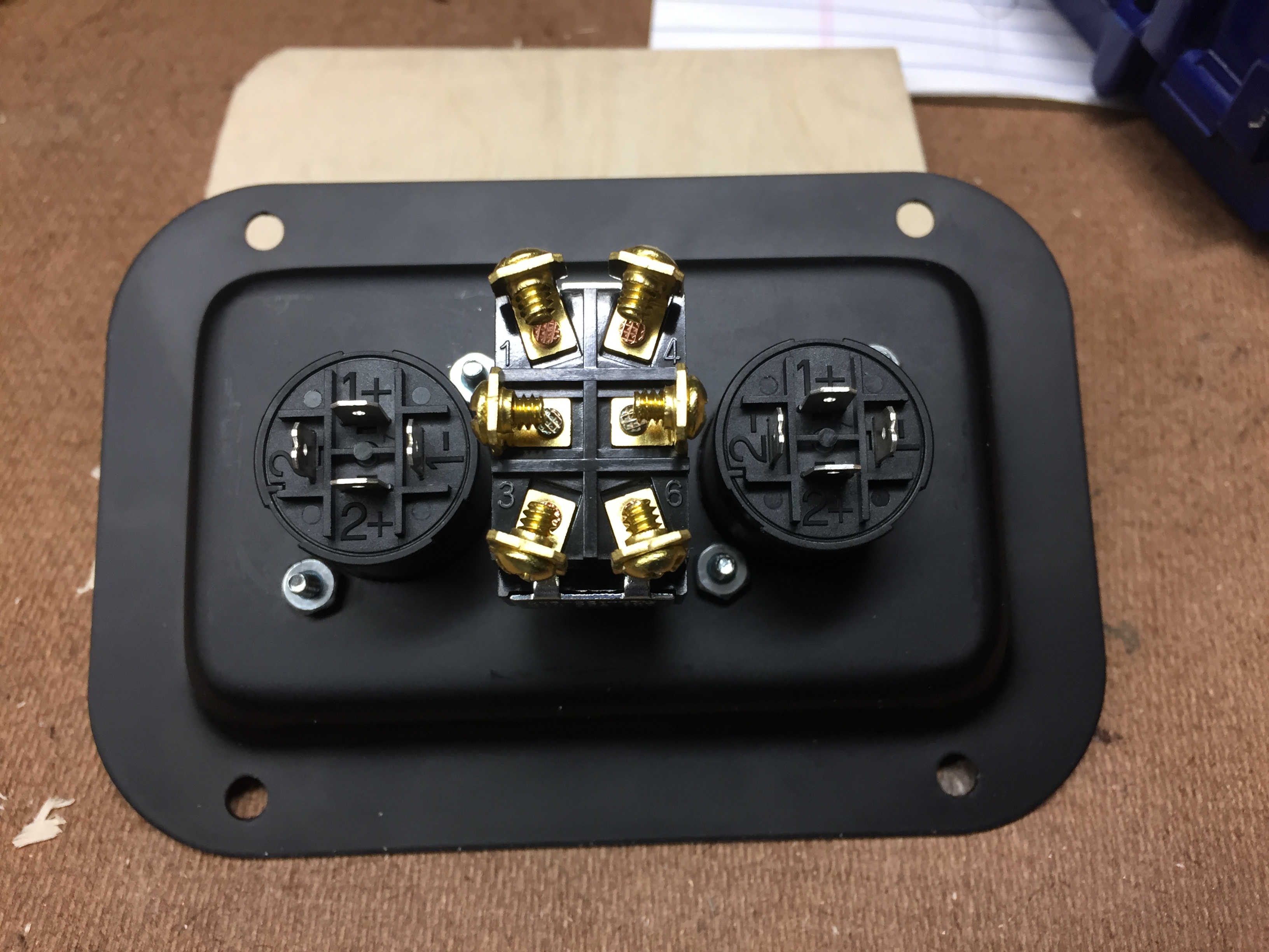

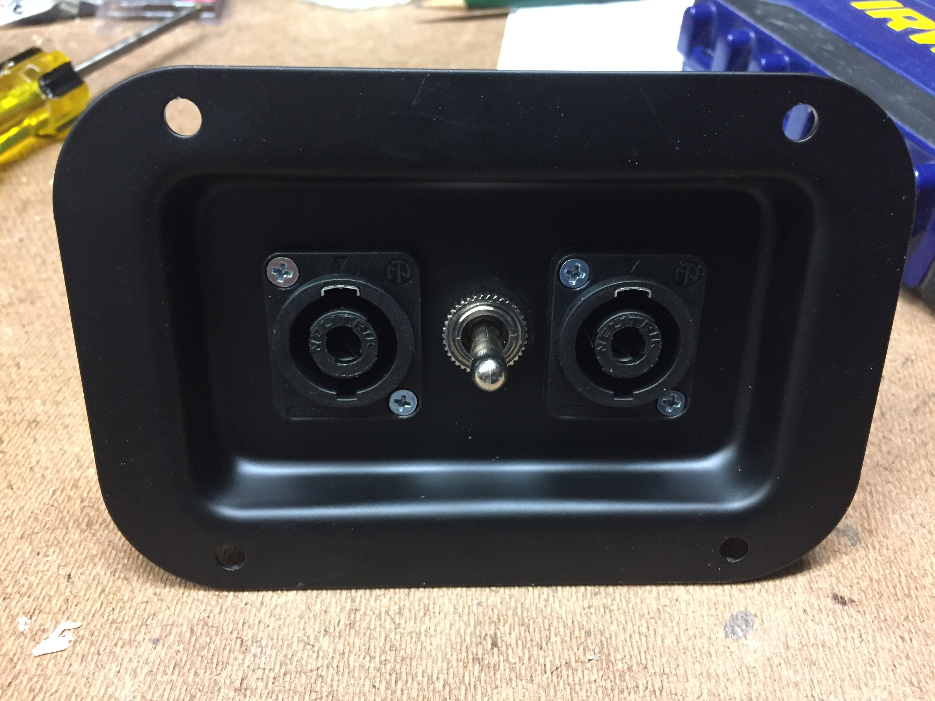

Ordered the switch I needed from Amazon.....got here this evening, so I spent a few minutes putting it in the jack plate. I've decided on my wiring scheme.....
Up - With Sub. the power will be routed out of the left speakon. That will feed the T24 and return after the passive crossover in the T24 back to the right speakon which will go to the SLA passive crossover and the woofers.
Center - OFF
Down - Without Sub. Amp it sent to the woofers and crossover of the SLA.
The SLA can also run in passive mode by plugging in a power amp to the right speakon.

Bruce Weldy wrote: Wed Nov 25, 2020 3:08 pm Thanks again for the suggestion.
You're welcome. Almost didn't mention it. Glad I did and happy it's going to help you out Bruce. Switch and jack plate looks great. :thumbsup:
Bruce Weldy wrote: Sun Nov 29, 2020 7:21 pm ...Up - With Sub. the power will be routed out of the left speakon. That will feed the T24 and return after the passive crossover in the T24 back to the right speakon which will go to the SLA passive crossover and the woofers...
Are you going to run the tweeters with the High Pass channel in the amp? I can't think of any reason not to.

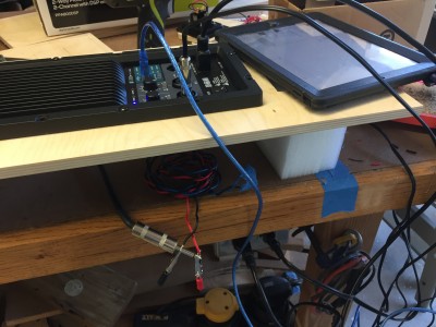

Started doing some of the little things that just have to be done prior to getting out the glue. Lined up the jack plate and drilled the pilot holes same with the amp.....
While I had the amp sitting in there, I decided to test that thing before going any further because the enclose quick guide said that the LOW side amp had a hard low pass at 3k....WHAT!!!!????
Looked at the date on that guide - 2016. Came in and brought up the manual online....from 2018. There is no set low pass. So, I rigged it up to test with my garage system - note the high tech alligator clips holding the amp output wired to the speaker cable (yes, it's 1/4" - that's all the old Peavey has).
Hooked it all up and there were no highs at all.......
Next step - get out the laptop and download the software. Did that and hooked it up - came up fairly easy. Sure enough, the thing was pre-set with a low pass on the LOW side. Cranked that up to about 16khz and all was good. Played with the EQ some and figured out how to save them. That will be useful to have different EQ setting based on whether I use 'em stand alone or with the sub.

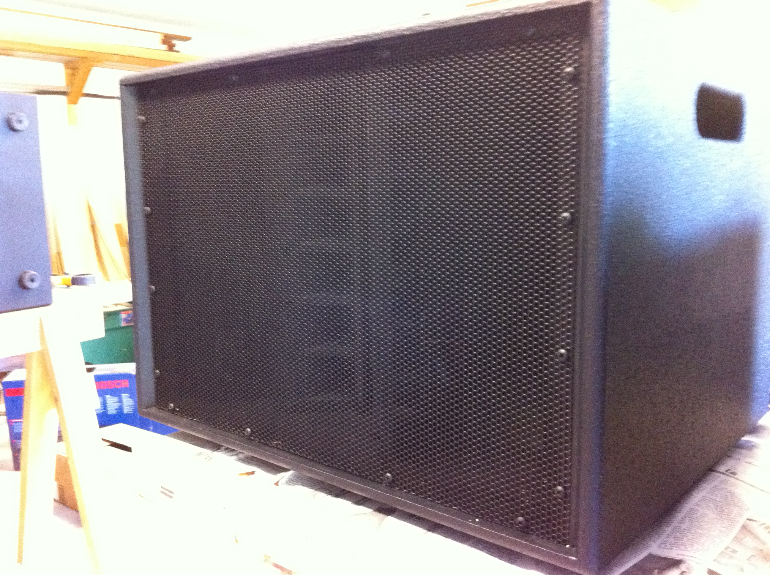

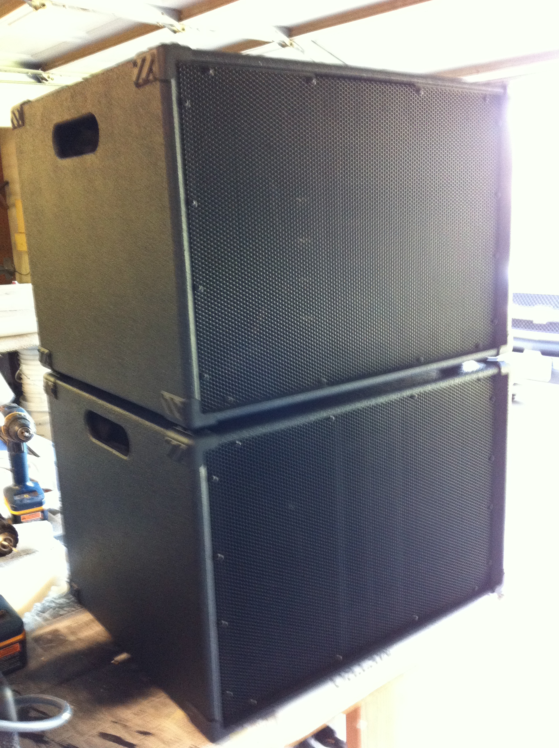

SethRocksYou wrote: Fri Dec 04, 2020 6:27 pm After bending one grill for a 2x6 SLAP, I decided short of having a sheet metal brake, the results are not worth the effort and started investigating other options. On the next grill I do, I'm just going to cut it to size, put plastic edging around the perimeter, put it on stand-off's, and see how I like the result.
Here's the plastic edging I ordered. It has an adhesive strip built in. :fingers:
I've always just used flat grills with about 1/16" clearance all around and no edging is necessary. Once you put a foam backer behind it - it looks great..
