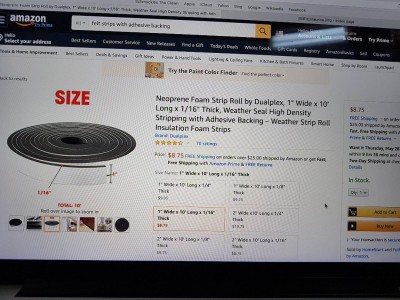

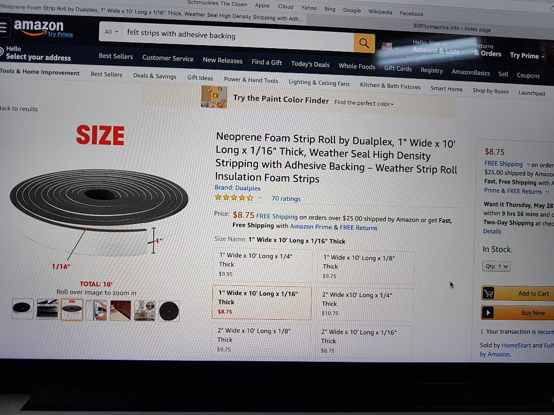

Have you used this to seal the cab from the back panel door? I have used 1/4" window foam weatherstrip plus rope putty to seal but when you screw the panel in, the door sticks out. Will this be enough to avoid leaks, its neoprene so kinda spongy. Thanks :idea:

Not sure if it'll work for you, but I use this to seal drivers and doors/panels/etc.

Looks the same as the window weather strip foam, thanks i will try it

Make sure that it is, indeed, closed-cell. Neoprene is available as open-cell which is not the appropriate material for these uses.
