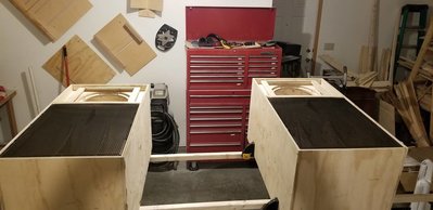

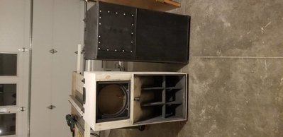

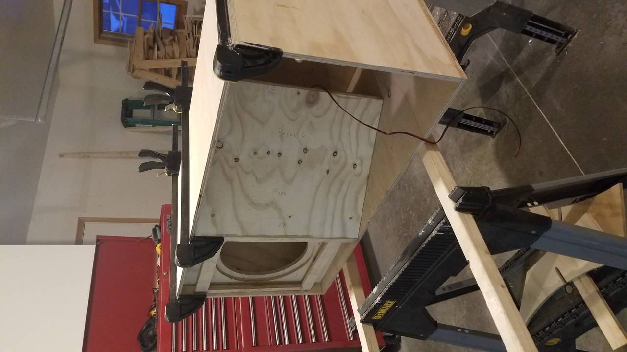

Got bored today when the family all decided to disappear and play with their new stuff, so I went in the garage and made progress. Finished the construction on one canlb and almost finished with the last. Before you know it I'll be applying Duratex and testing the whole system I'd like to do that before I go to Turkey for sure.

Those are looking real good Bryan :thumbsup: Nice 'n square... and nice curves on the mouth supports

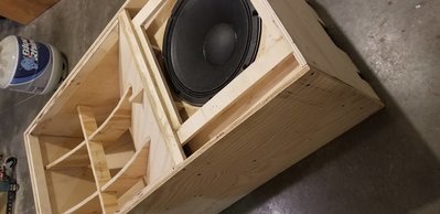

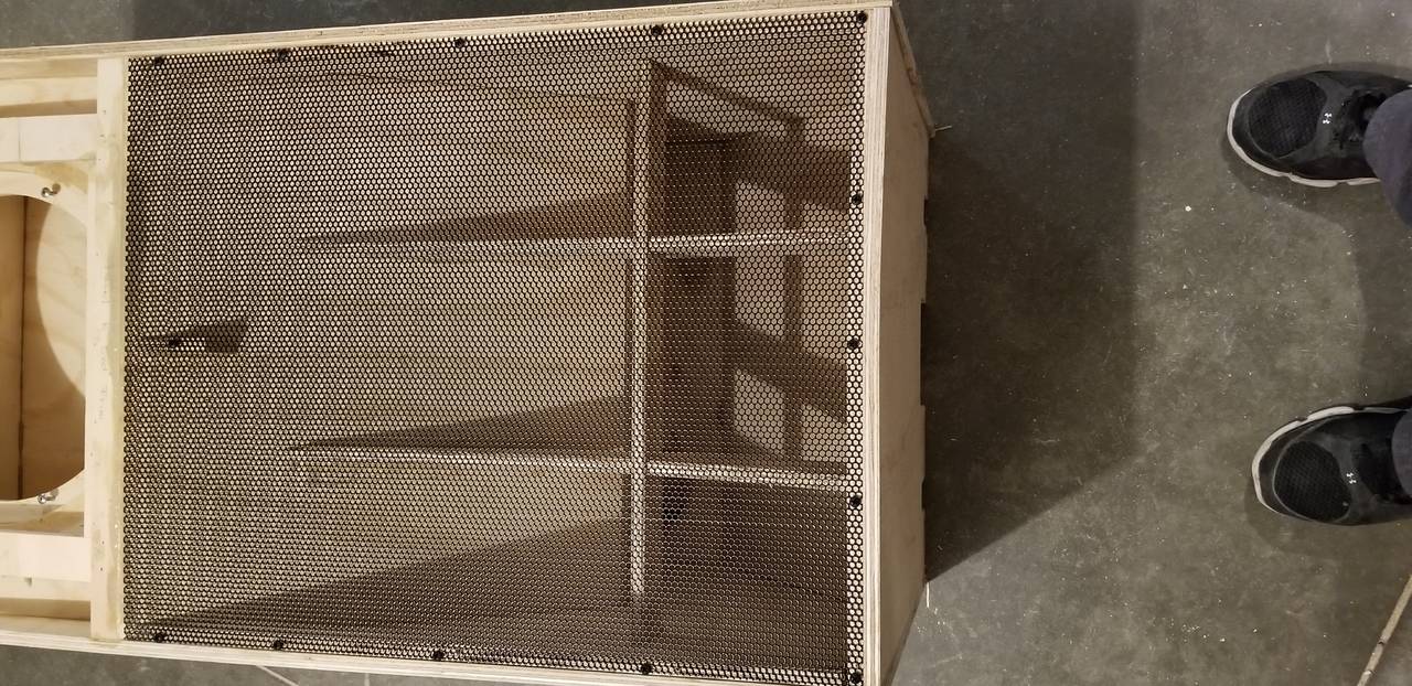

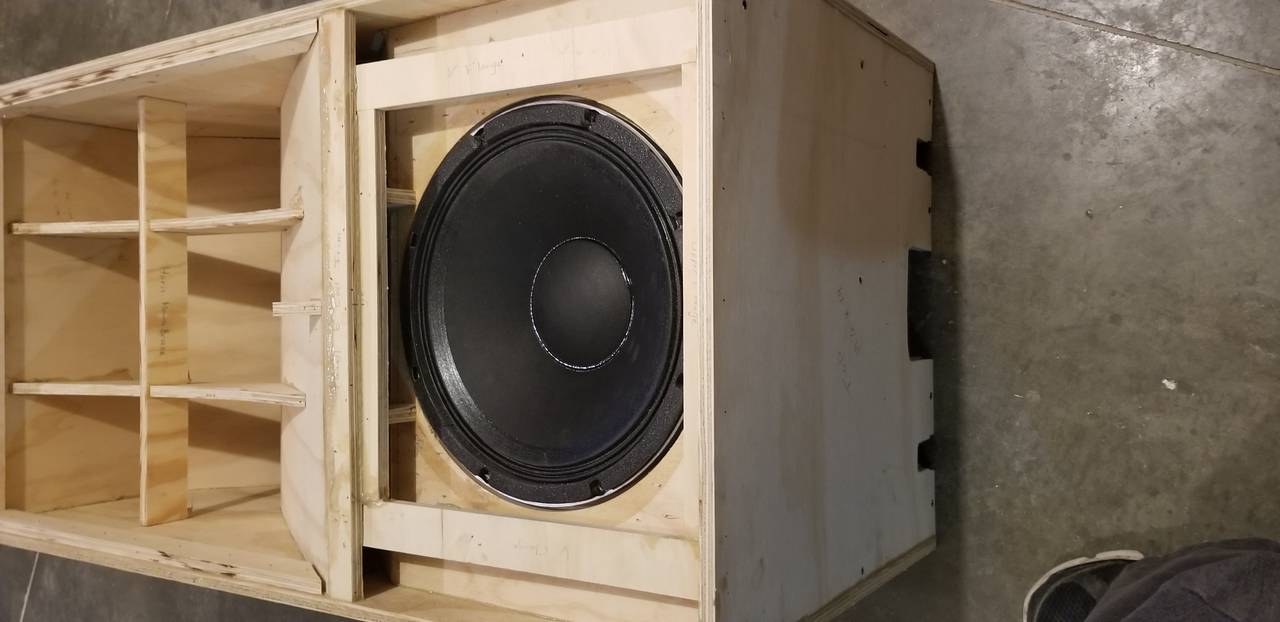

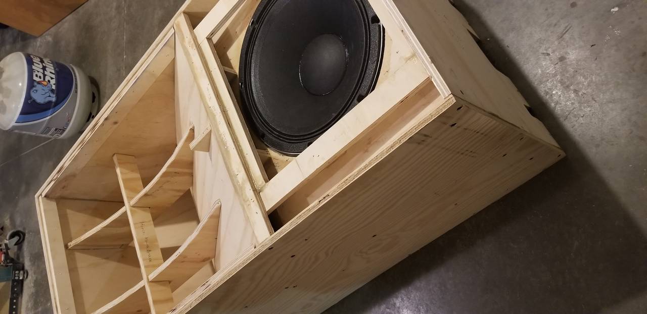

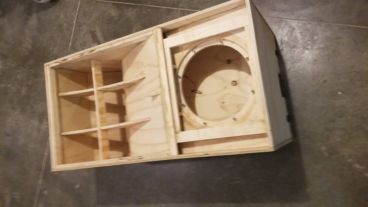

Made even more progress today. Got panels 9, 11, mouth braces, and grill mounts installed on the last cab. Trial fit the 3012LF, drilled mounting holes, and filled all the holes I could find with PL. All I have left is panel 7, driver covers and finish work.
I think I'm going to pick up a cheap HLV Sprayer for the Duratex. With three of them to cover I want to save some time. Also, I'm interested to see if the sprayer gives a more even coat. More to come...

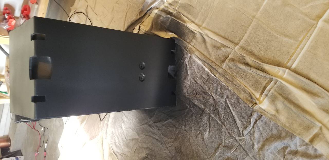

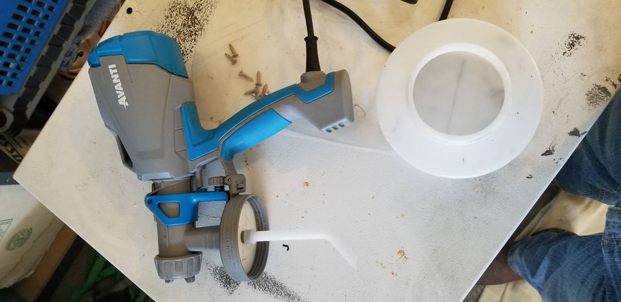

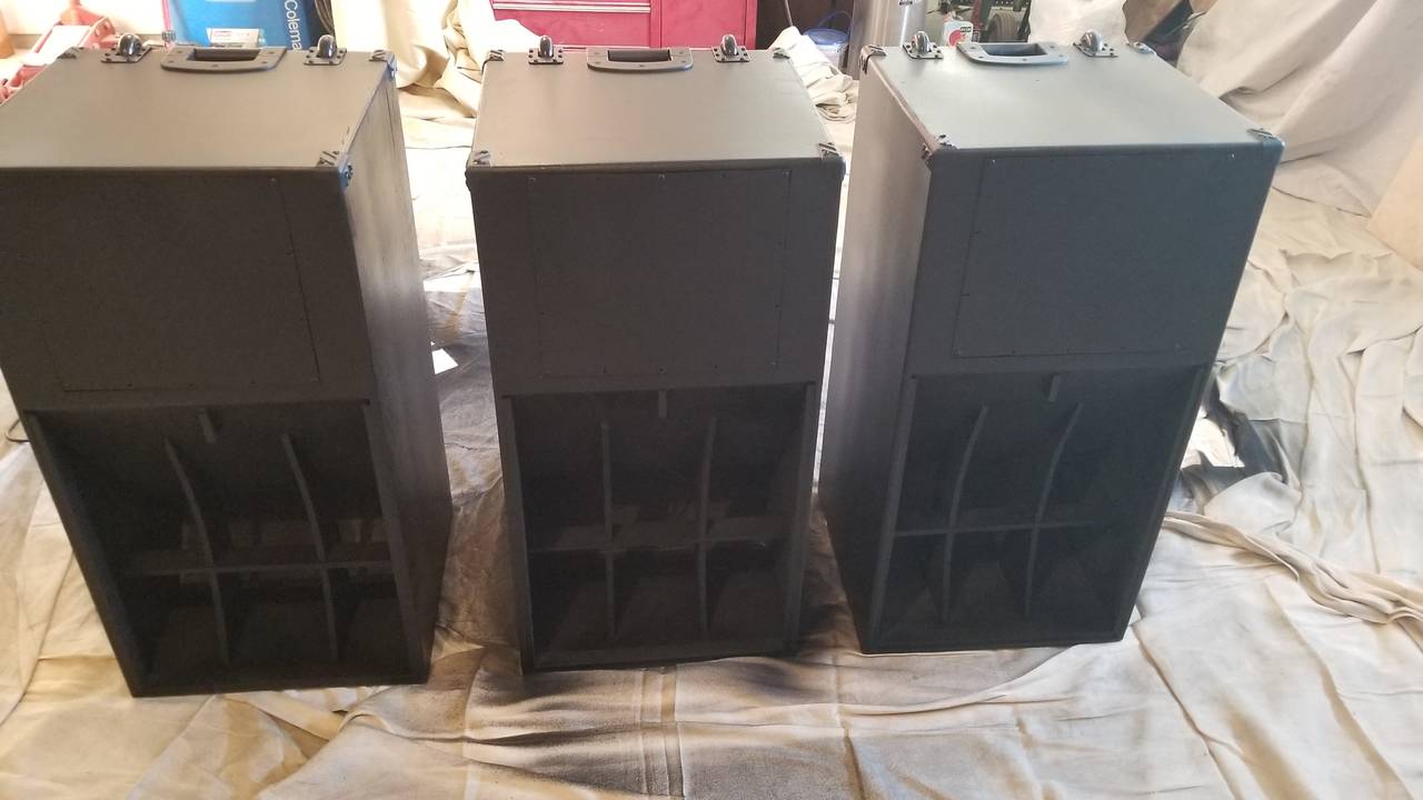

Finally put my new HVLP through the paces. The spray grade Duratex still had to be thinned a little but not a ton...somewhere between 5% and 10%. It definitely does not come ready to spray. In the end I'd do it again. But I'll make sure to roll one one thick coat to get that rough texture. Spraying it makes it much smoother that's for sure. Now just to purchase the three 3012LFs and another amp and I'm all set.
Posts: 29127
Re: Titan 39 Build
#60 Post by Bill Fitzmaurice »
I bet your gun is the reason why you had to thin the Duratex. The best gun to use is a hopper gun. Being designed to handle anything from popcorn texture ceiling paint to thinned drywall joint compound they handle Duratex with ease.
