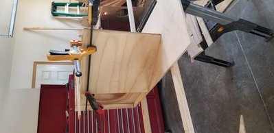

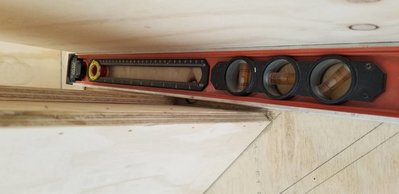

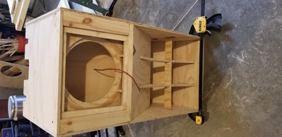

I devoted some time to figuring out what I did wrong and can't find it. Everything is square and dead on. It sure doesn't look that way in the picture. Some kind of optical illusion I guess...I don't know. Either way, panel 7 has me covered.
Re: Titan 39 Build
I think it's the light, or rather, the shadows that make it appear to be wrong. As long as all the panels are the same width, and, the cover flange braces measure the same from each "side" panel, you're okay.Bigcox4002001 wrote: ↑Wed Nov 20, 2019 6:47 am I devoted some time to figuring out what I did wrong and can't find it. Everything is square and dead on. It sure doesn't look that way in the picture. Some kind of optical illusion I guess...I don't know. Either way, panel 7 has me covered.

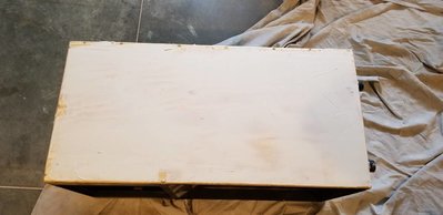

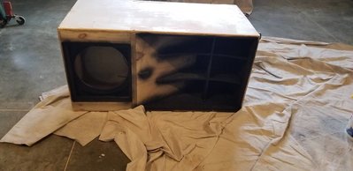

Made a little more progress today. Routed the edges, filled screw holes, searched the seams for leaks (with a 960 lumen flashlight), dry fitted the hardware, installed the grill mounts, filled the imperfections with drywall mud, and painted hard-to-reach areas with flat black spray paint. Should be ready for sanding and Duratex in 24 hours or so.

Add a coat or two of that flat black between the sanding and duratex.Bigcox4002001 wrote: ↑Tue Nov 26, 2019 9:00 pm Should be ready for sanding and Duratex in 24 hours or so.
Re: Titan 39 Build
Will do, Bruce. Thanks for the tip.

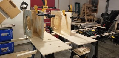

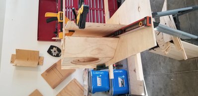

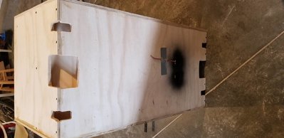

Made a little progress the last few days. I got the second box sanded and ready for paint/duratex. I forgot to take pictures though. Then I started building the last two. So far so good. This ply warps faster than I can install it so it's slow going. I'm only installing about 2 panels a day on each cab. Then I have to secure them with clamps, wedges, etc... to pull the warp out. Anyway, here are a few pics of the progress.
- Posts: 29056
Re: Titan 39 Build
When prototyping I never did more than two or three panels per day. I found if I started a session with the intent of doing more than that I had a tendency to rush, which led to mistakes.
Re: Titan 39 Build
I've experienced that as well. Two to three panels per day is resulting in a nice product so far. When I was building the first two T39s I'd spent 12-16 hours in the garage a day. And at certain points I'd rush to get through a problem spot, only to find something warped or not quite square later on. Now that I have a good understanding of this cab I can think more critically about each piece and determine what the end result will be.
Thanks for a sweet cab, Bill.
