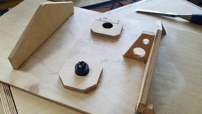

Handle backers...

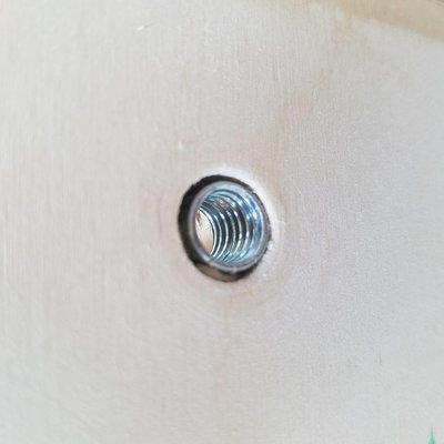

All 32 of those stupid bracket t-nuts are now glued in. Second guessing if I'll actually use them, but there in. Seems like I spent a lot of time on that one little item.

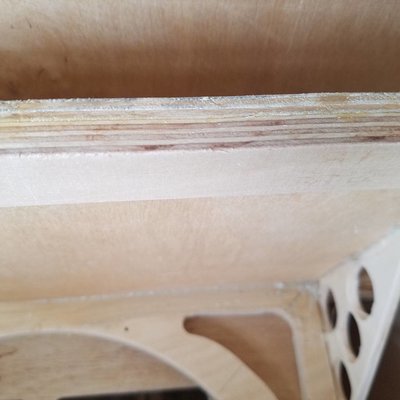

I have a bunch of 3/8" 7-ply baltic planks I rescued from shipping crates, so I laminated 1" strips around the rear of the cabinets. It will give some extra meat for when I round over the edges and also make the cabinet look a bit beefier. I plan to do the same on the front, although maybe with just 1/4" since it's already going to be tight to fit the tweeter arrays. We'll see. I did the same thing on the fronts of my t30s to make the 1/2" panels look more substantial. I like the cabinets to be light, but to look and sound HEAVY

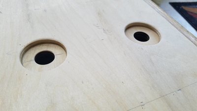

Got the backs cut out of 1/4" ply today, as well as the braces. Might swiss cheese the braces to knock out a little weight. I need to find my 2" hole saw to make the cutouts for the speakon jacks. Also got the flanges glued in on one cab. Tested my driver and it fits without having to do the half-moon cut.

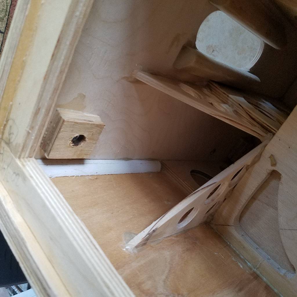

I'll pick up a stick of quarter round tomorrow to reinforce the inside of the edges from the sheath braces to the rear of the cab so I can round over with a 3"8 bit. Since I left the full sides on the braces the front part of the cab is already fully reinforced.

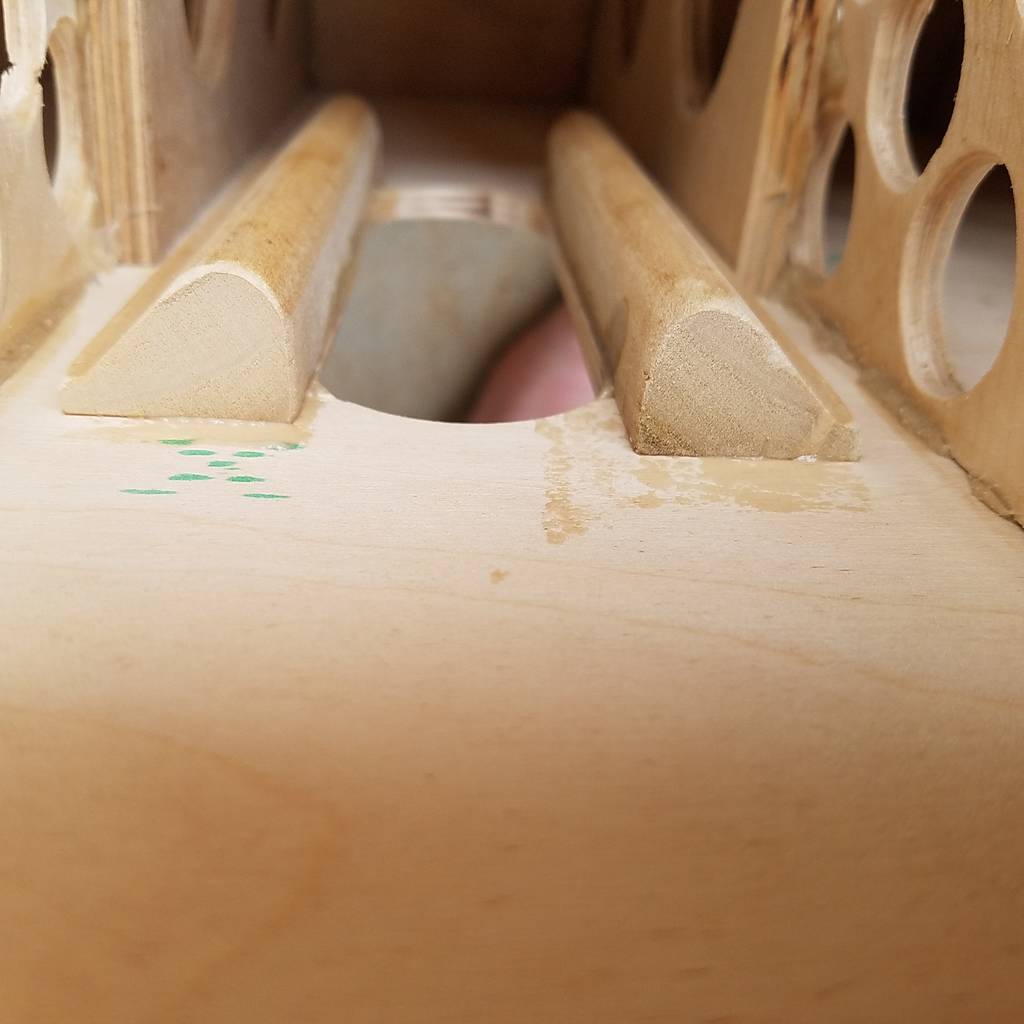

Quarter round reinforcement pl'd in place.

Re: Otop Jarray build x 4
Actually wasn't legit quarter round, but I didn't have time to stop by Menards today, so scrounged around the garage and found a stick of old half round moulding that I sliced down the middle. Whatever works...

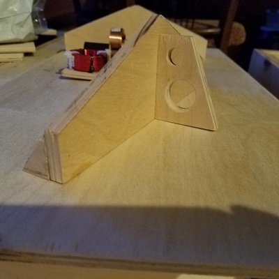

A little mod to the back braces that will support the x-overs. They are kind of heavy since I put hp and lp on one board and I was a little concerned about all that weight hanging off a thin plywood joint. These little scraps should keep everything nice and secure even if the cab gets dropped on its side.

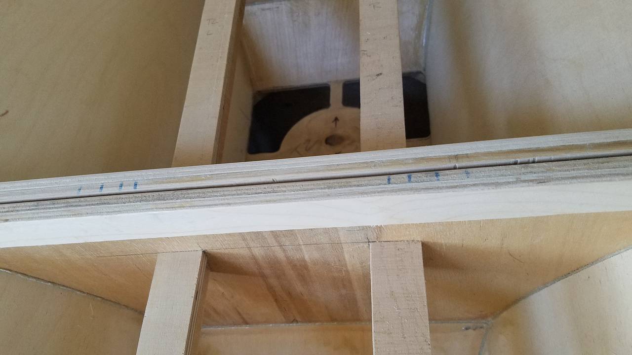

Strips added to the front of the straight array cabs. Looks better to my eye than the 1/4" edge. I can slip the arrays in with about 1/4" of clearance. Will need to experiment some with the melded cabs since the tweets take up more space, plus they need to be turned sideways a little to fit the drivers between the mounts.

Got the strips fitted and glued to the front of the two melded cabs - there's just enough room to finesse the melded arrays in and onto the mounts. Drilled the pilot holes for the speakon jacks. That's going to be it for the weekend. Hopefully will have some time one or two evenings this week to keep moving forward. Feels like the end is finally is sight.
