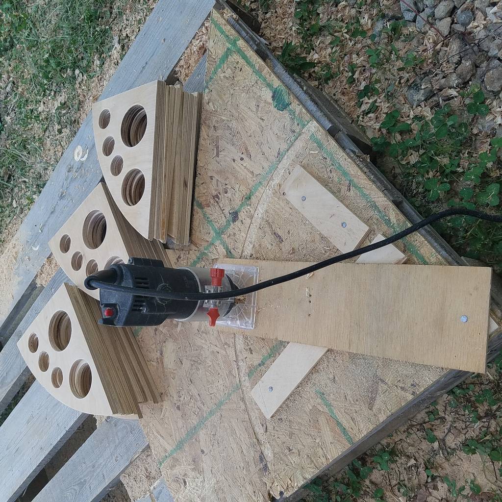

Just finished cutting out the braces. I actually used 7-ply 3/8" baltic birch for them, since I have a ton of that rescued from EU pallet box shippers. They are pieces about 8x25 or 8x41. The shipper box covers were 5-ply 1/4" so I should be able to get most of the tops/bottoms/sides/baffles cut from them. Free plywood is such a help!
I made a cheesy little jig to cut out the braces. First cut the triangles, rough cut the rounded edge, and then trimmed with the router. Worked pretty smooth. Next I'll figure out some hole pattern to swiss cheese them and make them a little lighter. Need to go search for my hole saws...

Better to make a cheesy jig that works, then to try and free hand everything. 10 minutes to make a jig, probably a couple of hours saved on the cuts and they are all the same.
Just the way it should be.

That's exactly how I make my jigs, brad nail/screw scrap pieces together, most times right to the table saw sled.

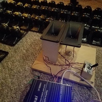

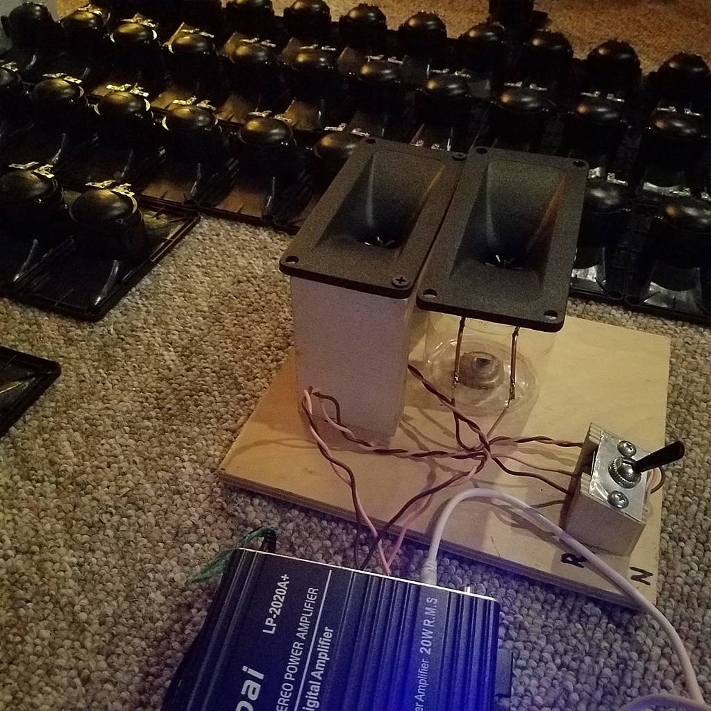

Gross rainy day, so am testing piezos. Made a little tester similar to one I saw a picture of here on the forum. Have checked all for polarity, only had one reverse and a few duds. Listening to sine sweeps now. 1500-15k over 4sec. Not exactly sure what i should notice to indicate a bad one. I've listened to a handful and they all sound about the same. Any tips? Thanks

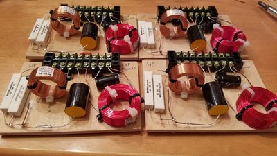

Built me a little family of xovers tonite. Slow...but progress.

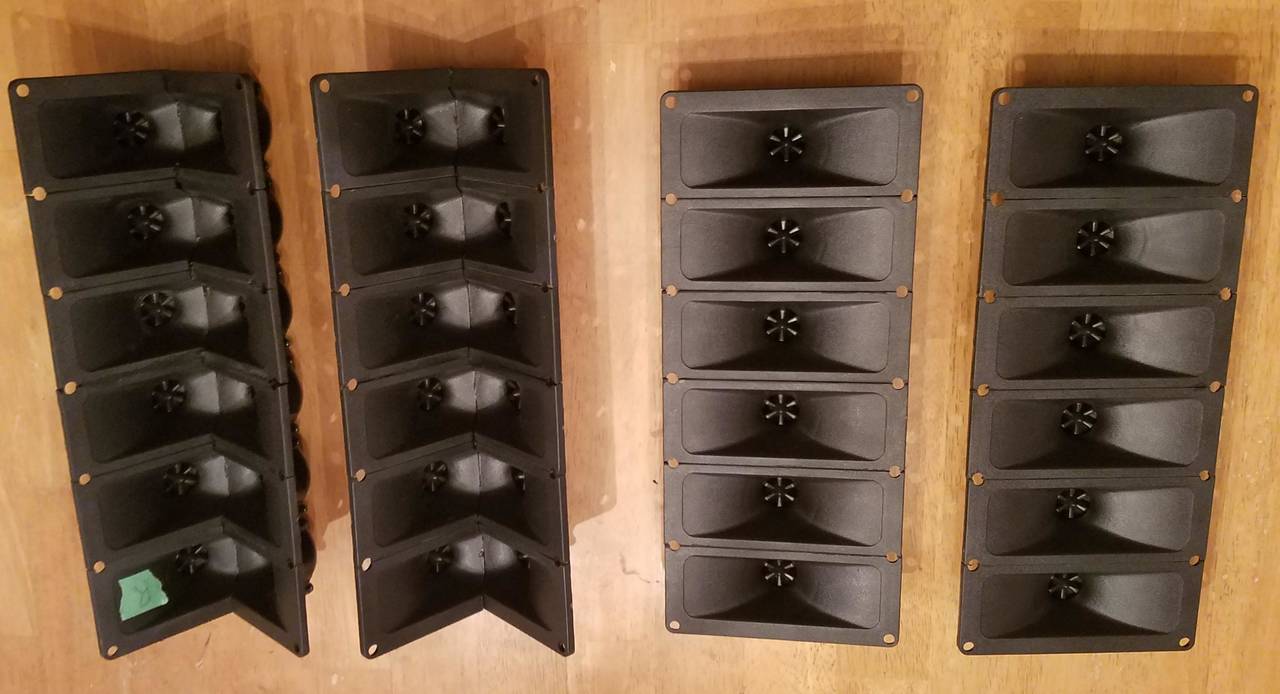

Put the abrasive blade on the table saw and cut piezos down to size vertically. The jig worked pretty well. I tried gluing up the two straight arrays but it didn't go as expected. I used testors model cement, made for polystyrene and abs, and thought it would weld the plastic together quickly (like I remember when building airplanes and cars as a kid). Nope. Barely tacky. I put some PVC cement on the back side and they are kind of stuck together but certainly not melded into a stiff structure like I expected. I'll let them cure overnight as see how they look tomorrow. Got a bunch of cutoffs stewing in the PVC cement, so perhaps a thick, gooey application on the back side will improve the strength.

Model airplane glue isn't the same as when we were kids, probably to discourage sniffing it. The way to get the structure stiff is to apply a few coats of PVC cement to the back of the array over the course of a day or so.

Thanks Bill. It seemed stronger this morning, so I'll put some more thickened PVC cement on it tonight.

Glopping some thickened black cement on the back joints of the straight arrays has rendered them much stiffer. I glued up 8 3-packs of piezos for the melded arrays last night. I'll do the same with some more cement to get them more rigid, then make the 45 degree cuts. Only 3 fit in my jig, so that's why groups of 3.

Got my piezo arrays glued up. The melded didn't match up perfectly. One was better than the other, but was able to fill in the gaps with cut-off thickened cement pretty well. It will all be invisible when the diffuser rods get glued on. I also took a bunch of the little strips of ABS scrap and glued them on the backside to connect all of the tweeters together. That really added a lot of stiffness to the arrays. Ran a quick sine sweep across all the elements to make sure none were damaged during the cutting process and they all still worked, so I'll get them soldered up tonight and they'll be ready to go when I get around to assembling the boxes...maybe this weekend?
