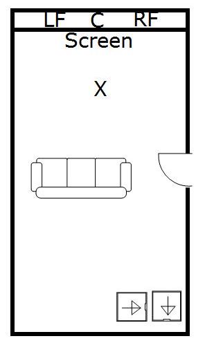

Thanks Bill, I was hoping corners would work but I'll try some other options. Do you think a sub crawl would work with this pair? And to do a sub crawl, which direction would I fire the horns (from the seating position) during the sub crawl?

#48 Post by ecut1 »
Ok, cool. I'll place them side by side where the couch will be and try to find the best spot for them. Hopefully it's not where the door to the room is. Lol.
ecut1
Posts: 148
Joined: Fri Oct 18, 2013 7:48 am
Re: Under Garage Home Theater Build
#49 Post by ecut1 »
Well, my son and I spent a couple hours last night finding the best spot for the table tubas. They ended up in the right rear corner of the room side by side. There is one dead spot in the middle of the room between the couch and the screen. Pretty much everywhere else in the room is pretty nice. I think the manufacturer of the projector screen I bought designed it to rattle. :? Also, the exterior door we installed slaps the weatherstripping when it vibrates and makes a pretty loud rattling sound. Lots of work to do there! When I stand on the other side of the theater I can feel the sheet rock slightly vibrating. So from the inside out you have... 5/8 sheetrock, 2x4 wall insulated with fiberglass, one inch gap, 8 inch poured concrete foundation, one inch gap, 2x4 wall insulated with fiberglass, 1/2 inch sheetrock (which is vibrating). So I give up on sound isolation! At least now things don't fall off shelves on the main floor above the theater room.
