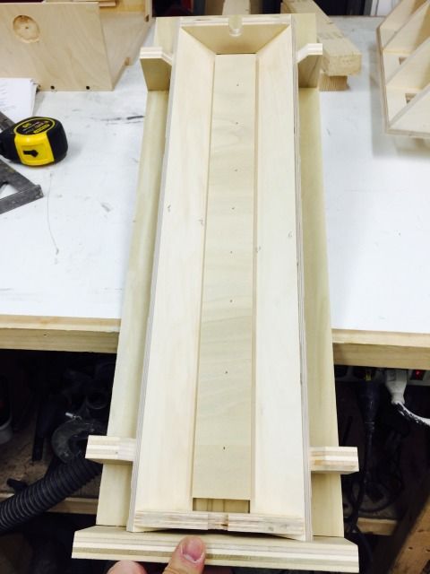

So I didnt get much done today.. I did however make this assembly jig for the compression driver horn module faces to help make these consistent in size and reduce sanding time. This spreads them apart right at the perfect measurement to match the horn and hold the pieces while fastening them together.. Such a simple jig to make even if you are building just 2 cabs..

You guys know me to well lol.. Ive since re-cut these parts with some modification to expedite these.. I basically dado all the mating surfaces and increased the size of the cleats to help hold the little pieces straight and square while tacking together with brad nailer. Now I can get the brad nails plenty far enough out the way when it comes time to mill out the pocket holes for the module mounts.
Do the flat packs that you are making for Leland include double the module braces and the improvements noted here?
