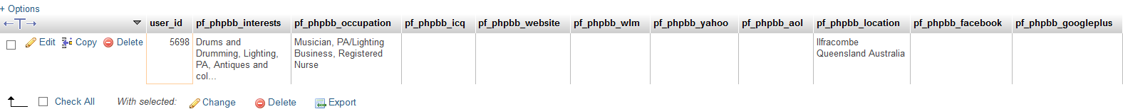

I've had a look at the old database and I can't see a website set:
Re: New Site
Correct Chris!Chris_Allen wrote:I've had a look at the old database and I can't see a website set:
Website was not previously set

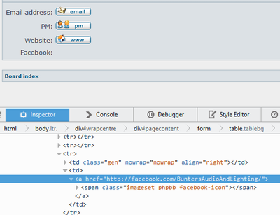

OK, so the link is actually there:
However, the image size is 0x0 pixels. So the image is either missing or incorrectly referenced, either way, I'll have to do some digging to fully trace it.

The theme stylesheet didn't even have a reference, so I've copying in the reference from the www image until I can draw a facebook one.
