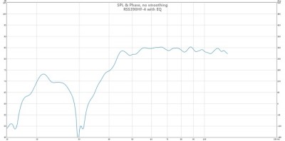

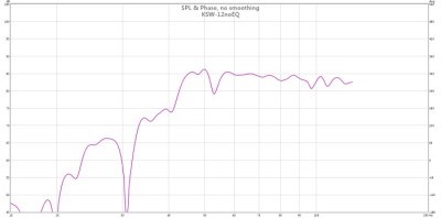

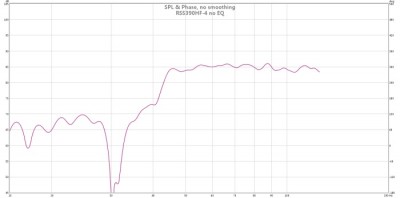

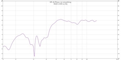

So here are my graphs, hopefully i've captured enough and sensibly. Although it sounds like location, location, location! Hopefully i can get my legs on soon and move it to a wall and try again.
So for a reality check, my Klipsch KSW-12, 12" ported sub, 440w(peak) bash amp. Well over 12 years old and it has served me well.

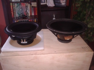

My 'test' driver, and old RS 18" sub. I figured someone would pick it out in the pictures by size alone. I just had to try, my teenage sons really wanted to blow it and tear the cone. Actually it performed OK until I could get my beloved Dayton in there. Definitely not the low end of the Dayton, but frankly it worked decent, just can't crank it to 11.
Finally the Dayton RSS390HF-4 , same 30Hz suckout without EQ first. Again the Dayton RSS390HF-4 , with EQ got more 20-25Hz but suprisingly the suckout? Can't figure that since I measured same dB at 32Hz.

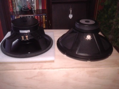

Here is a side by side of my 18 on it's way out and the 15 about to go in. Amazing motor structure by comparison. Then again it was a nice sub 20 years ago... Anyway it had to go, had to get the 15 installed.

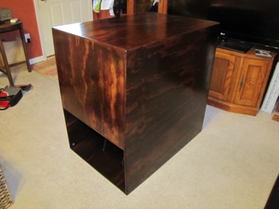

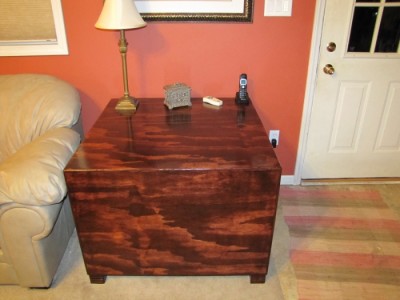

New THT build in Wisconsin
I finally was able to tear it out of the living room to stain and poly. We took advantage of a warm fall weekend.
Pre-stain treatment on the outside, which I regret not doing in the mouth, which stained near black.
Bombay Red Mahogany IIRC, and three coats of Polycrylic water based clear gloss.

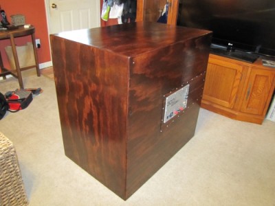

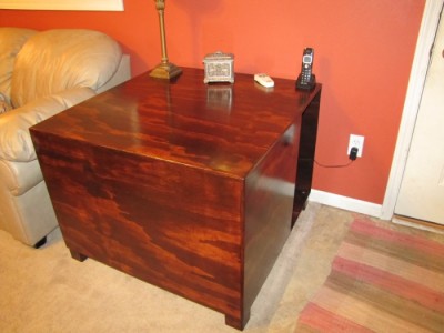

And a view in it's intended location, probably too far from the corner for any loading (right side of door is adjoining wall).
Hopefully I can find time this weekend to re-tune it, I feel like I lost a ton of output, but output is much smoother now..
I did do 4 coats on the top, hopefully beverages won't damage it.
And my improvised feet, made with 3x3 squares of 3/4" scrap plywood laminated, sanded, stained and poly'd to match.
The WAF went way up after she saw this, got pretty tired of the 'white elephant' in the corner before.

That far away from the wall, and forget about corner loading, you'll need to start to worry about cancellations, which is apparently at 30hz at your listening position. When I used to play around with moving my subs around in home, I finally decided that the corner was the most preferable place for it, so now I keep it in a corner and just eq my listening position.
And speaking about Eq, what's with the -20db from <45hz? There's a plenty of content even in music down to 30hz, and movies need that all the way down to 20hz. If your system can do flat to 20hz, I would definitely use that potential and eq the whole thing flat.

No doubt, with a cab like that!howiez wrote: The WAF went way up after she saw this, got pretty tired of the 'white elephant' in the corner before.

Bill how do I correct a boundary cancellation? Is that due to me being too close or to far from the corner, or is it a room dimension thing? I that graph, my first positoin, I was about 2 feet from each wall parallel to one, pointing at the other. I had moved it anywhere between 2 and 3 feet from mouth to wall, and it all seemed the same to me. So a wavelength for 30Hz is about 37.5 feet, and a 1/4 wavelength then is 9.375 feet. Does that mean a wall, probably the opposite sidewall is about 10 feet away?
*EDIT* OK, you really have me thinking now. I measured and my THT was 13 feet away from the opposite side wall. My LR is 19'-6" x 17' with a vaulted ceiling 8' at the walls and 10ft in the peak. That is my ~9ft cancellation? I don't think my wife will let me tear the roof off with winter coming. What can I do? Please say build a second THT! (I have everything set aside except for two more sheets of plywood)
And I have another theory, question. My LR is rectangular, jutting off the rest of the house. The basement underneath is all solid concrete, and the THT is near an outside corner. Can I be getting reinforcement from the basement corner as well? The reason I ask is in the new position, i'm only 4feet from a corner, but it is midway along the long side of the basement. My lows are missing more than i expected there. I ran my same EQ drill to a new preset on the Berry, 20 and 25Hz are almost inaudible, and anything above seems overly loud. I know we hear more sensitively moving up the scale, but I don't remember the other position being like that. It was all BIG!

A null occurs when the reflection and the original wave arrive at the listening position 180 degrees out of phase. The cure is to move either the sub or the listening position, if not both. You can fill a null to some extent using EQ, but filling a null at one listening location results in creating a response peak in another. Rather than try to just fill in a null with EQ take the EQ down in the other frequencies as well to level response. Accept the fact that with only one sub the size of the listening position where you can get relatively flat response will be fairly small. Even response throughout the entire room requires at least two subs.howiez wrote: Bill how do I correct a boundary cancellation?
Re: New THT build in Wisconsin
Thanks Bill, now I understand better. I was thinking it was 'everywhere' because the sub might be 1/4 wavelength of 30Hz away from the ceiling. So really it's my LP distance to a boundary and sub being equal. I've been measuring in one LP of two symmetrically placed recliners. I'll move my mic to the other and see what I get. Now maybe I can figure out how to EQ that bottom end up then.
Should I move my THT to the middle of the room and EQ with a SPL meter in/near the mouth to get flat first and then tune to taste in final resting place? I guess i'm wanting to get that 20Hz up near the rest of the curve. As SeisTres mentioned, I'm rolling off from 45Hz down, and it sounds like I could EQ that up to flatter?
Time to look at some more REW tutorials...thanks again everyone!
