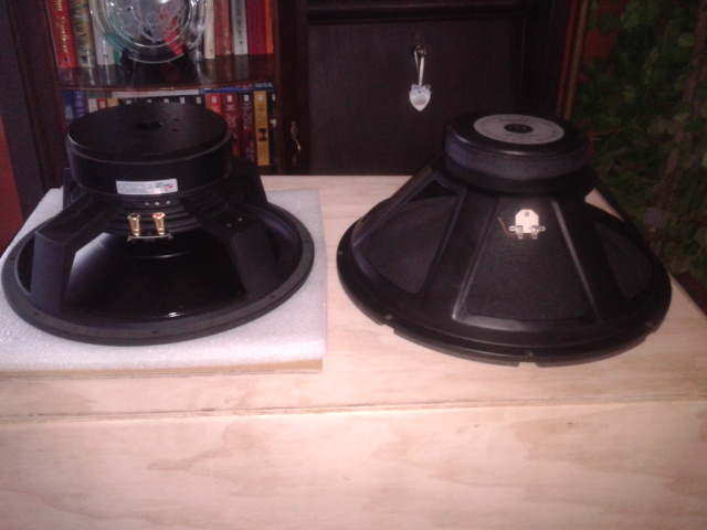

Here is a side by side of my 18 on it's way out and the 15 about to go in. Amazing motor structure by comparison. Then again it was a nice sub 20 years ago... Anyway it had to go, had to get the 15 installed.
