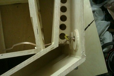

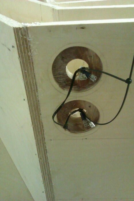

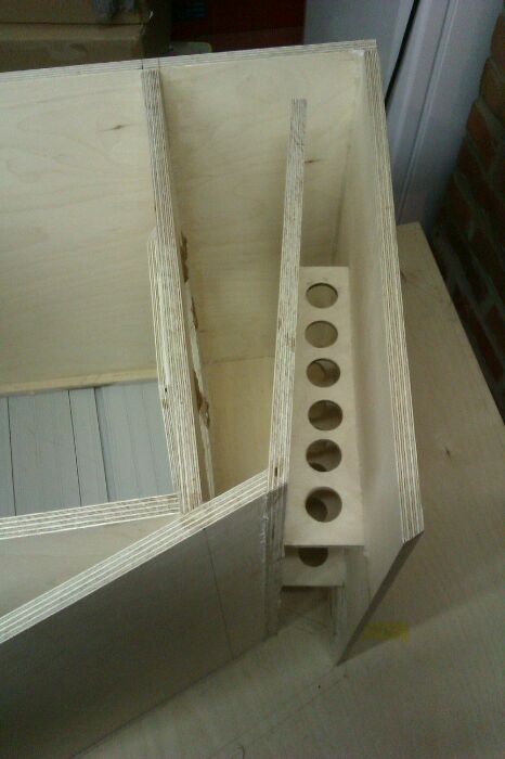

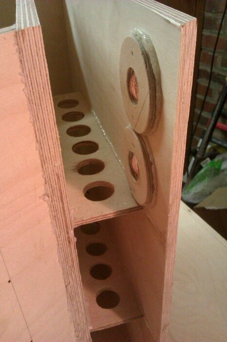

Not sure the effort of the holes is worth it in 6mm ply braces, but theyre in there now.

Cabs are looking great and the braces look real solid. Next time I build subs, I will only cut the windows out of the large braces. Of course I'll cut holes in any braces that the plans say NEED holes, but other than that, it's not worth the trouble IMO. In my T48 build thread I weighed the braces before and after cutting. IIRC I saved about 3 pounds. Totally not worth the half a day it took to hollow them all out, not to mention all the sawdust I had to clean up.

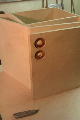

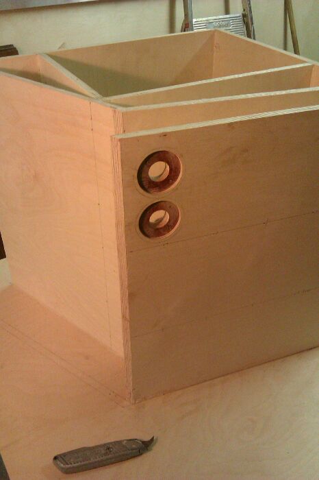

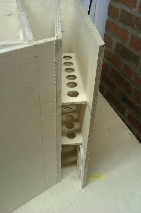

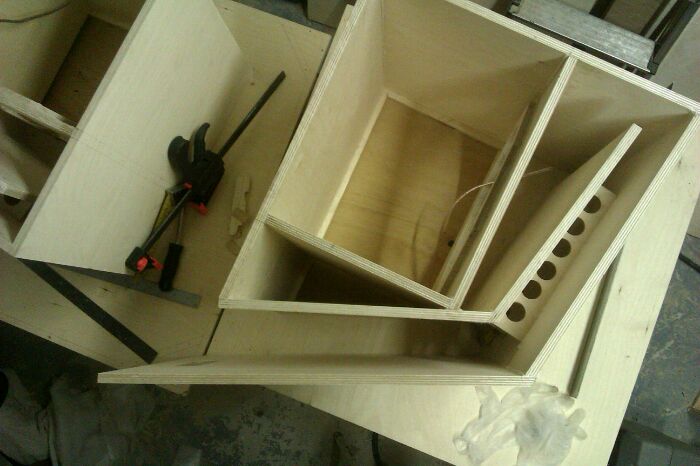

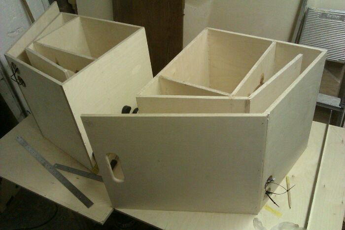

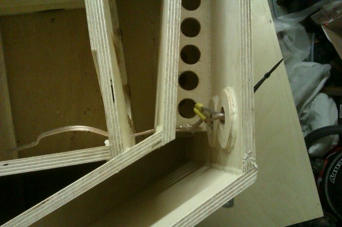

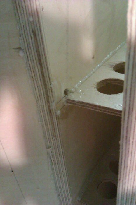

Panel 7 installed last night: Cut mitre on bottom edge; routed handle using an oversize jig template (made using holesaw again) - Sheesh, how many router set-ups are required! 14 handle pockets to route and roundover in total, for 2 cabs. Gonna try and do as many panel handle pockets as possible next time, to reduce total set-up times.
Panel 7 braces to do.
The glue has been scraped off in the photos shown, to ease clean up, but there was squeeze out.

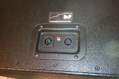

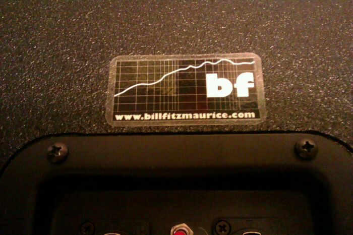

Also, just wanted to show BF name plate I made and glued on back of the J12L's - i agonized over where it could be stuck on the front but figured it wouldnt work for my finishing detail/style. I made 4 of these half size laminated tags, before I'd committed to building the subs, which is nice. Am gonna stick the tag above the jack sockets again on the subs.

Laminated name plates - somewhat smaller than the ones available in aluminium.
