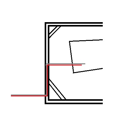

Quick tip for anyone interested, what I did to run wiring...
As you can tell from the pics, I placed the speakon terminals at the bottom rear of the cab which we all know presents some cosmetic challenges. Thought I'de share how I managed to get the hookup wire passed through without exposing them at back of the cabinet. I don't have a clear photo but here is a ruff scketch...
Basically I just cut a 1/2" deep groove right in to the profile edge of the back panel and run that up about 8" where it re-emerges out of site. I then run that along the back brace right into the speaker chamber to keep the horn path as clean as possible.

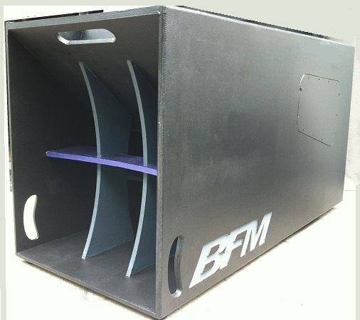

Final Color Scheme...

Looking very good there Daniel! :clap:
But i cant help but thinking the handles on the bottom should be the other way around.
DanielNY
Posts: 536
Joined: Sun Sep 20, 2009 11:45 am
Location: New York City
Re: T45 Coming soon!!!
#59 Post by DanielNY »
Bas Gooiker wrote:Looking very good there Daniel! :clap:
I thought about the same thing but after hauling my cabs enough times, I went with what I thought was the more comfy position on my hands from multiples angles. I also wanted to minimize the weak point where there is only 1" of space between the edge and the opening. By flipping in the other direction I would have ended up with a weaker handle or edge.

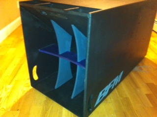

Had a chance this past weekend to give the T45 a workout. In all honesty, it was probably overkill for an end of summer BBQ in a 20x30 foot patio area of which 15x10 was partially enclosed. This is where I corner loaded the T45 and a one of my Pro SLA's, the other out on the open side of the patio for a group of about 40 ppl.
The SLA's performed as expected and the T45 while not as sensitive as the Titans, provided a warm and smoother response in my opinion. A good choice for wanting a good "FEEL" for R&B, Top 40, and Hip Hop at modest levels. Really satisfied with the form factor and size of this design and will be making the T45 my new "GO TO" sub. Just need to build 3 more....
Oh, and wanted to mention the super glue trick on the wood corners and edges works quite well. I am trying to move away from the metal corners and this seems to be an ok alternative. Guys should give it a try!
